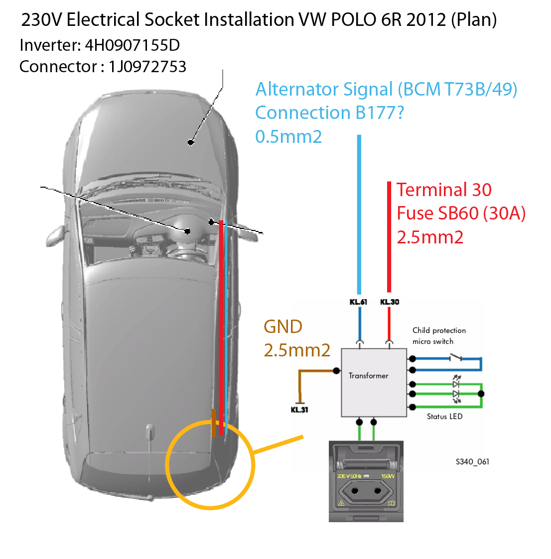

Hi everybody
my next small retrofit project: 230v inverter power socket. I've been studying many diagrams from different vehicles for this and i would like to share my installation plan and getting some feedbacks from expert here whether im on the right direction or not,
Here's the plan: I understand the signal cable (Terminal 61) is coming from connection B177 which is alternator signal. I know i can also use Terminal 15 for this, but using B177 would means the inverter will only works when engine is running, not just ignition ON right? Do you think its possible if i just tap the B177 from BCM T73b/49?
I'm planning to use the permanent power(terminal 30) from SB60 (which was prepared during my BCM Max installation by ciclo. As the fuse 60 is coming from fuse 49 (30A), is that ok if i use this SB60 with 30A?
Is there any grounding point in the right rear (c pillars) for the ground wire? so i can avoid running the ground wire all the way to the front again.

NO. The +30 signal-wire that reaches the SB60a fuse is 1.5mm2. It's not enough.
You must obligatorily install a new 4.0/6.0 mm2 wire from the battery --> fuse/s --> 2.5mm2 wire -->inverter. (and new/"better" battery?)

Wow. I’m so thankful Ciclo. Exactly what I’m worrying and you clear that out. Hurm. I know there’s 2 slots available on the battery to run a new wire. But I’m sure it’s a headache to me to run the wire from the battery into the Fusebox. I will try to look for the best route.ciclo wrote:NO. The +30 signal-wire that reaches the SB60a fuse is 1.5mm2. It's not enough.
I'm planning a similar installation, but not to install an inverter. (It's a secret)

There is an earthing point on the left C pillar, and there is one on the spare wheel hole (battery GND connector for batteries in the boot, Polo GTI, Polo WRC).
Not sure whether you guys in the far East have it as well.

Ok noted iichel. Thanks. I hope there’s one. Because I had never open any of the side behind. My model with front battery, so there’s nothing under the spare wheel area.iichel wrote:There is an earthing point on the left C pillar, and there is one on the spare wheel hole (battery GND connector for batteries in the boot, Polo GTI, Polo WRC).

https://www.ebay.com/itm/Audi-VW-Skoda- ... 2749.l2649benzinkopf wrote: Tue May 08, 2018 8:49 amWow. I’m so thankful Ciclo. Exactly what I’m worrying and you clear that out. Hurm. I know there’s 2 slots available on the battery to run a new wire. But I’m sure it’s a headache to me to run the wire from the battery into the Fusebox. I will try to look for the best route.ciclo wrote:NO. The +30 signal-wire that reaches the SB60a fuse is 1.5mm2. It's not enough.
The original harnesses run below the Battery.

I can’t see any grounding point here on the right rear end and also I’ve no idea where and how to mount the inverter module. Seems like no space at all. Hurm.
And interestingly the PDC module is on the right as well which I always thot it’s on the left.

Should be in the orange square, see Polo GTI as reference

Erm. I’m a bit confuse. Do you suggest I follow the polo GTI setup? Because mine not Polo GTI and the battery is at the front. So there’s no existing grounding point there or should I make one?iichel wrote:Should be in the orange square, see Polo GTI as reference
