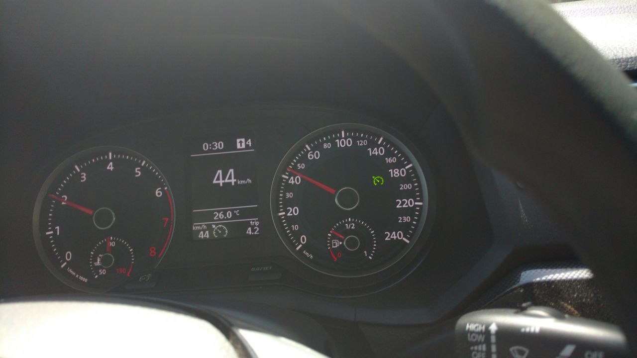

BARBUDO
Posts: 11
Joined: Mon Jan 29, 2018 11:15 pm
Drives: Saveiro
Location: Mendoza
Post by BARBUDO »
it works like a charm !!

Please see if the wire in the ECU is fitted correctly (deep enough) and at the correct position.
Dandi
Posts: 3
Joined: Mon Nov 04, 2019 11:26 am
Drives: 6R GTI 1.4
Location: Italia
Post by Dandi »
iichel wrote: Mon Nov 04, 2019 2:50 pm Please see if the wire in the ECU is fitted correctly (deep enough) and at the correct position.
I will check it but I fitted it on pin 45 of connector T94. I removed the dummy from that pin and fitted the wire till it clicked inside the connector. It should be seated properly then.
Posts: 8837
Commonly the one that gives more problems is the terminal T94/45.
It is necessary to remove the terminal locking mechanism (pink) from the connector. Did you do this before inserting the terminal?
Example:
Dandi
Posts: 3
Drives: 6R GTI 1.4
Location: Italia
Post by Dandi »
That's definitely the problem, the cruise control wire doesn't fit all the way to the connector. But even with the purple part removed I can't push the wire deep enough.
