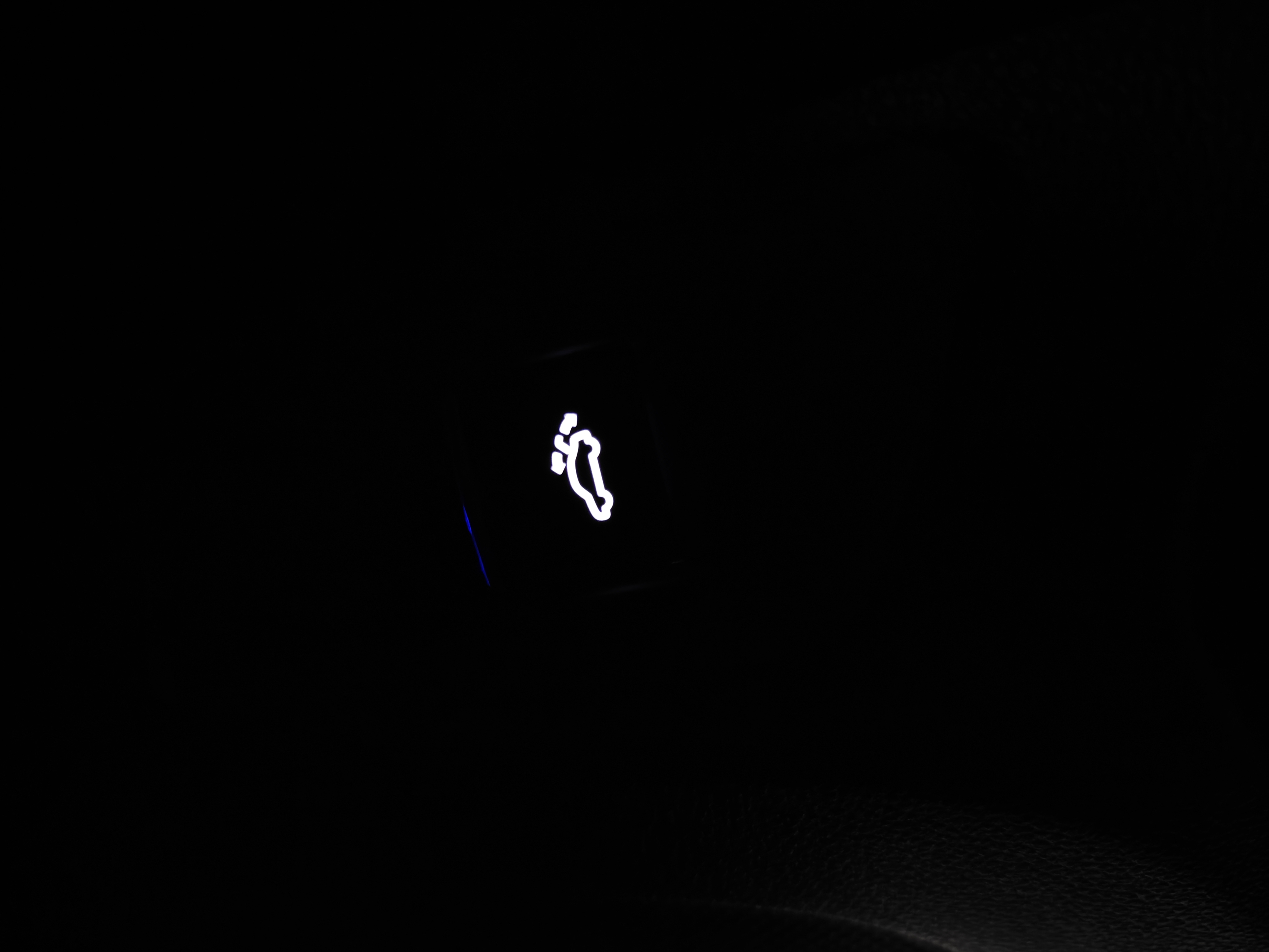

Another tiny upgrade: New switch for electric tail in driver door.
Even though just for asthetic purposes, the switch now accurately describes it's function.
This switch comes from VW Phideon for chinese market. PN: 3ED 959 835.
Stock vs new
Edit: Corrected the new tail switch button part number.
