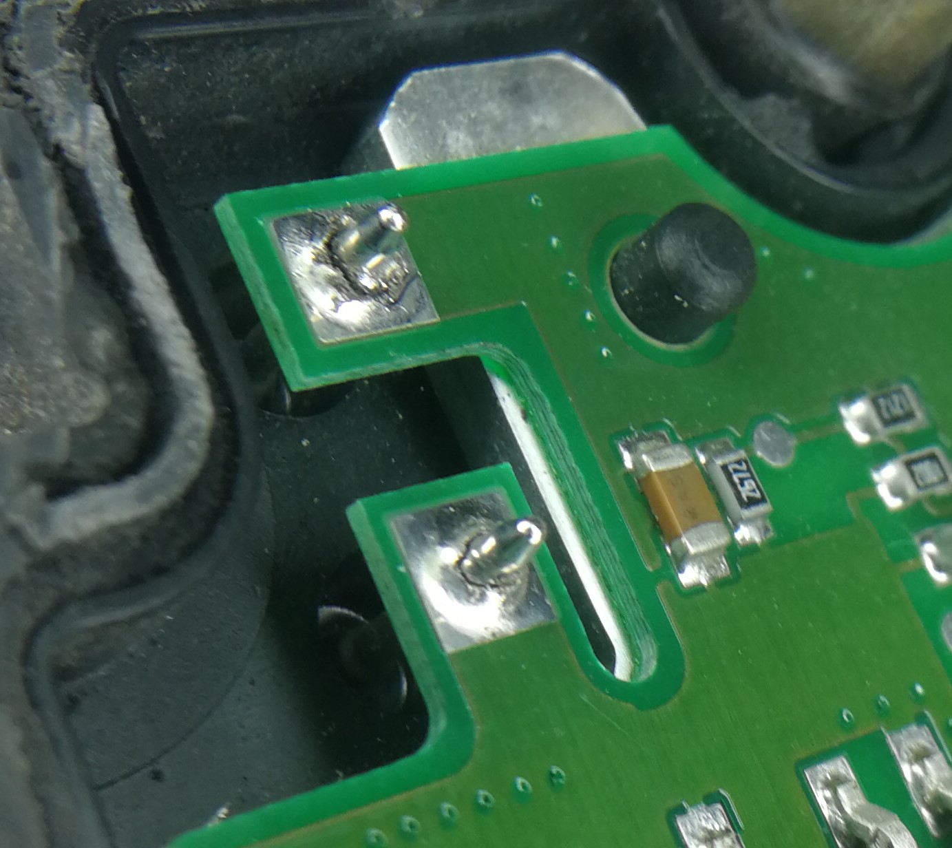

Just wanted to express my gratitude to @alexperkins and everyone else who contributed to this thread.
I successfully fixed the issue on my 2001 Polo 6N2 with the same procedure as the one mentioned in the OP post.
Here is the picture of bad solder joint resulting in "Signal out of specification" error code:
http://prntscr.com/omzpo5

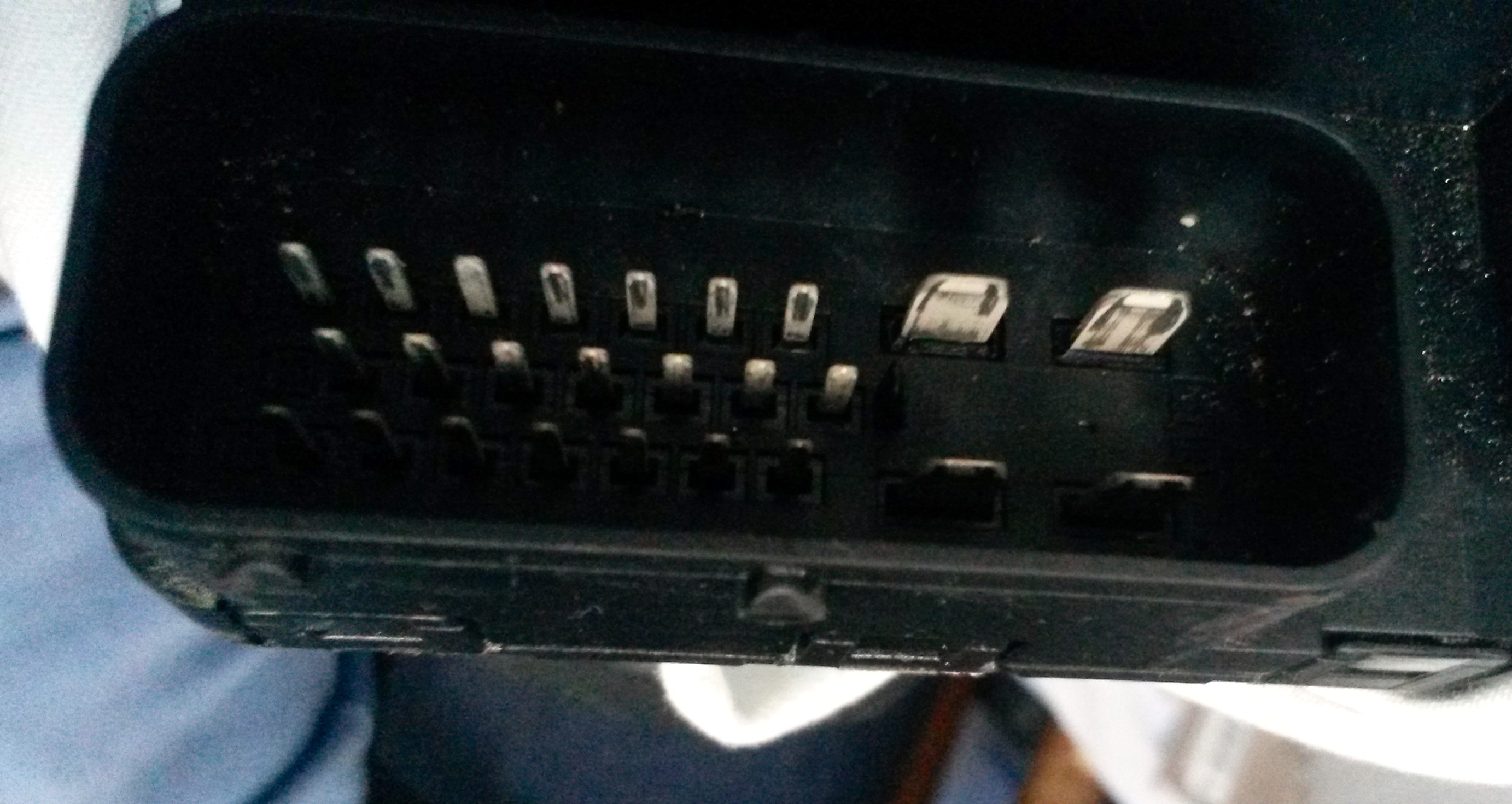

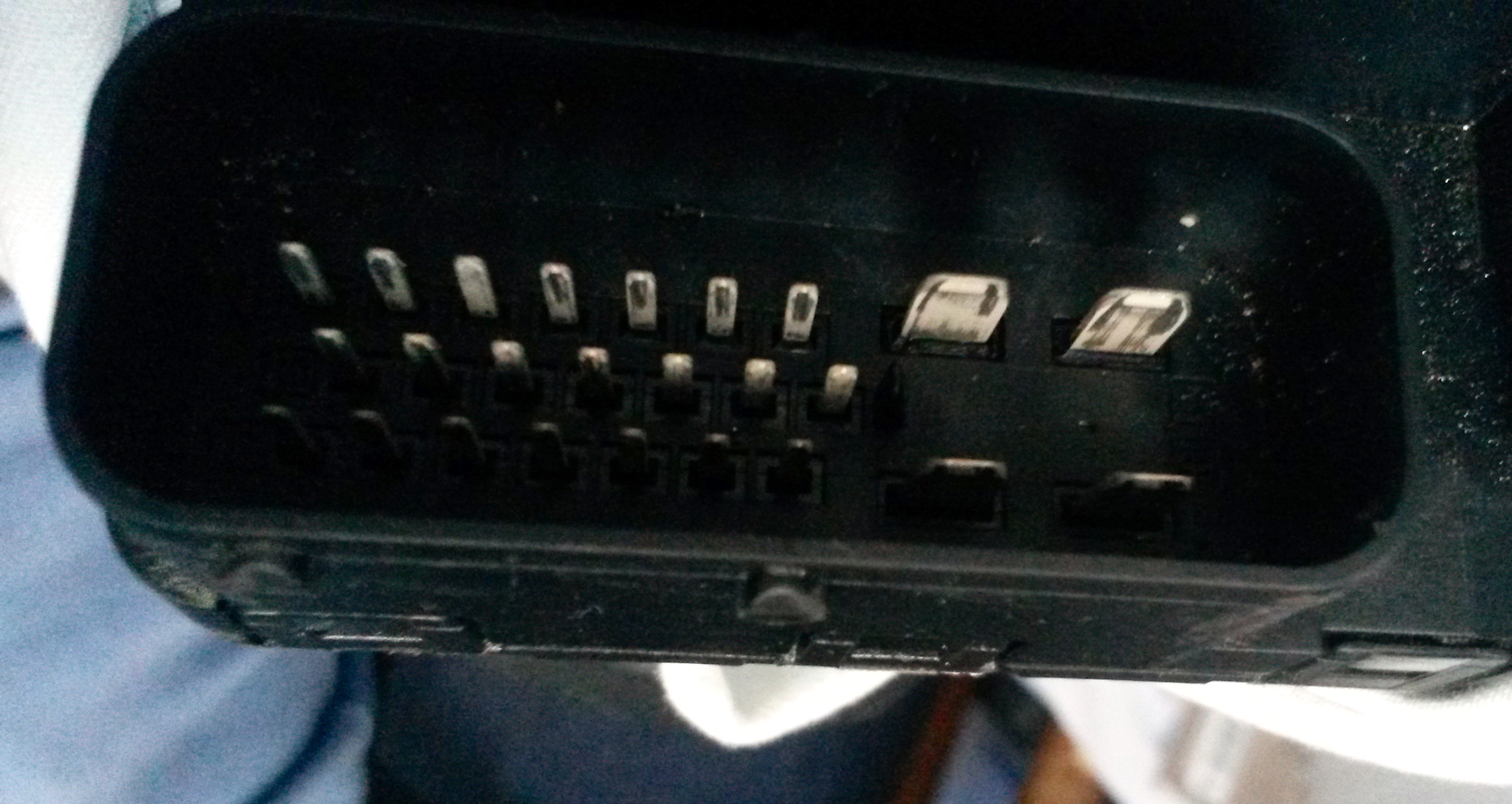

Got your reply ok now and a PM sent. Old unit is split and wondering if one of the multipins in the bigger plug is causing a problem as the third one in from the top left shows no signs of scratching caused by being plugged into the female receptor. If thats not making a contact could that possibly be where the problem lies?
download/file.php?mode=view&id=3382

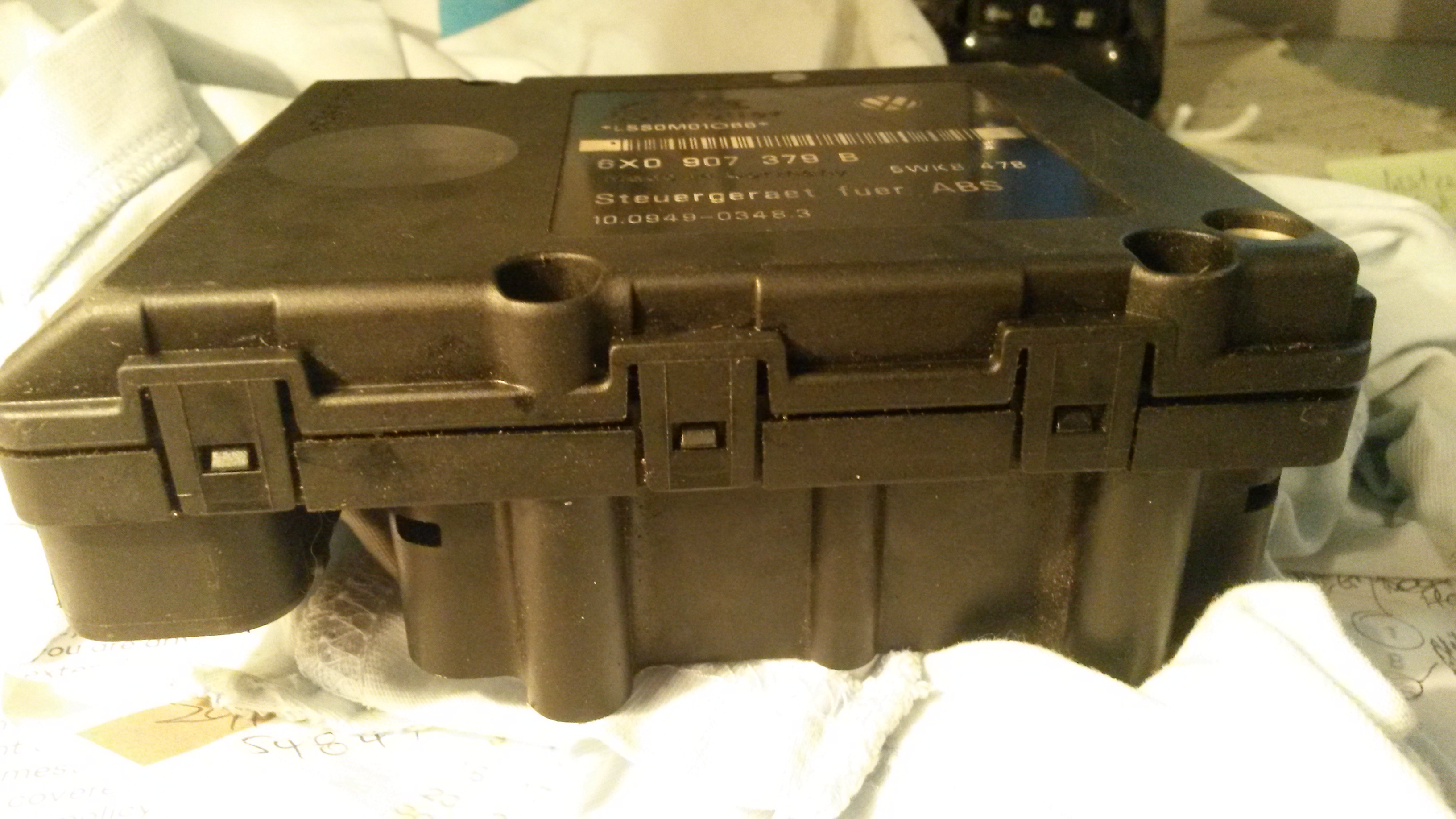

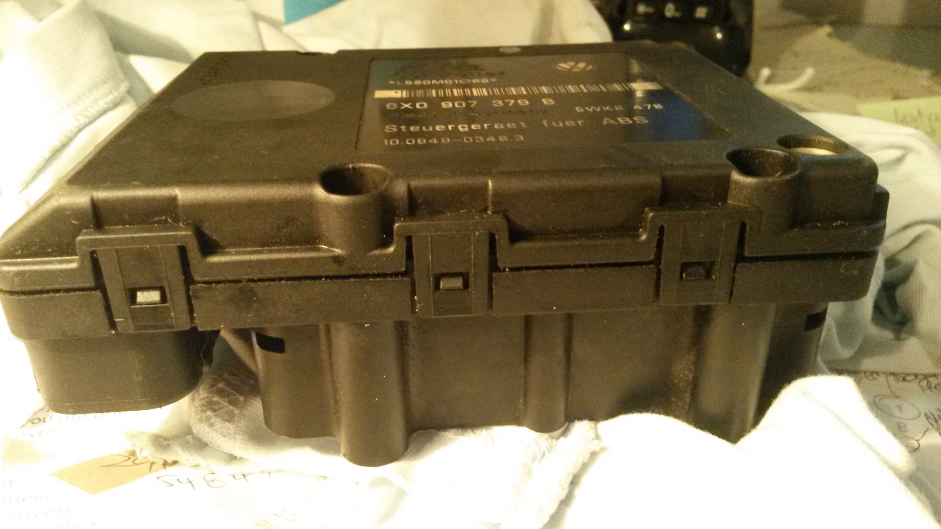

Sorry, one more question about splitting the unit. Mine seems to have a set of small clips all around the controller so is it not possible to open it by prising the 13 little clips open all at once ?
download/file.php?mode=view&id=3383

Yes, but very gently. Those clips will VERY easily snap off due to the type of plastic they use
