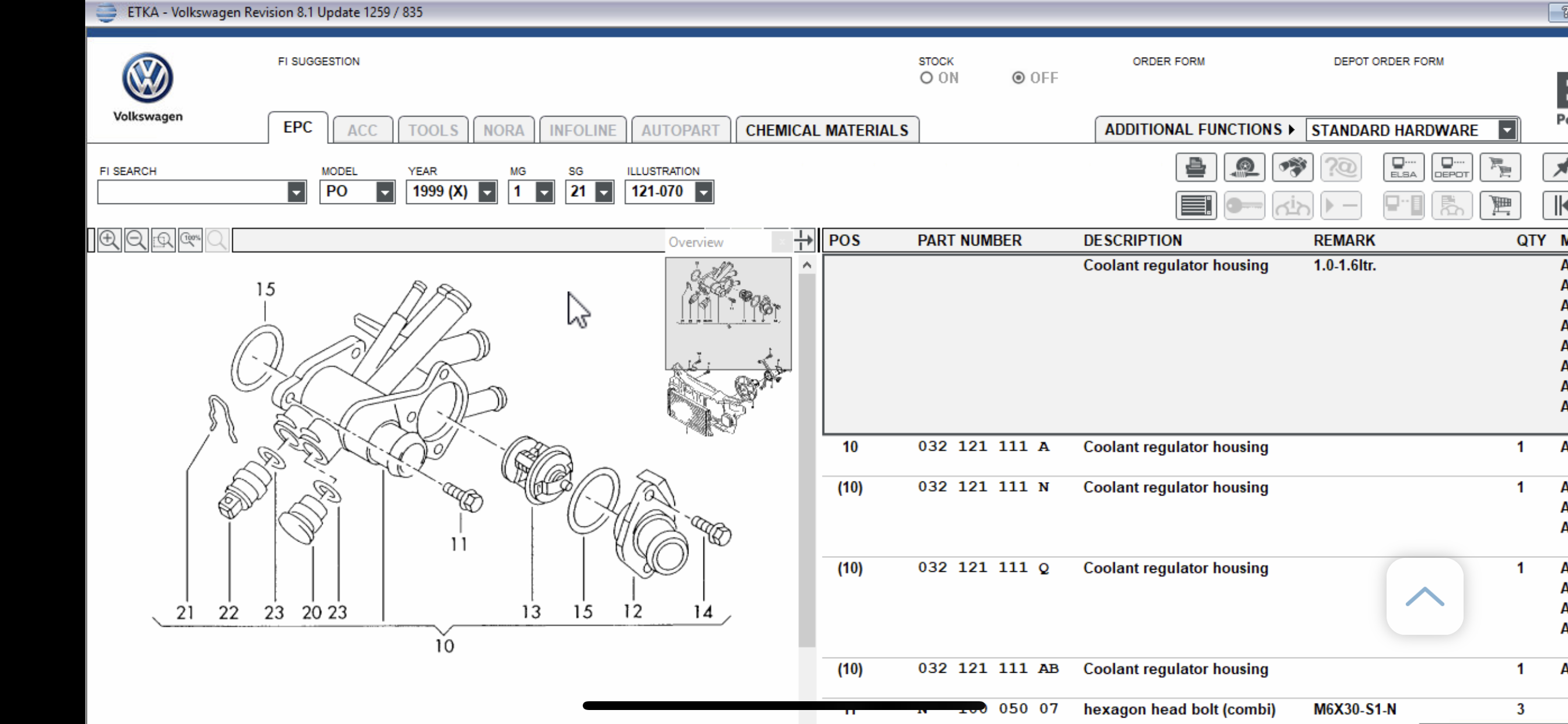

Hi there,
I would like an opinion on a particular situation.
I have a vw polo gti from 1999 6n1 Mk3 1.6 125 hp.
I bought the car last year and the temperature was always in the center 90*. Now it's the first time i'm in winter season and the temperature drops on the highway.
I have changed the thermostat 2 times and the temperature sensor (all original parts from vw), plus a new radiator fan was installed. We did all the tests we could at the garage with the mechanics, but they say it's normal to drop like that. We also tested the fan to see if the 1st and 2nd march were alright and they are. we even disconnected the fan and entered the highway to test and still the temperature dropped btw 70º and 60º
I have serious doubts about it, my mother's car is a normal 1.0 Polo Mk3 and the temperature stays at 90* all the time. I understand that mine has a bigger radiator and there is less struggle for the engine while driving at low rpm.
Howver, i would like to know if this is normal in winter with the cold.
Should these cars, and especially my model in particular, stay always at 90º under any kind of conditions?
Thank you!

That’s not normal
Did you have the thermostat housing changed also? If they break the pin gets jammed and forces the thermostat to stay stuck open
Re: Temperature gauge not in the middle
That's the only thing i didn't. I told many times the guy there about this part.
All he said was that it was just a reservatory, and since it had no holes no problem then and that the thermostat is original and well attached to it with the 2 screws on the cap.
I had serious doubts and wasted money on 2 thermostats because of all these, even had to make new holes because the old screws didn't fit anymore.
Can you explain me with detail what you mean by pin?
You need to replace the entire coolant sensor housing and the thermostat housing too
It all locates within a housing and over time it breaks down inside so there’s nothing for it to locate against
Do you know a place where i can buy the 2 original parts for my car?
Thanks a lot for the help!
