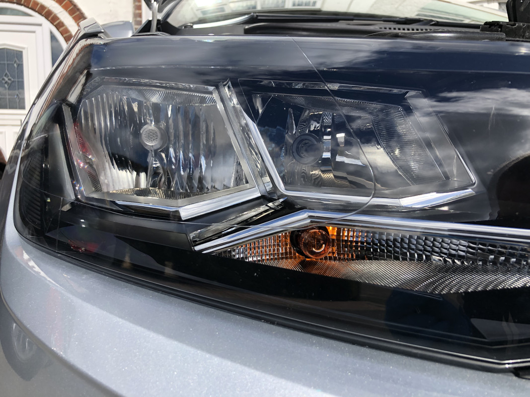

Right then, bulbs now fitted. I could tell a difference when looking into the light compared with the side I hadn’t changed at that point. Photos will follow tonight to compare with last night on the standard bulbs.
Notice the mistake in the manual. Number 2 is in fact the dipped beam not the main beam! In the below photo, the bulb on the left is the dipped beam.
