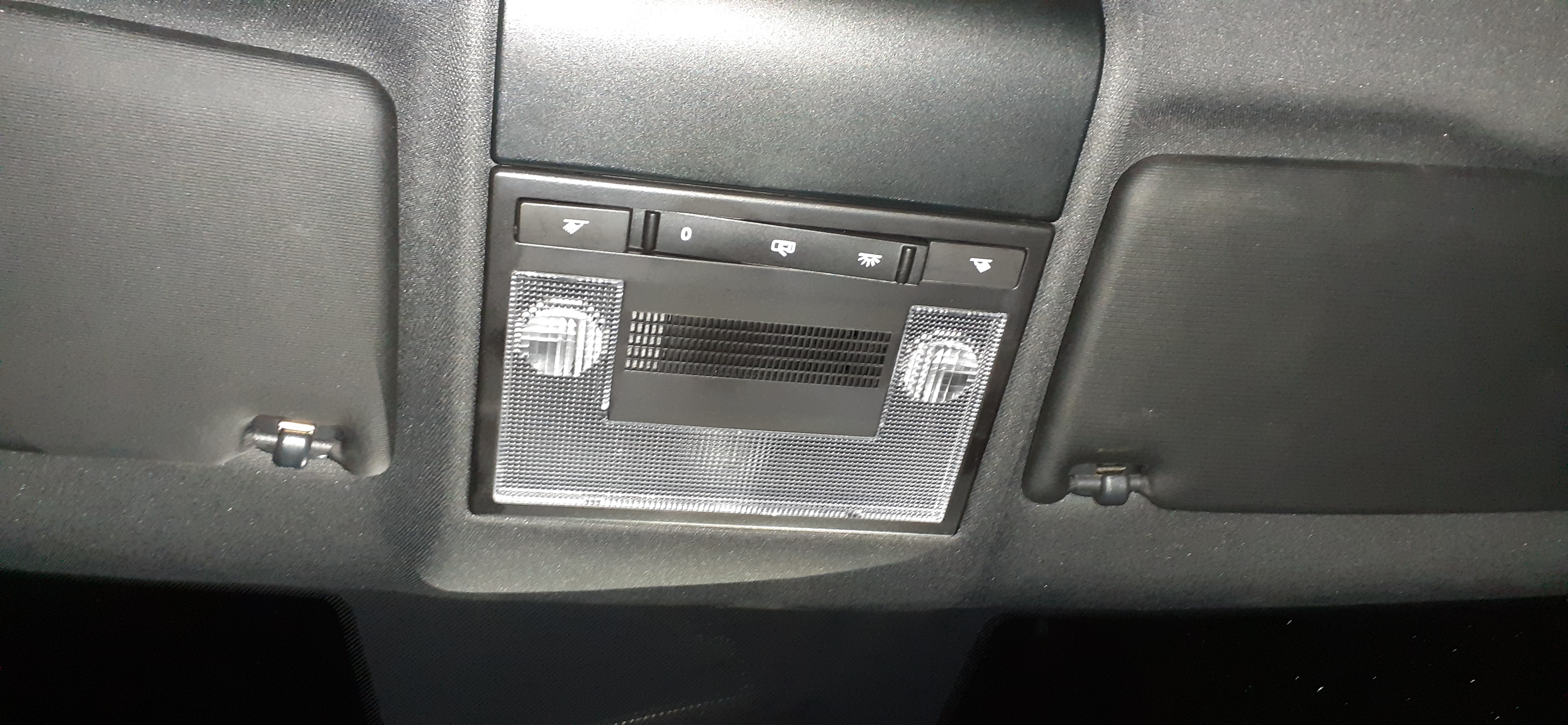

This is my dome lights:
That function is very nice and i also want do it, with your help of course.
About that wiring loom - this is very good news, i cant wait to do it and to fix my camera and back-up light, also that auto lights / wipers retrofit :)

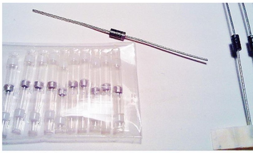

Thanks again ciclo,

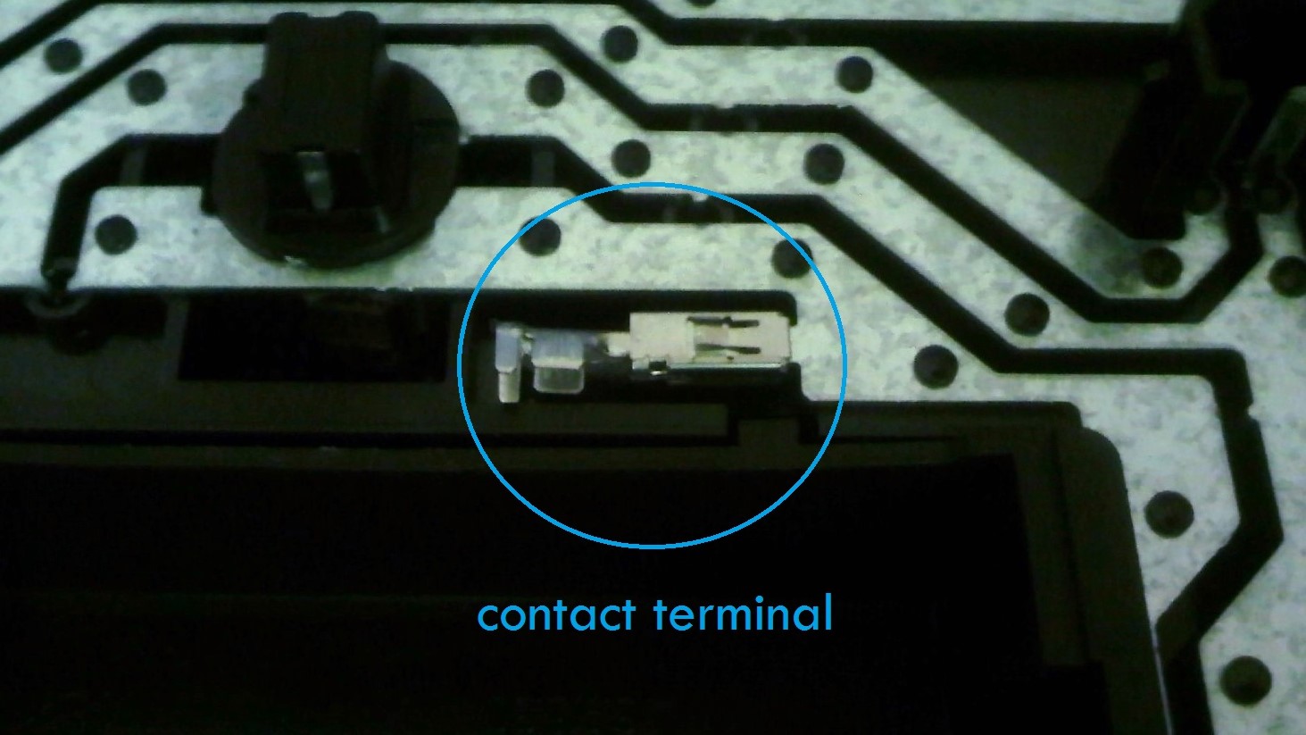

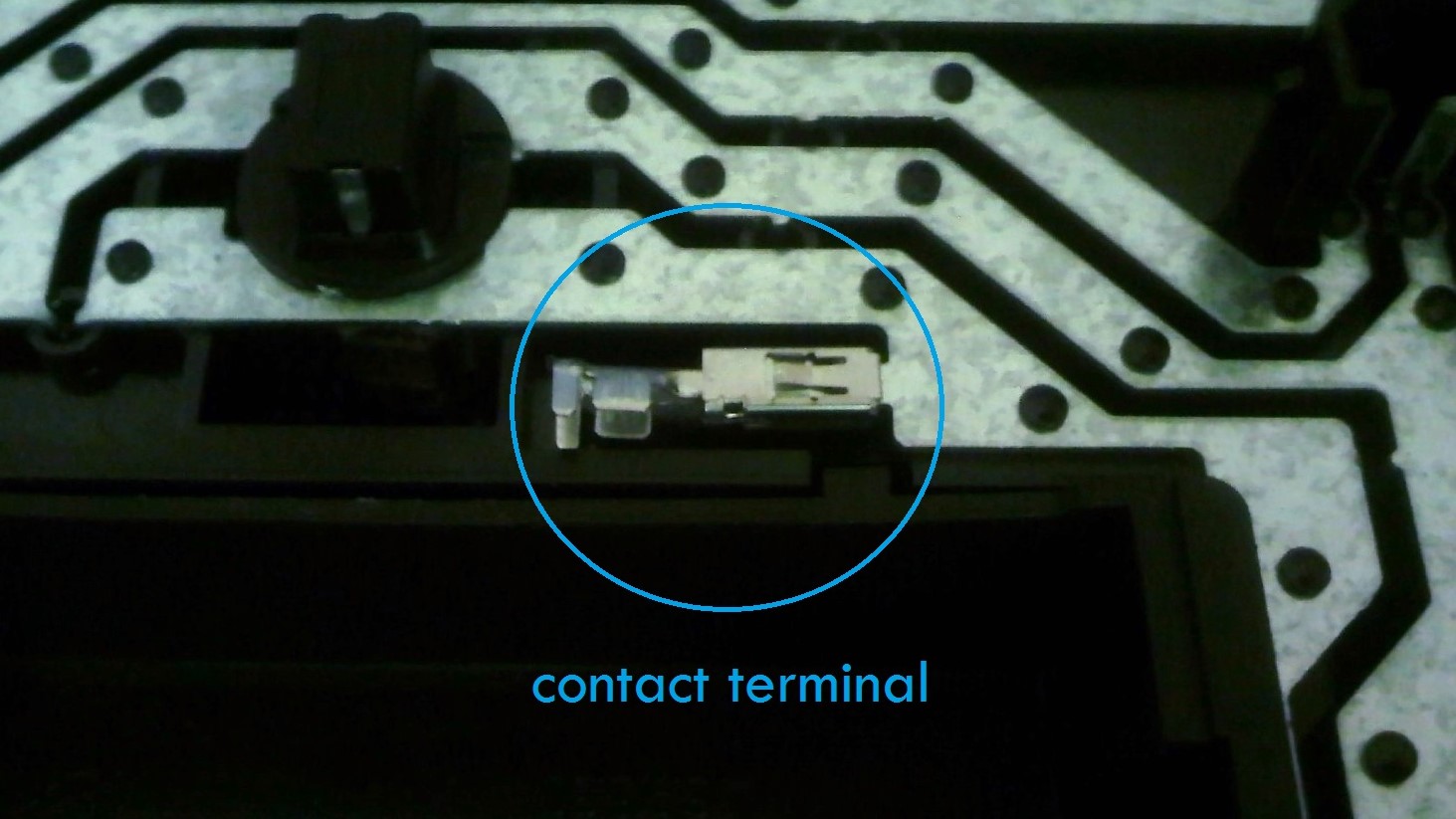

This is gonna be an easy affair :) Only 2 thing are not clear for me, and they are:
- the number of that contact terminal
- specification of that diode
Everything else is clear :)
Posts: 8996
Re: Reverse Lamp and Camera disappeared after BCM max Upgrade
While we wait for the contact terminal to arrive ... a small gift.

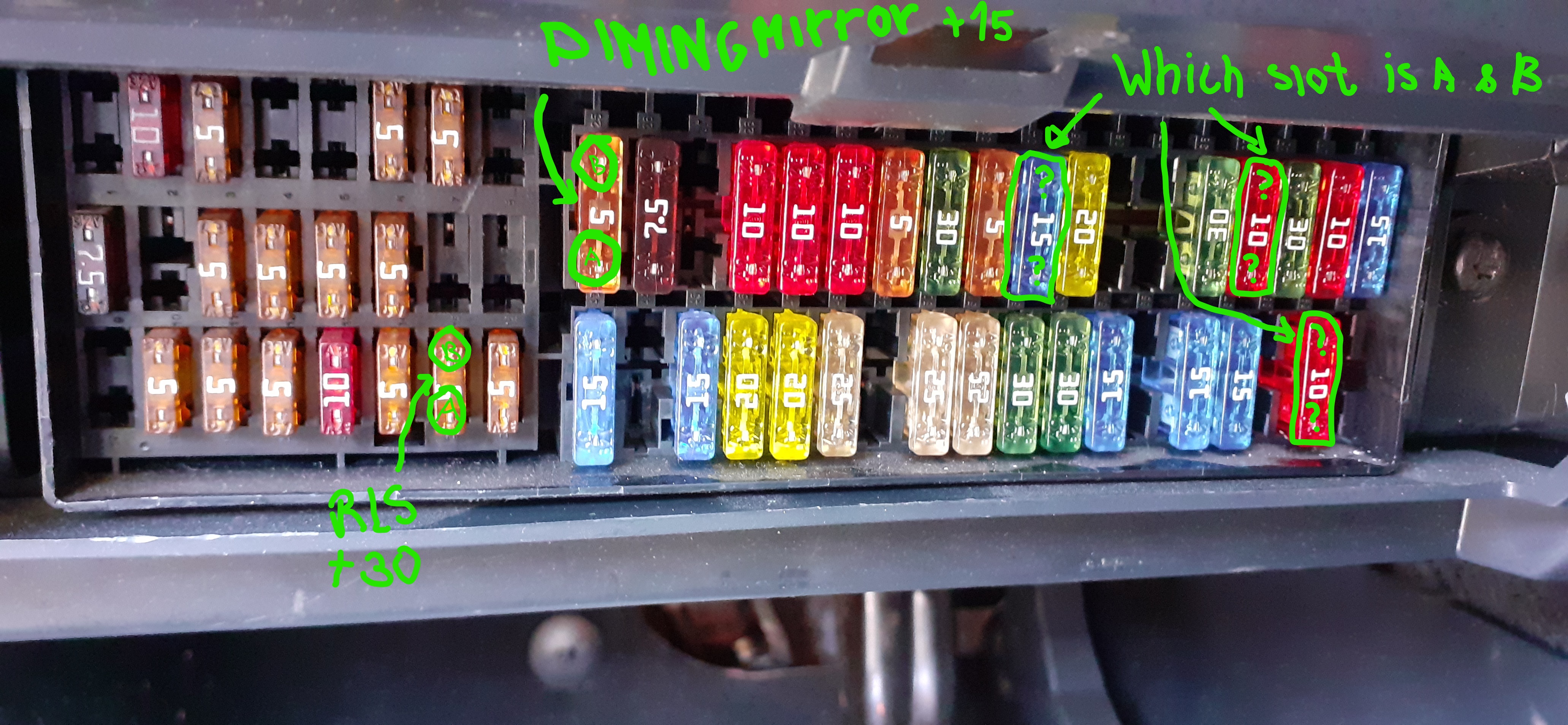

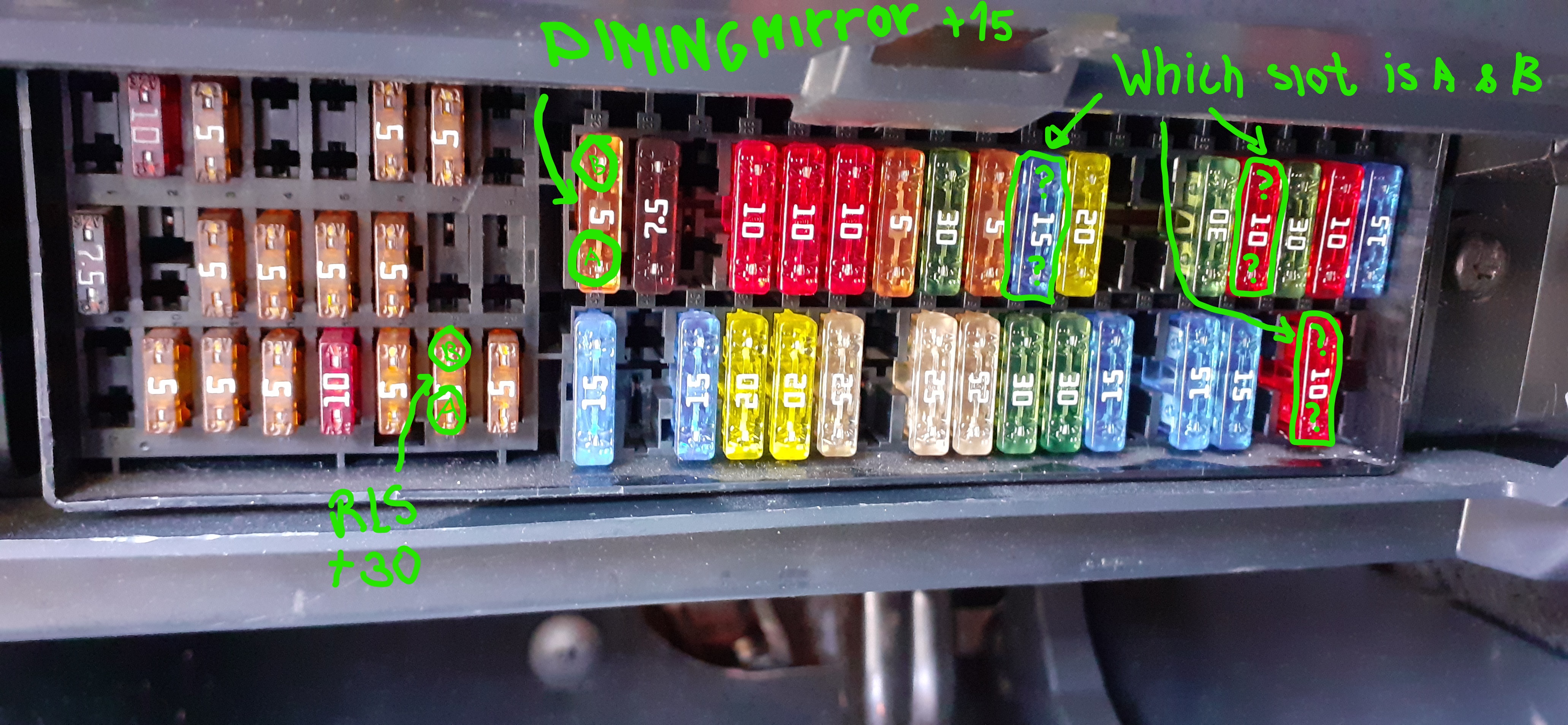

Today mounted that new windshield with rain light sensor and dimming mirror, everything was perfect! Now only thing to do left, is to connect cables to fuse box and to connect wiring for automatic lights. But i am wondering about few things:
- Where should i connect RLS +30 to SB23/44 a or b
- Where should i connect dimming mirror +15 to SB25 a or b
- SB34/39/59 - which slot is A and B
and that step WL 0 is it necessary?
Everything else is clear and ready to be assembled :)
Posts: 8996
Hi Zahari,
ZahariGeorgiev wrote: Tue Feb 18, 2020 7:06 pm - Where should i connect RLS +30 to SB23/44 a or b
In the 6R fuse box, A is INPUT or power supply input and B is OUTPUT or power supply output to the device.
Therefore it is B in both cases.
ZahariGeorgiev wrote: Tue Feb 18, 2020 7:06 pm - SB34/39/59 - which slot is A and B
In these fuses you are only interested in knowing / removing / touching the wire B.
In the installation guide the color of the ORIGINAL wires is suggested with colored arrows.
Thus:
34B = white / green
39B = yellow
59B = yellow / black
:lol:
Other ways to know which is A and which B:
- When removing the back cover of the fuse box you can see which is slot A and B. (it is difficult to see with all the cables there)
- With the original erWin diagrams I sent you by email/pm.
- With a multimeter.
ZahariGeorgiev wrote: Tue Feb 18, 2020 7:06 pm and that step WL 0 is it necessary?
No.
Help :)
How to wire the 6R fusebox.
https://drive.google.com/open?id=0B2nv9 ... GFIXzhsQ3c
Large fuses dont have the pink locking mechanism.

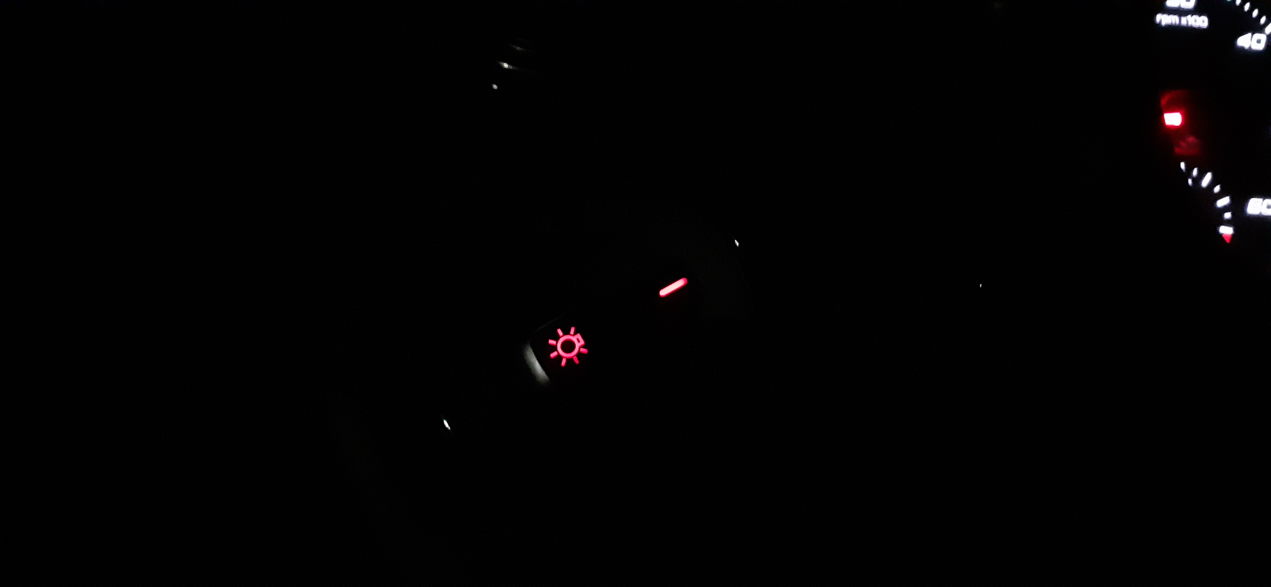

I just finish with the wiring, and got my reverse camera and back-up light back to life. Still didn't do the coding with VCDS (i will get it on monday) and i have see that few of the lights don't work: High Beam doesn't activate when i push stalk forward ( to the dash) and when i pull stalk to me, they activate it, the light of the light switch doesn't work, the light of the dash switches also don't work, and the light of the lighter also doesn't work. Are those problems gonna be solved when got the coding or something else is go wrong? And what coding i should do in my case?
Thanks in advance!
Posts: 8996
Perfect!
Tomorrow I send you the new BCM coding and everything will work as it should. :wink:
