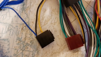

This is what I got.
Cables i need to know
It's the 8 speakers wires and the black yellow and blue

Sorry :oops:
I see it now written on the cables it's self, just the blue cable am unsure, i guess its for the Ariel, one I will test if it's powered constantly when radio is on for the amp on switch

Looks like the blue wire has nothing coming from the radio so i doubt that will do anything.
