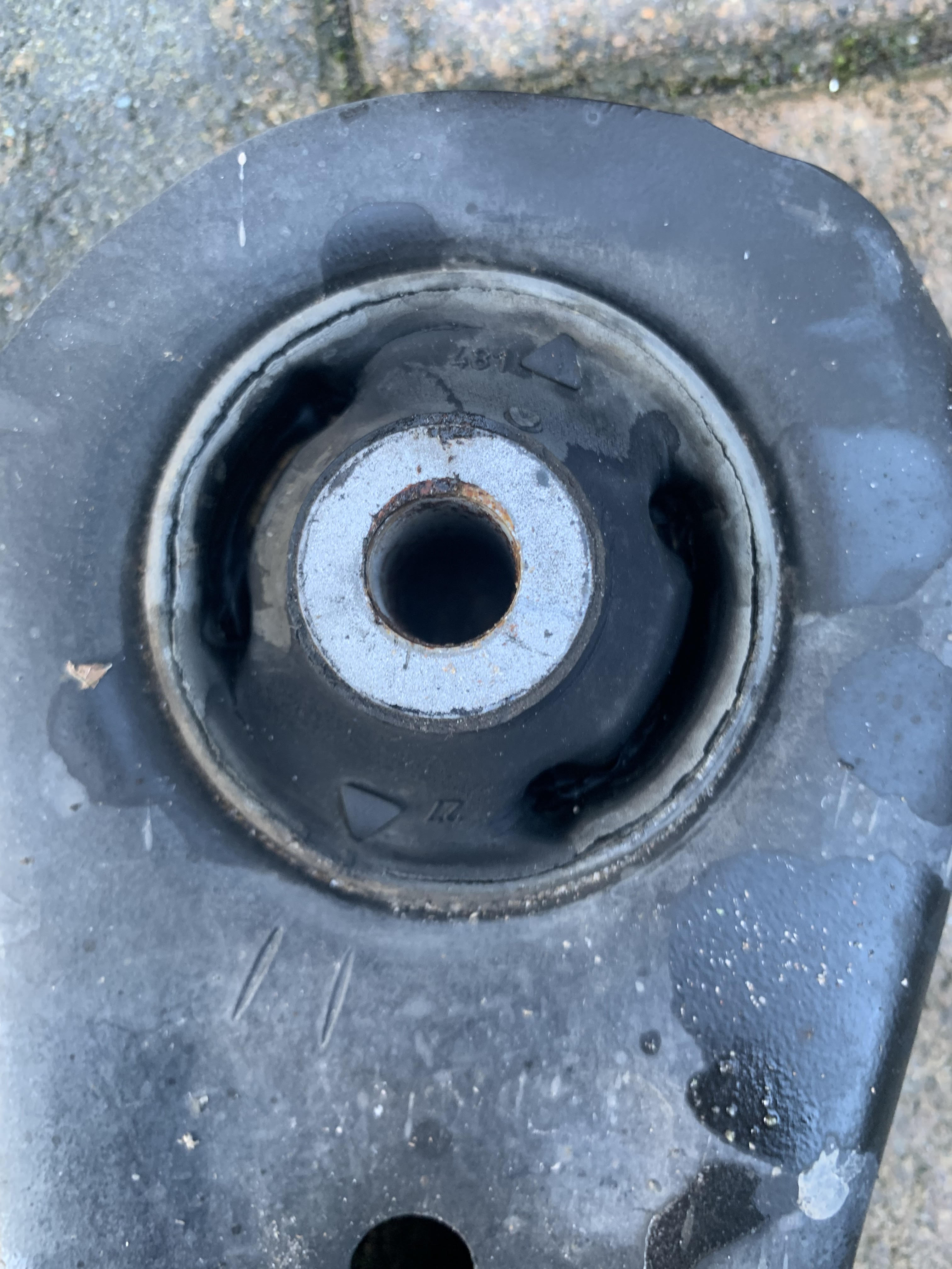

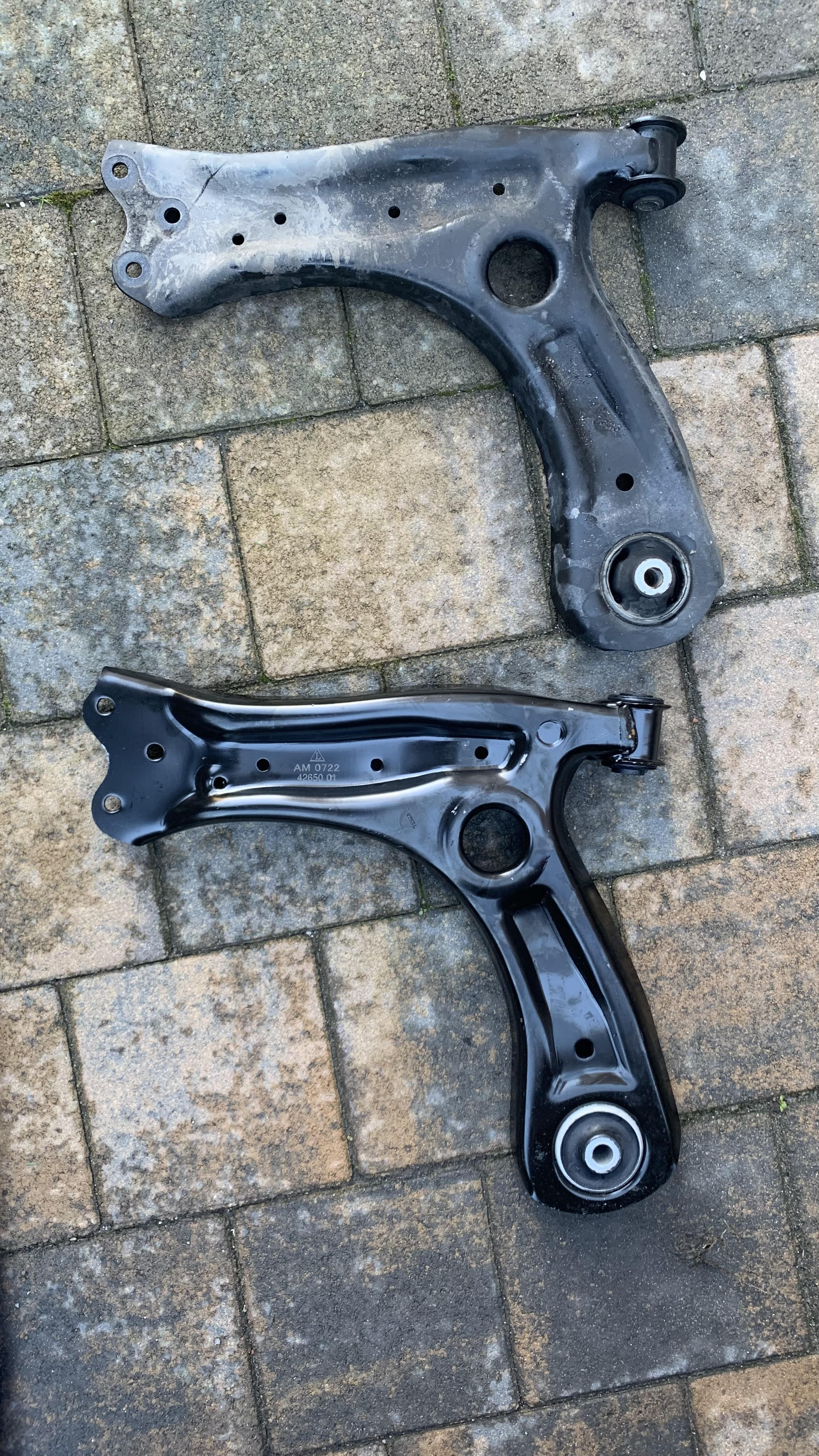

The Ibiza Cupra LCAs finally arrived and look identical to the polo arms just with the solid rubber rear bush instead of the voided bush that comes from factory.
In the end, I couldn't get the arm back in due to lack of space under the car and not wanting to damage anything I'll be getting them fitted by my mechanic.
Will update on how they feel once fitted.
Quick tip for those looking to do this themselves, get the rear bush aligned and the bolt through before trying to put the bolt in for the front bush, makes installation much easier and stops you stripping the threads on your bolt.
The solid rubber bush is also significantly harder to manipulate in order to get the bolt through so bear that in mind.
The original bush with 57K on it didn't look too great :shock:

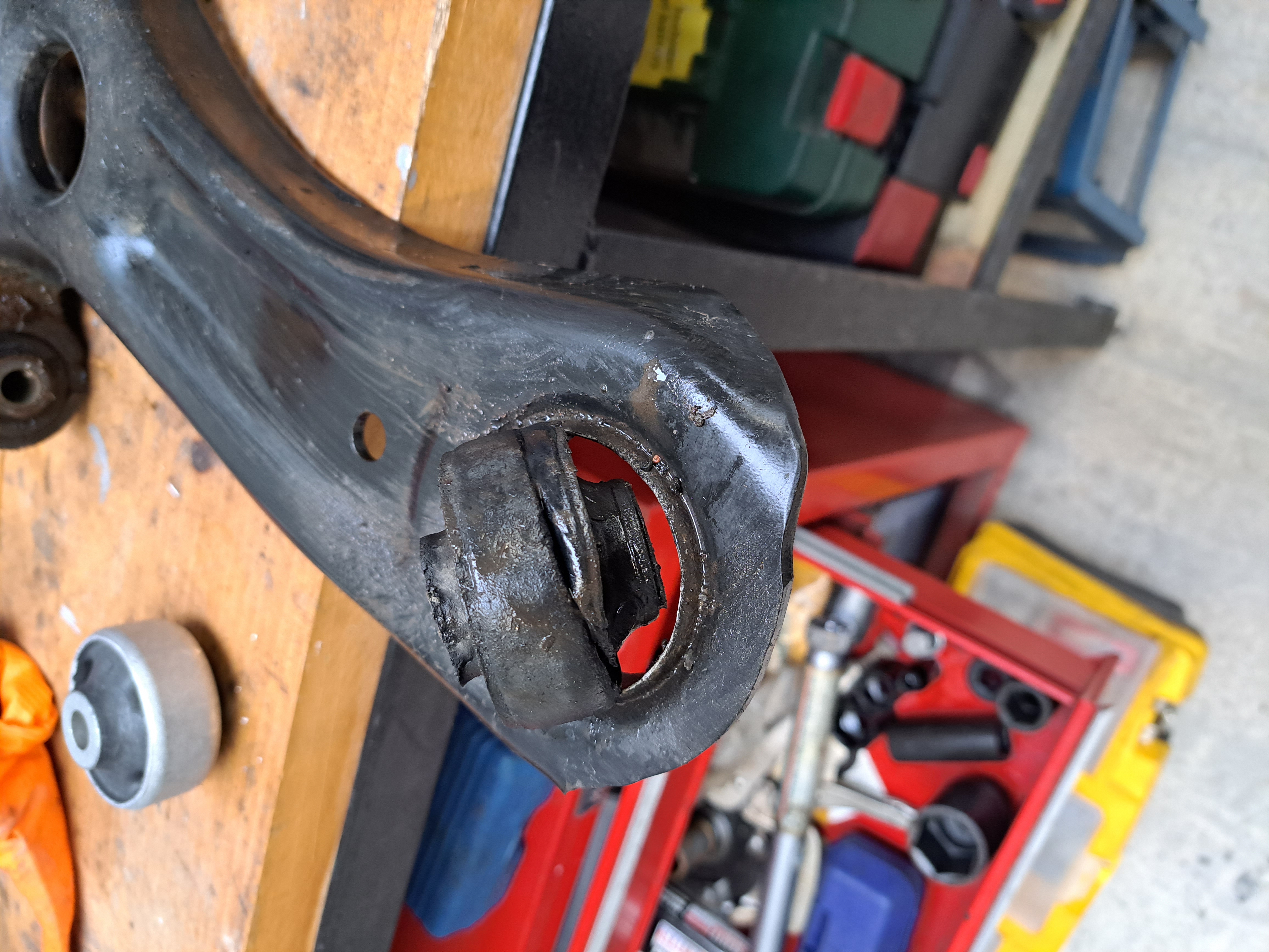

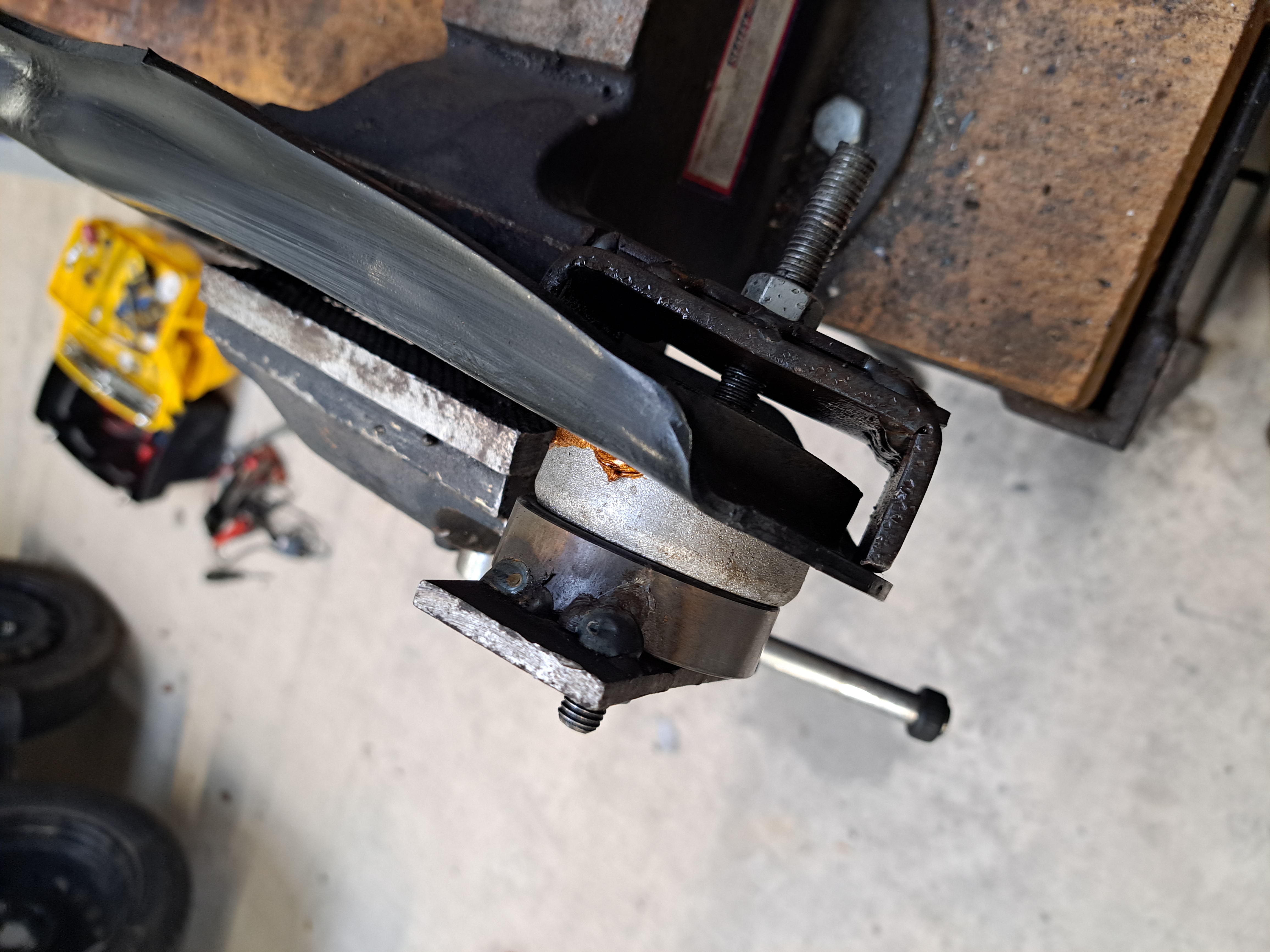

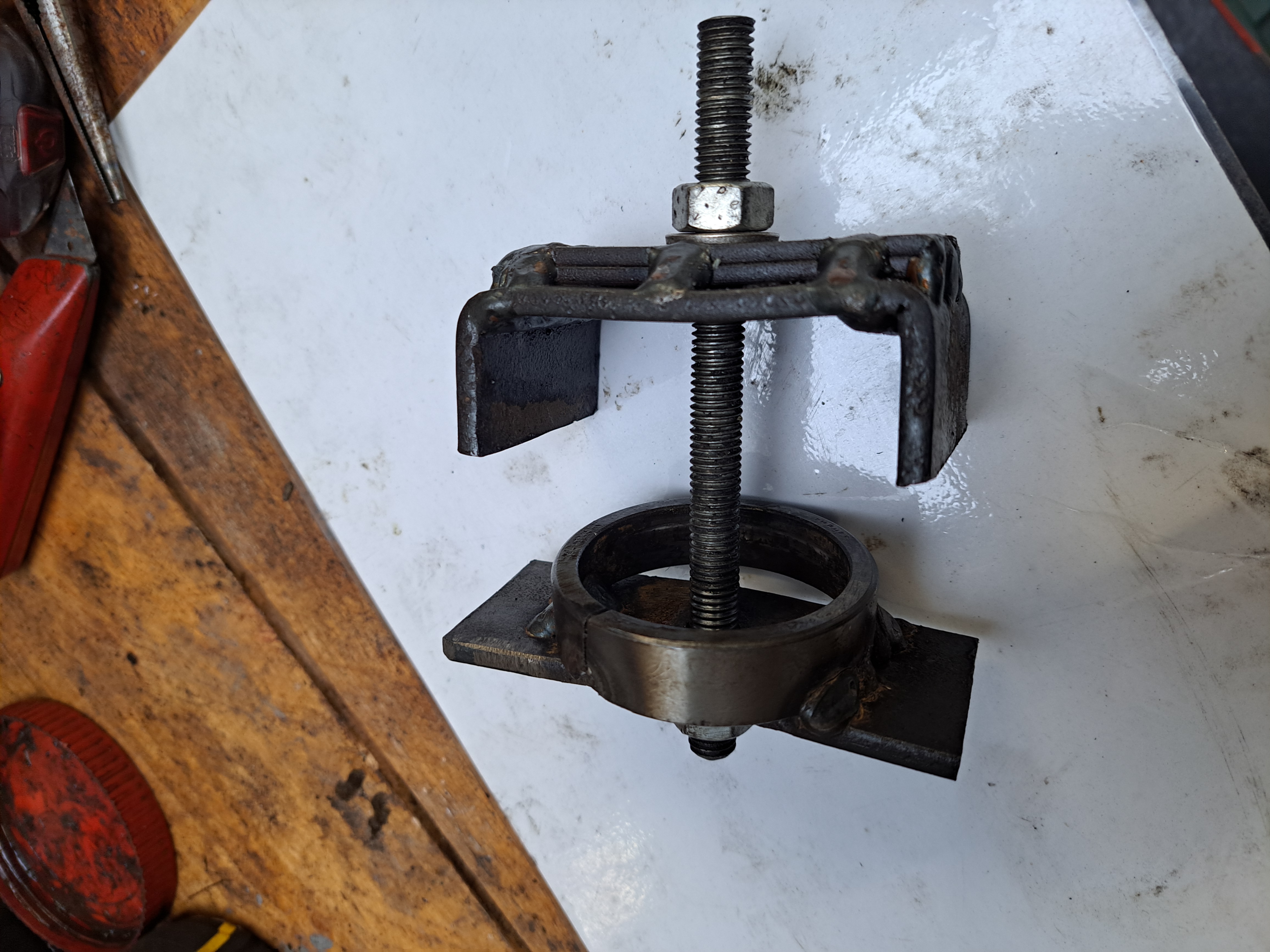

Did these bushes today. Used the solid Audi TT type.
Old ones were in bad state, especially drivers side on which the rubber was almost totally detached from the metal ring. With the arm out of the car I was able to remove the rubber by hand!. :shock:
Didn't have a bush removal or fitting tool but made one with flat steel, threaded rod and an old bearing outer race with help of the mig welder. Hopefully that will have cured the suspension clunk from the drivers side.

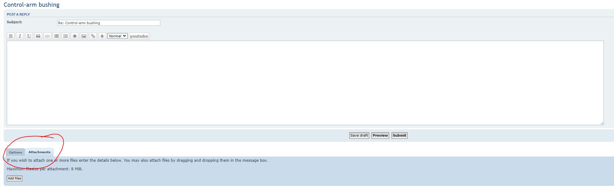

Also, you add pictures via the attachment tab just under the text box :)

Re: Control-arm bushing
Love the tool, thumbs up
