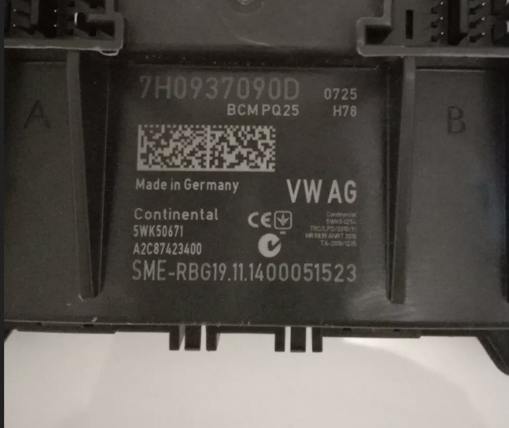

Hello ciclo, I have a t5.1 2013, with a 87 bcm, i am intending to max bcm, do you recommend me to buy the bcm in the pic ?

Shadow109 wrote: Mon Sep 28, 2020 10:17 pm Hello ciclo, I have a t5.1 2013, with a 87 bcm, i am intending to max bcm, do you recommend me to buy the bcm in the pic ?
The reference number is correct, but I always recommend buying brand new BCMs because they have totally virgin coding and adaptations.
The usual thing is that everything goes well with the BCM that you show us in the image.👍

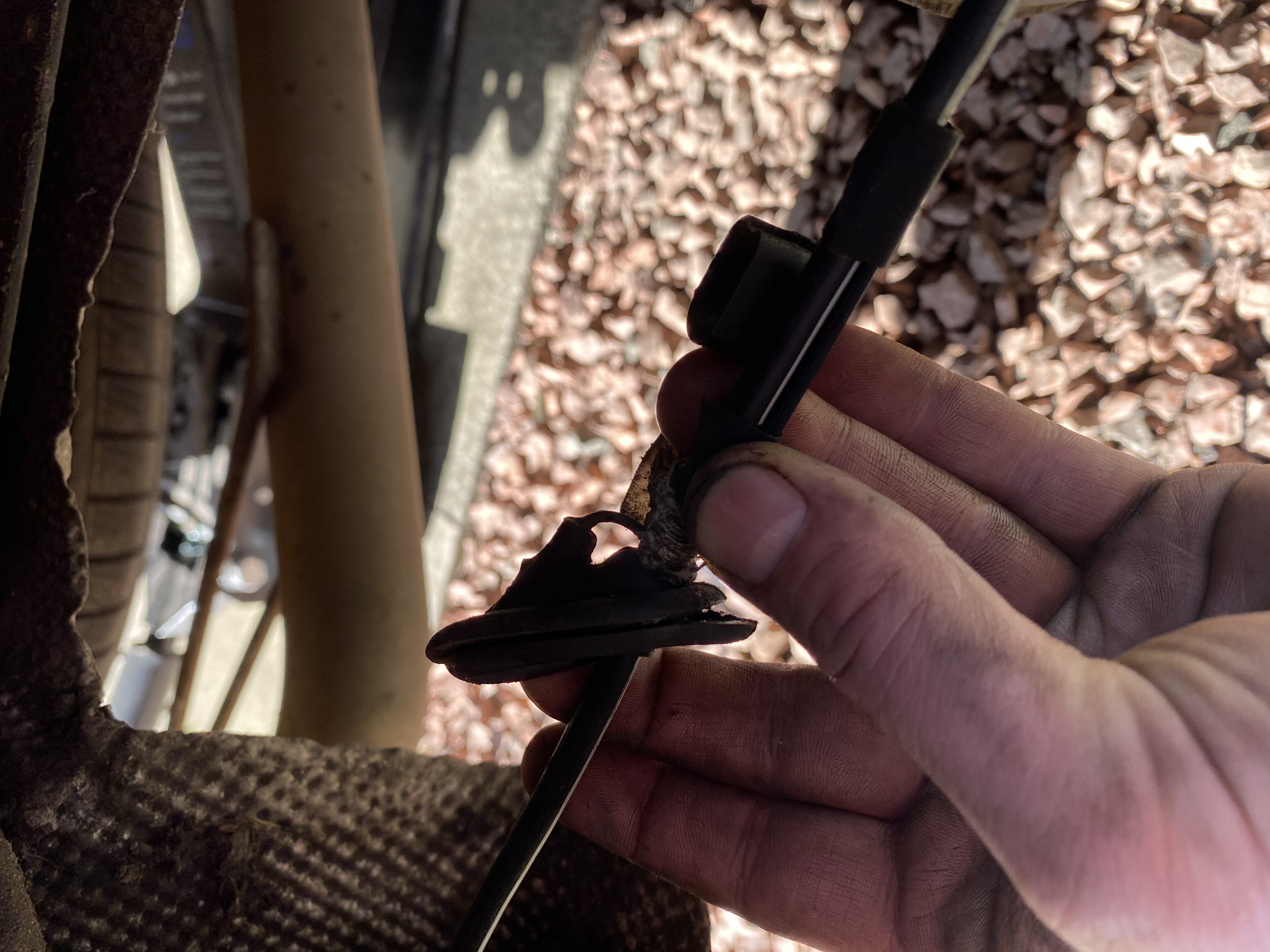

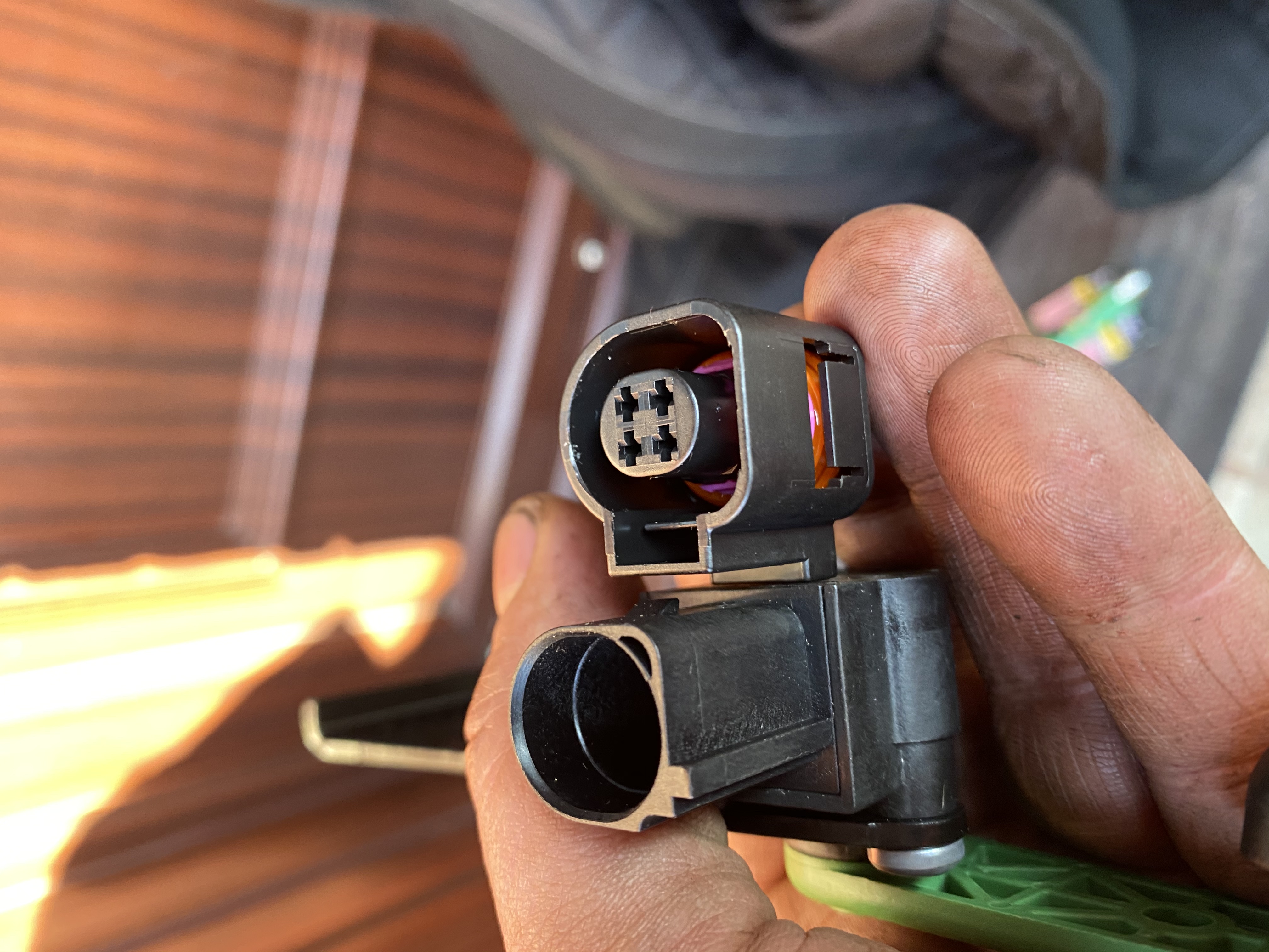

Ok, so I have ran the wiring for the rear xenon level sensor.
Goes from the Xenon level control module under dash/BCM area - up drivers A pillar, follows wiring loom along the roof line - at D pillar it drops down and follows wiring loom for Rear speed sensor, through a grommet with a helpfully spare way in it, behind the rear wheel arch plastic. - Pops out at the level sensor. I have photos which I will upload shortly. Kufatec look to have supplied the wrong plug for the xenon level sensor though which I am well peed off about! Both at them, for apparently suppling the wrong parts and disappointed with my self for not checking earlier! It is either the wrong plug or there are some updated xenon level sensors with different connections or something. photos to follow...
Fun and games....

Ordered the correct plugs, part number 4B0973712A
Posts: 8982
Hi reido80,
According to ETKA it is 4H0973712A
...although it seems identical to 4B0 ... ... A
Thank you very much for the explanation and images.👌
