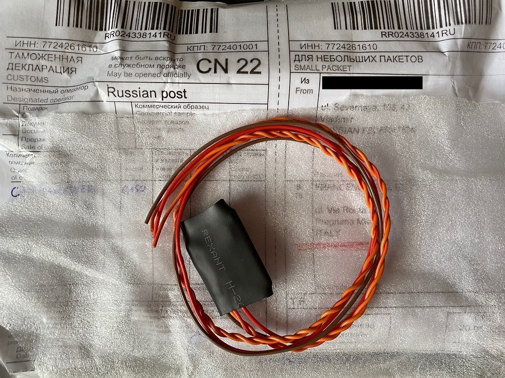

And now... from Russia with love.
After 2 months and 9 days of waiting the little package with GRA High emulator arrived!

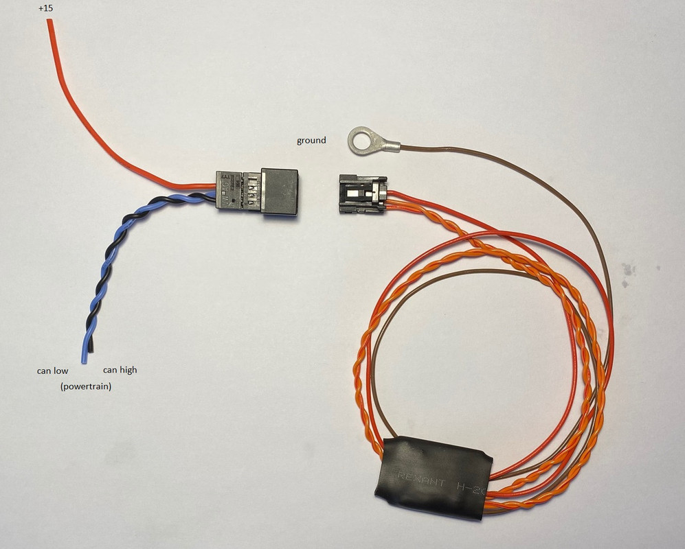

Today I managed to install GRA High emulator but for some reasons GRA speed is stuck at 0 km/h.
I connected emulator wires to CAN powertrain (old CAN) as It was told me to do.
I took CAN wires from column switch.
Do you shink I should try to connect them to new BCM max (7E0) CAN line (T32/28; T32/29)?
Below my installation way.

- Posts: 7852
- Location: Earth ♥, sPAIN, Magiclands (Mordor).
Re: Franciswat's Polo 6R 1.6 Bifuel
I don't know / don't remember, I don't have that emulator installed.
My Gra_High signal come directly from the ECU.
Better talk to firegrafik (look at his drive2.ru thread) or with iichel, I think it is the system/emulator they have installed for the Gra_High signal.
Hmm ... just tell you that the car must be moving ... forget this comment if it's too obvious ...

Thank you for you answer Fernando.
When car is running and I press SET button CC works fine but on the bottom left It's only diaplayed 0 km/h.
I'm getting confused for which CAN line use.
Roman (emulator programmer) told me
I have just asked firegrafik who told methe connection must be established to Can Powertrain.
As long as you understand I have to connect emulator wires to new CAN line of BCM max in t32/28 and t32/29 instead of the old CAN line (power train)?Can emulator should be connected to the same CAN bus as instrument cluster. If you have BCMmax with extended can wires for the cluster so the CAN emulator should be there too.
- Posts: 7852
Yes, connect the emulator to the new CAN lines that you installed for the BCM Max.
Hope this time everything works correctly. It will like you.
Please tell us the result. Thanks Francesco!
- Posts: 6420
I had the same. The Russians helped me with a new firmware for my emulator. You can contact Firegrafik or rofireman

Hi guys, I connected GRA emulator to the other CAN wires from IC connector.
Nothing changed.
Video:
https://youtu.be/L36DUdzPozg
Wirings:
https://i.postimg.cc/YCSNJqxL/wiring1.png
https://i.postimg.cc/Cx6CYTvP/wiring2.jpg
Nothing changed.

- Posts: 7852
As iichel tells you, it is necessary to modify the emulator firmware so that it works correctly 'on your 6R'.
Contact them.
Contact them.

Roman said:
What does it mean guys?try to connect to the wires Can bus about amplifier helm
