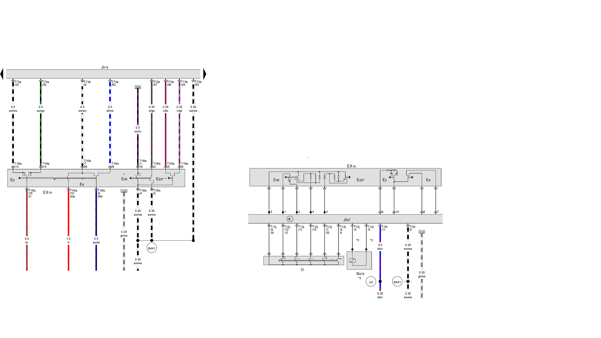

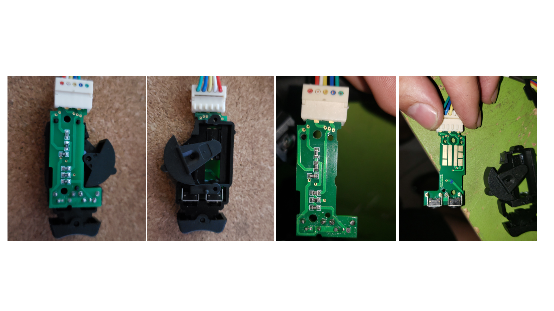

I have not got a corresponding stalk, I have one from a vw vento with the same format. The circuit has 5 wires and I was able to identify some, but looking at Elsawin's diagrams I can't find the 6th wire, and I'm also not sure which wire corresponds to pin 44 and pin 46
Attached some photos, my diagram is based on the T16d connection with ECU pin T94 / 56
Greetings and thanks.

Hi Pablo. I have installed CCS in my up tsi too. I don't know if this information could be important to you, but I know that pin 44 corresponds to SET button on stalk, pin 46 corresponds to RES button and pin 47 to CANCEL. You don't have any feedback from stalk or they are showing wrong? in up the sequence is:
stalk / bcm / ecu
pin 1 / terminal 15 (when ignition is on"have used the cable blue and purple on wire of stalk, i guess it's t16/11, but i'm not sure about it")
pin 2 and pin 4 / pin 45 / pin T94-56
pin 3 / pin 47
pin 5 / pin 46
pin 6 / pin 44

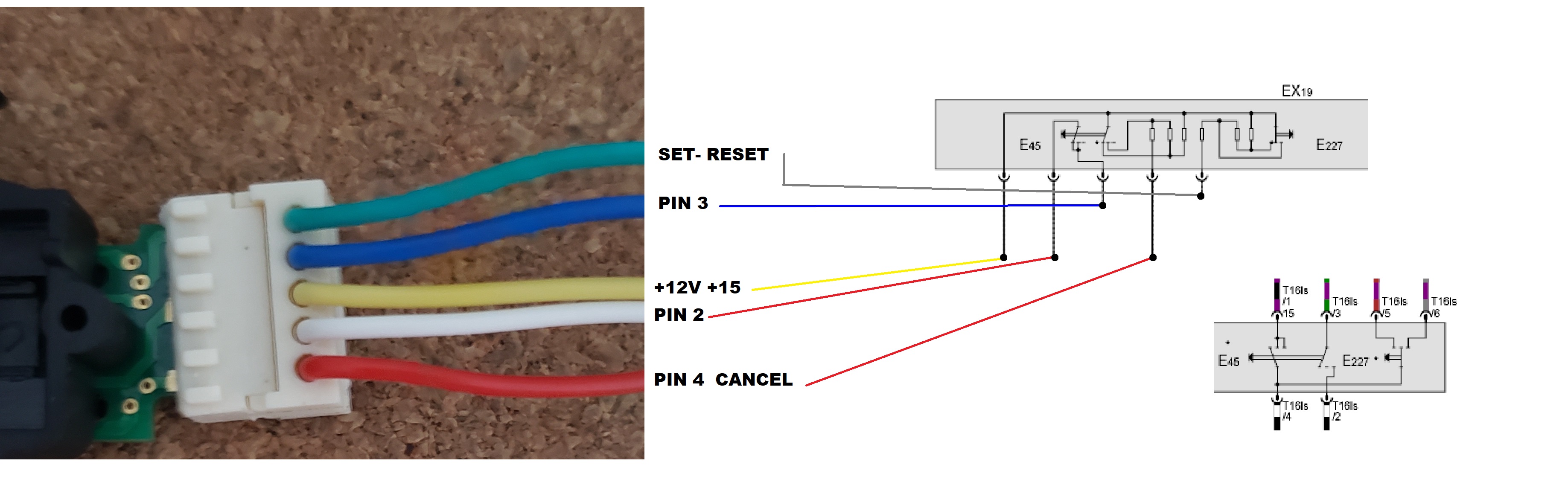

Hello Matmaz. Thanks for the data.
The problem is that the set and reset signal, I have it in a cable, I measured it with the multimeter and following the diagram I don't know if it has an internal bridge between set and reset since it sends two different signals.
Could you see any bridge inside the stalk? behind the terminal.
I attach a photo of the signals that I measured, pin 4 is the only one that has a cancel signal

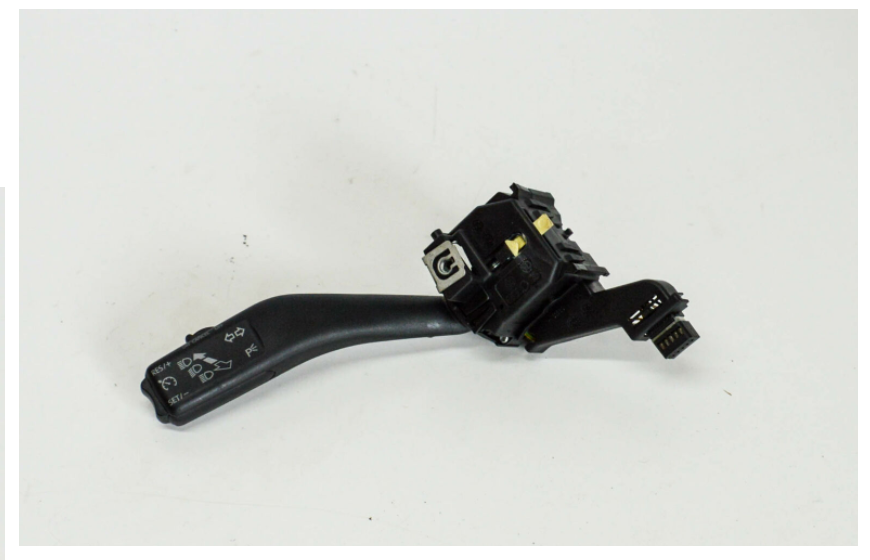

What is the part number of the stalk?

iichel wrote: Thu Mar 25, 2021 9:39 pm What is the part number of the stalk?
Hello the number is 1K0953513 F
I correct and add photo
Regards

Pablo f wrote: Fri Mar 26, 2021 12:39 am
Regards
This is the part number of stalk that I have used in my car: 5Z0953513H
But your car is a Up! pepper and if I'm right it must have rain sensor, and because of that you need a different stalk like this 1k5953502k or something similar but with a different connector like as the first part number.

Matmaz wrote: Fri Mar 26, 2021 2:47 pm
Regards
But your car is a Up! pepper and if I'm right it must have automated wipers, and because of that you need a different stalk like this 1k5953502k or something similar but with a different connector like as the first part number.
Exactly that is correct. My idea is to disassemble and change only the left stalk. Here in Argentina it has been impossible for me to get that piece.
