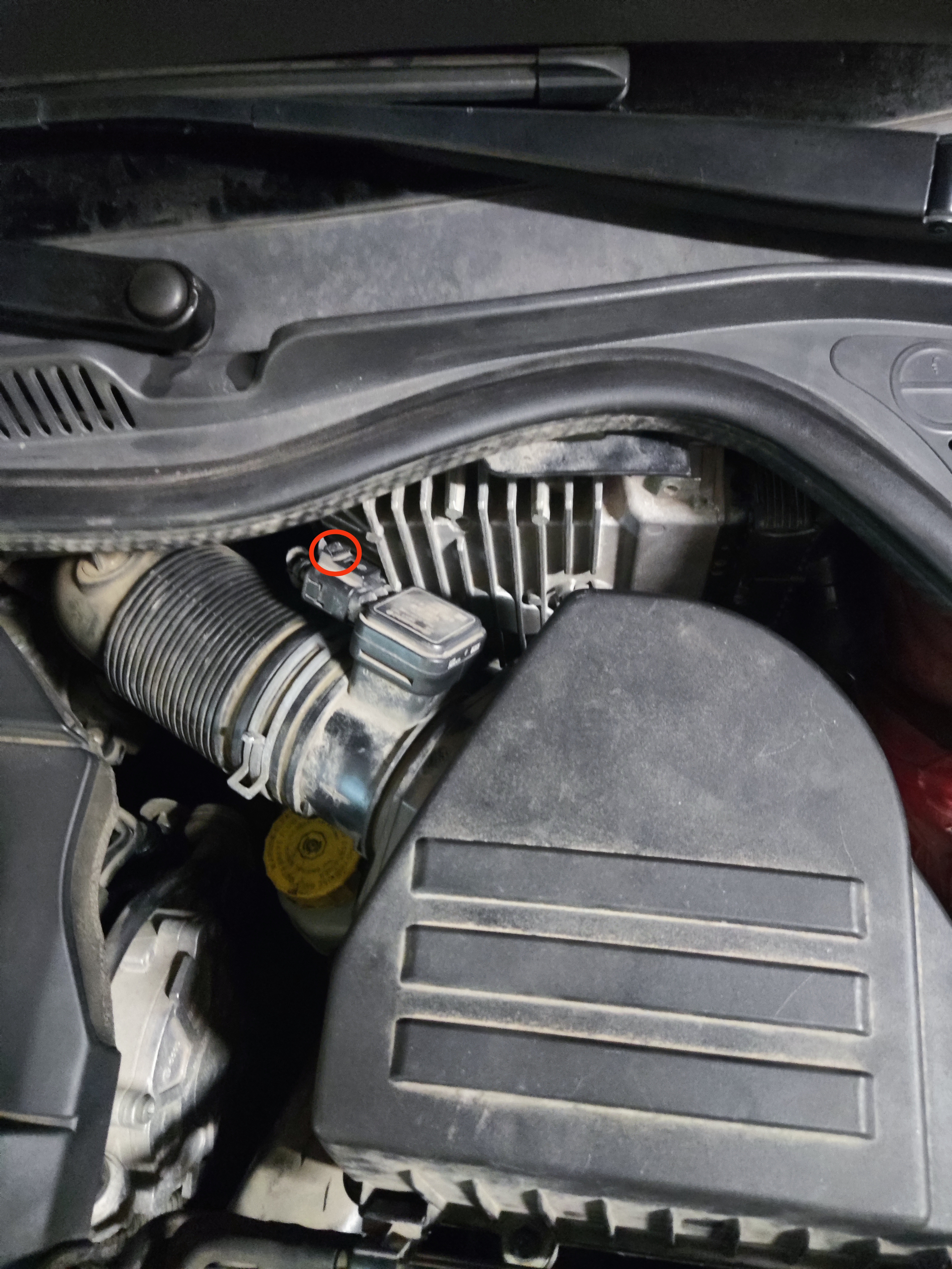

Hello everyone, first of all thank you very much because without this forum I would have been unable to install the cruise control on my Volkswagen polo 6R 1.6 tdi 90cv. The truth has cost me a lot of work and although I have managed to get it to work if I do a scan with VAGCOM I get errors that I did not have before, they appeared after verifying the connection of the ECU cable that the first time I had not gotten it right at all, I also had a bit of a bend in the tab on the air filter connector, although I don't think that's the problem. I am worried if these failures cause any problem in the car, the car works perfectly and the dashboard does not show any error while driving, the air conditioning also works well. I need your help. Thank you.
I attached a photo of the tab that was bent but I think it works well

Also say that I installed the kufatec kit and following its instructions connect to pin 44 of connector A of the BCM, then I followed your instructions and connected to fuse 11 repairing cable 44 of connector A as it came from series, in case the problem was there. Thanks.
