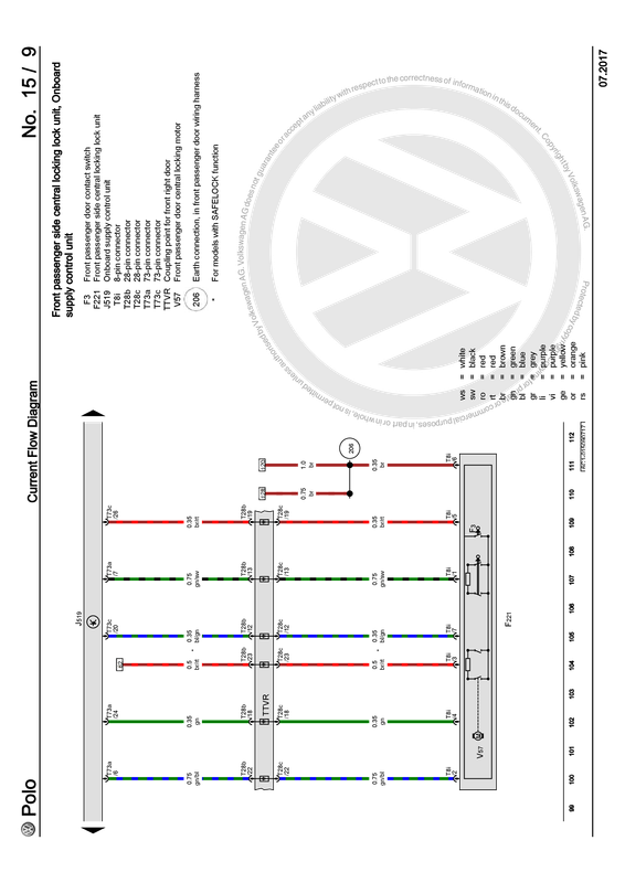

ciclo wrote: Mon Feb 02, 2015 2:39 am I have not yet made this mod because the door panels are very expensive if you make a mistake when cuttingImage but I rescue this interesting information (diagrams) that I published on the Italian forum to warning/illumination lights on the doors.
Driver door
Image Image
Left and right rear doors
Image Image Image
Front passenger door
Image Image
Pictures (with your permission thealbert) :wink:
+Supply from the connector on the unit window. (All is pin 16).
-Ground from the door contact. (see diagrams for exact pin each door).
In this way only turn on the light from the door which is opened.
Hi, i am thinking of doing this mod to my car, a Polo 6c MY2016. I can't find the door's contact wiring for the front doors. For example this is the picture from the passengers' door wiring. There is a contact switch (F3) but there is not a specific wire for that contact. On the other hand, i find this contact at the rear doors (always on wiring schematic)
Could someone help me?
Posts: 8913
Re: My Polo 1.2 TSI DSG
6R vs 6C have the same assignment for the door switches (F).
DD ... T8/3
PD ... T8/5
RDD ... T8/2
RPD ... T8/5
In any case, for 6C you must pay attention to the coupling point T28/19 for all doors.⚡
