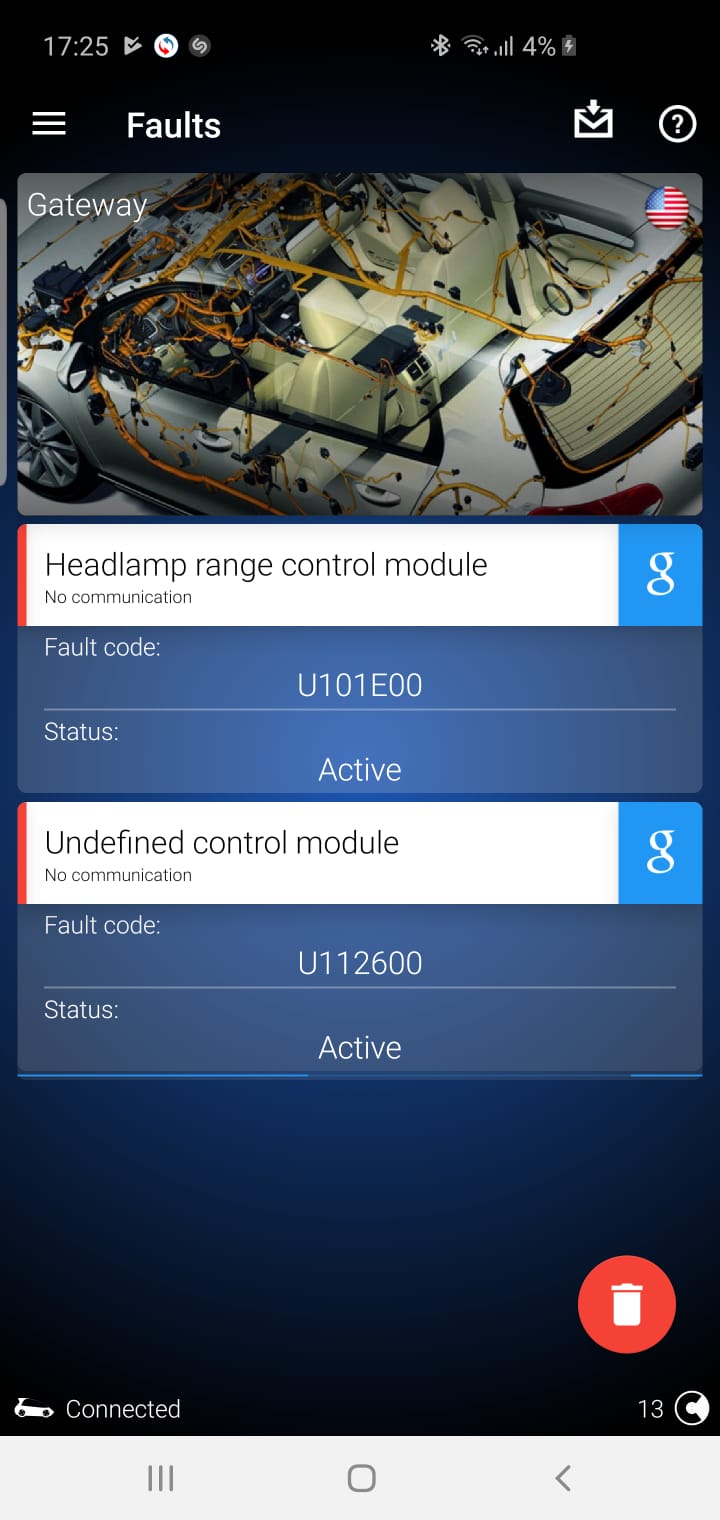

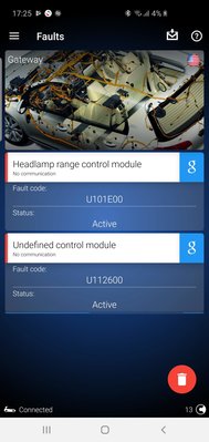

I currently have on me the obdeleven but on monday I will do a proper scan with vcds
obdeleven scan
obdeleven scan

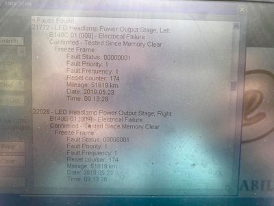

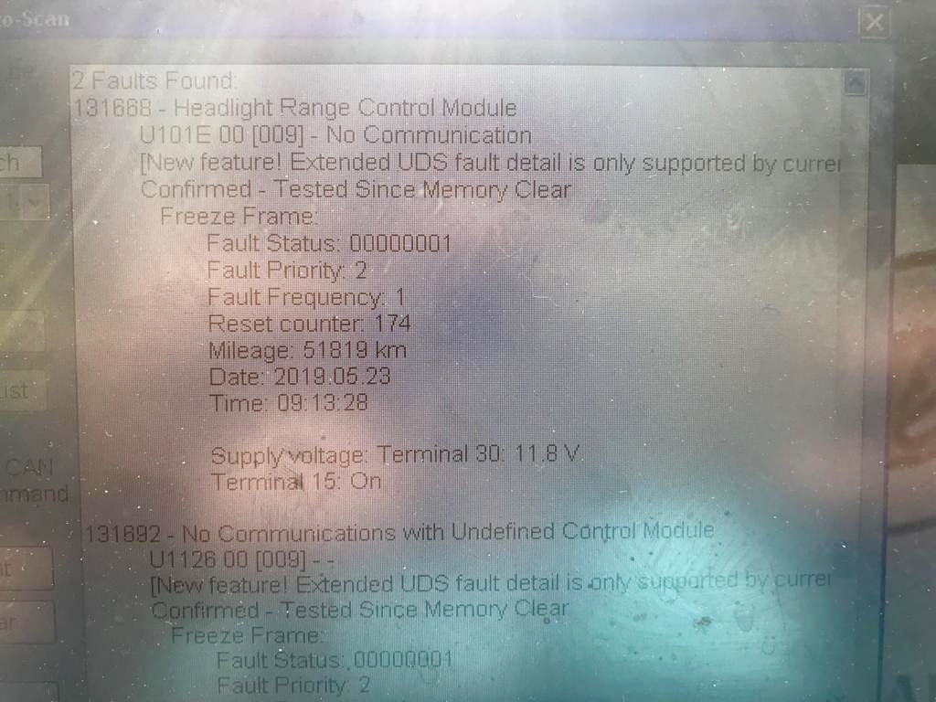

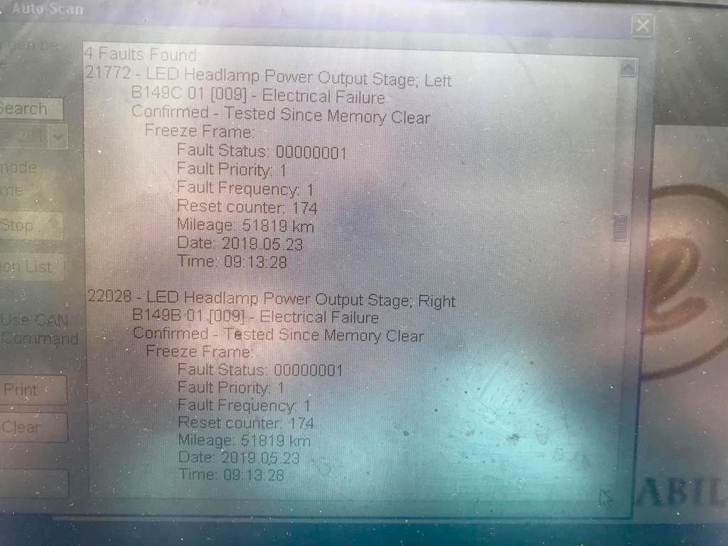

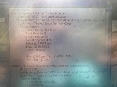

I made a full scan and these are the faults on the headlights...sorry for the low photo quality
