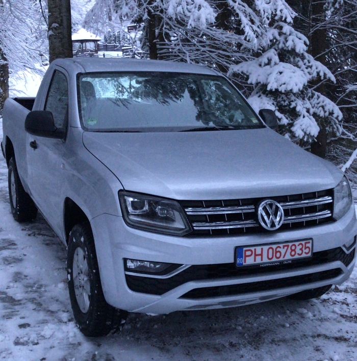

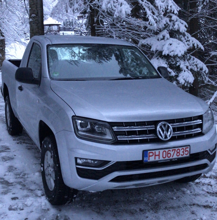

Re: Amarok Oem Bixenon retrofit
Unfortunately I don’t have a delivery date for the Bcm.
The facelift is complete now with facelift grille and emblem.
