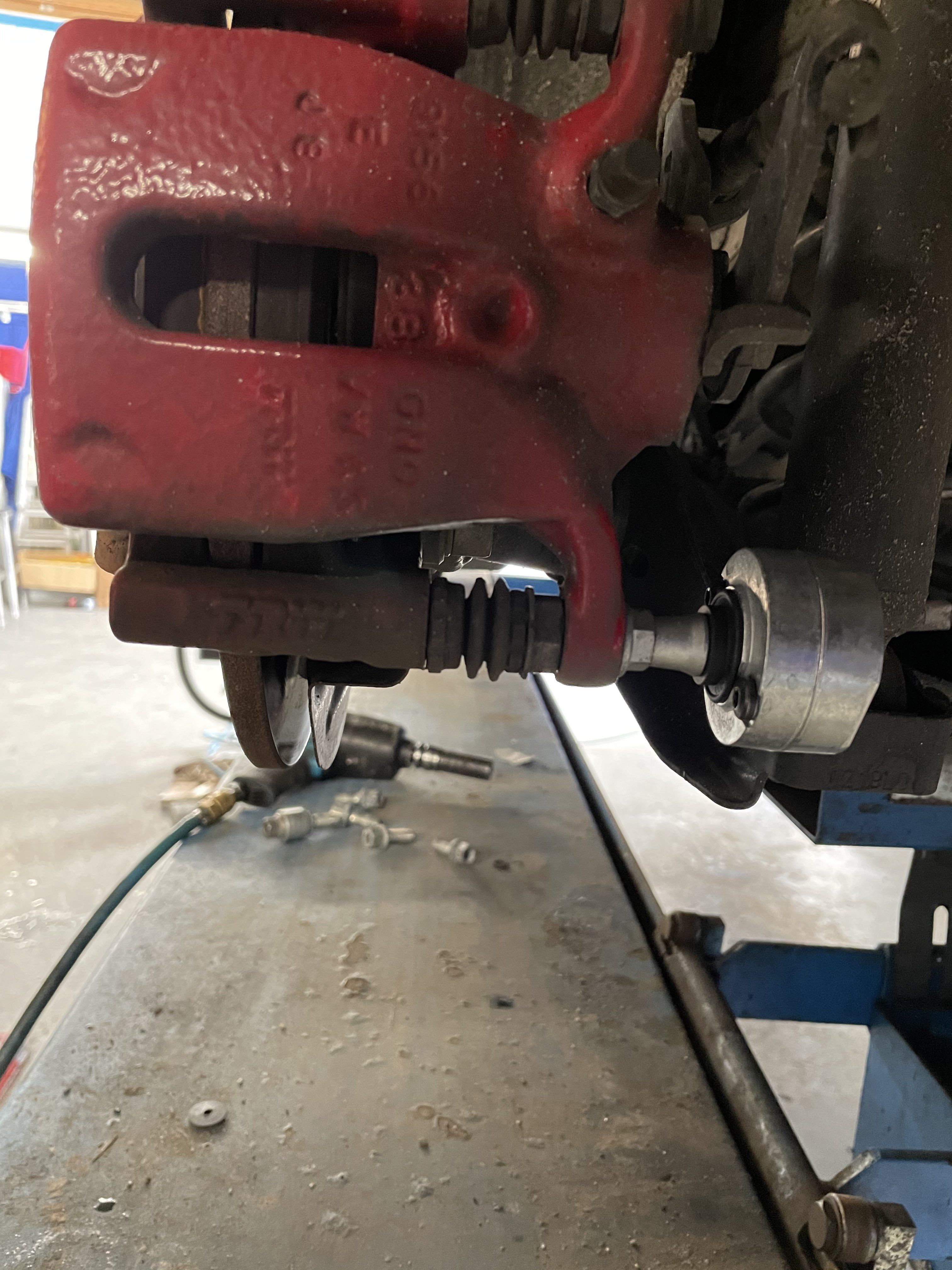

This is a very common complaint. As I understand I am one of the very lucky ones not having this problem. In the Netherlands some have resolved the issue by having placed some demper at the breaking disks.
This is what you'll need: 2x 2Q0615413 trillingsdemper en 2x WHT010011 spec. boutje
And this what it looks like:

Rosinfield wrote: Fri Apr 16, 2021 5:50 am This is a very common complaint. As I understand I am one of the very lucky ones not having this problem. In the Netherlands some have resolved the issue by having placed some demper at the breaking disks.
I managed to find some shop from which I can order those parts, but before that, do these fit any GTI 2018+? Mine is 2020
