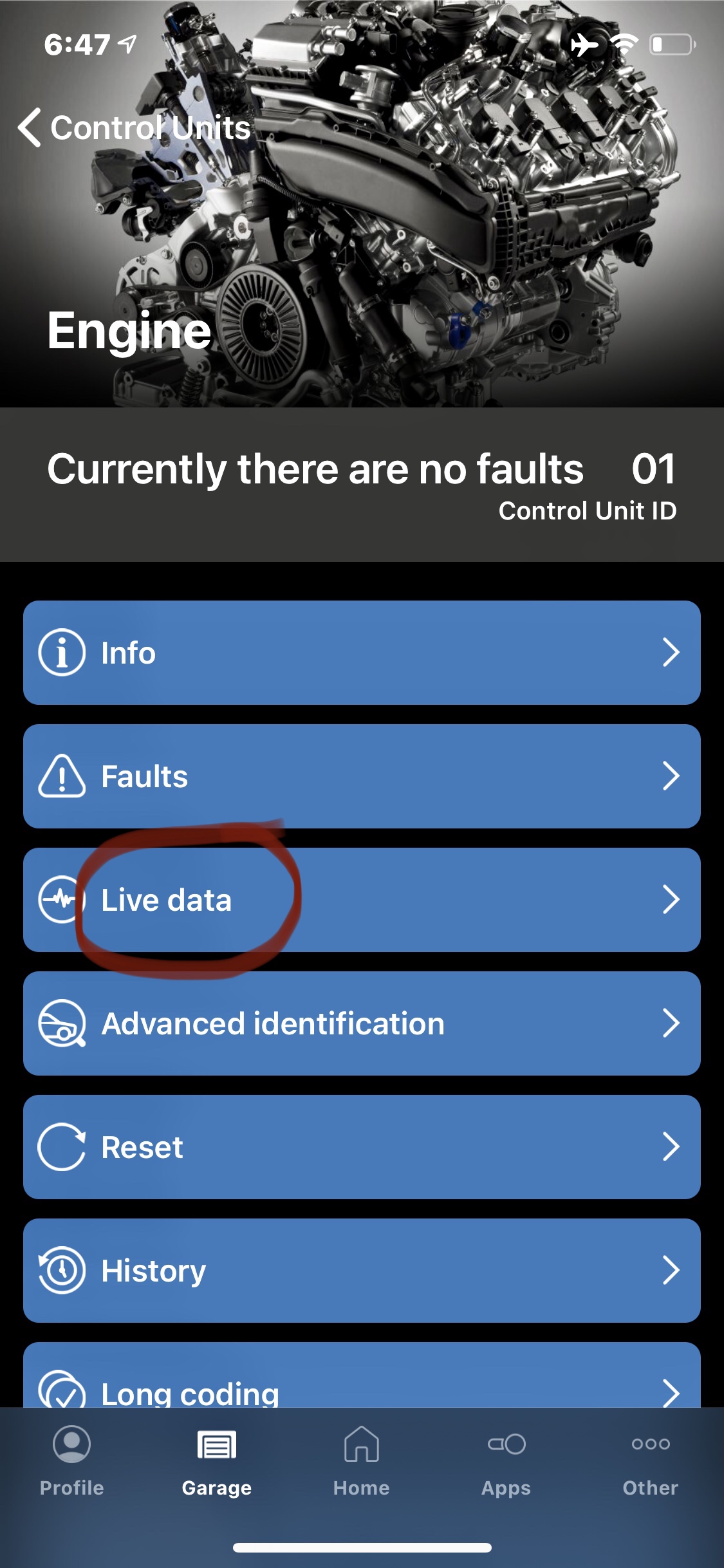

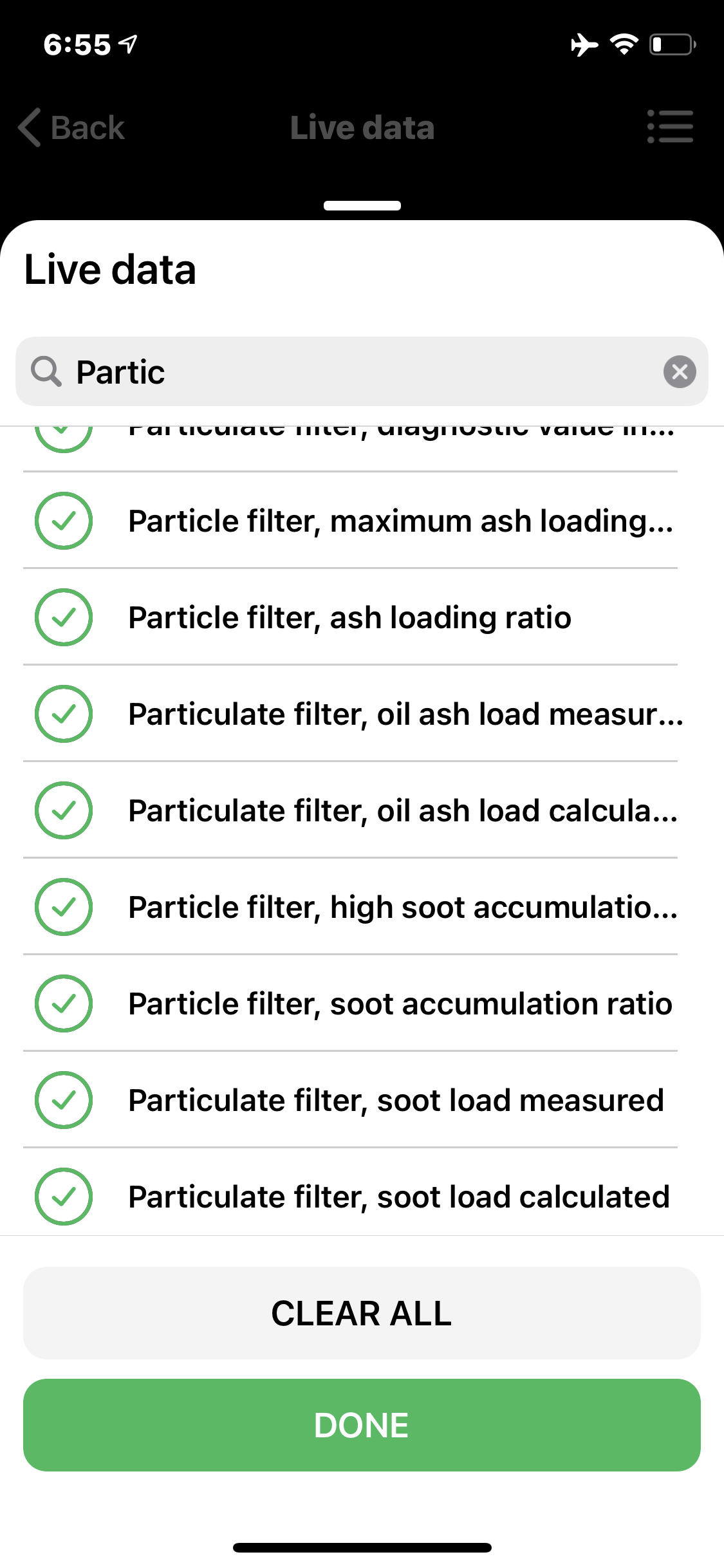

I figured it out after some digging, if anyone is interested you go to control unit, 01 Engine, live data, then tick all the boxes you want the data for. My car is 19% full & has done 6594 miles not sure if it’s had a regen
- 7A061847-4E3B-4441-941F-373115030401.jpeg (474.09 KiB) Viewed 5503 times
- 66EA2F8E-DE0F-42D4-8FF6-E165868F6B8E.png (326.55 KiB) Viewed 5503 times
