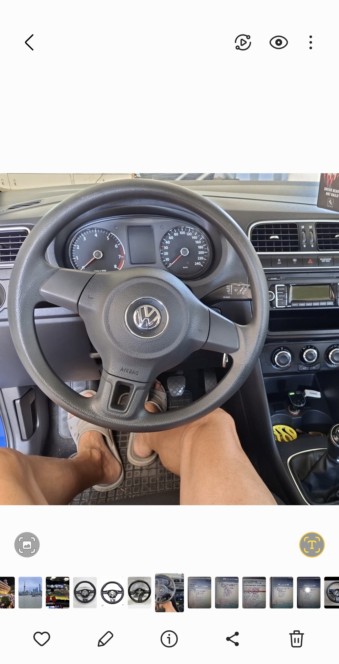

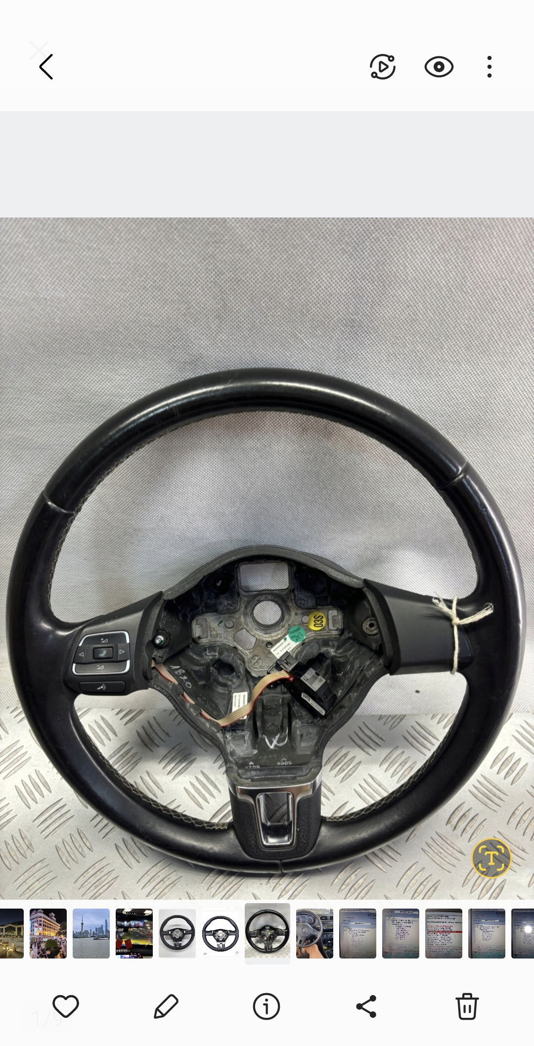

ciclo wrote: Tue Jan 07, 2025 11:10 am Image
Thank you. I think that the airbag change is not needed?
I have this wheel rubber one. And I bought with left side buttons only..
