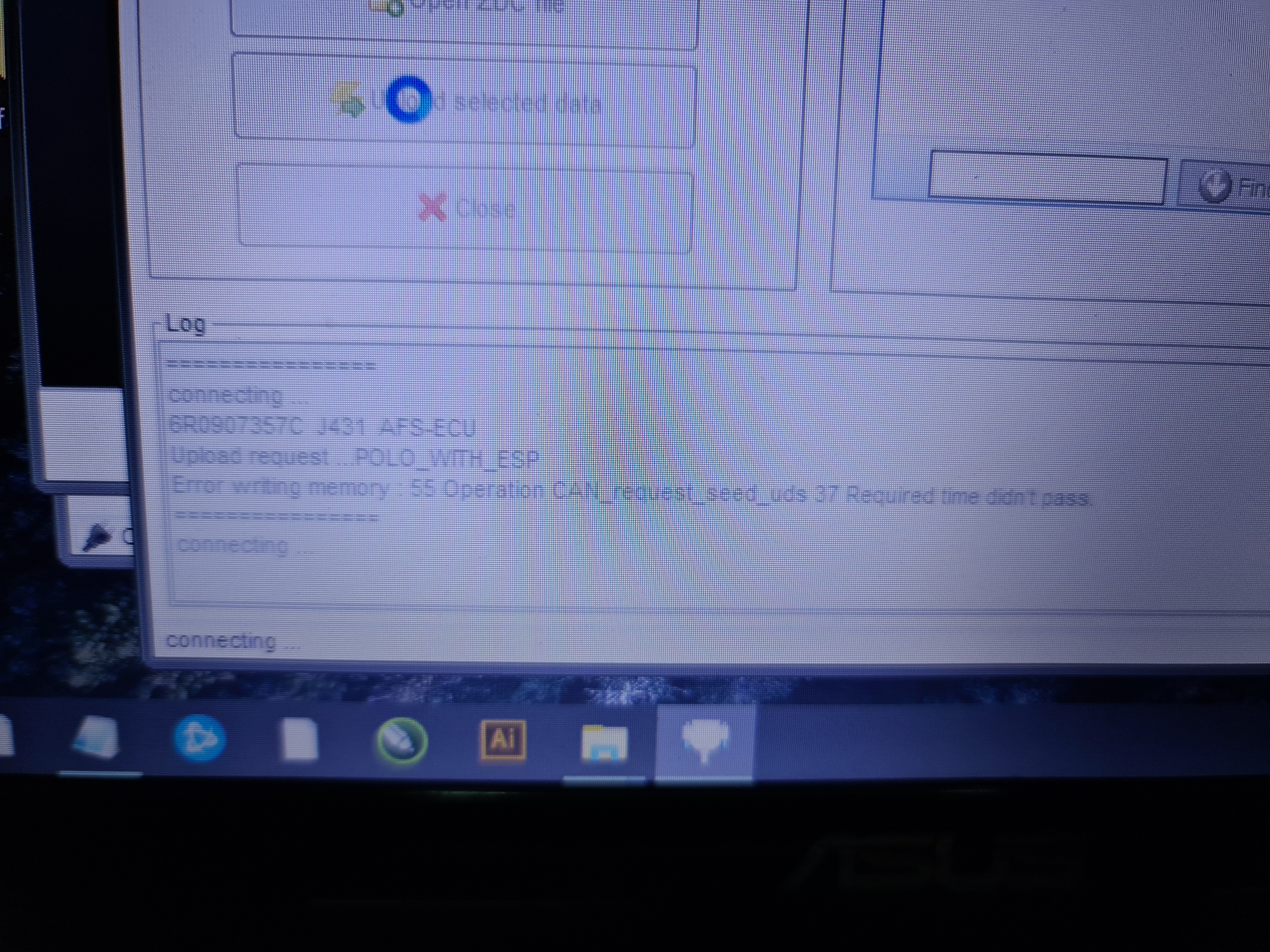

Well i found that my module was used, not new (my mistake) I bought it from alegro.pl, now i found one of your forum posts where you tell a forum member: "Buy a new one for your Polo 6R ... 6R0907357 Z03 (ESP)",

From the VCP file management download this parameterization file:
(for vw Polo not for T6)
And re-parameterize the module with that zdc file.

I also tried parameterizing with VCP - again without success ...... :cry:

ZahariGeorgiev wrote: Tue Nov 09, 2021 6:59 pm I also tried parameterizing with VCP - again without success ...... :cry:
I guess you would have to find the appropriate flash file (extremely difficult) to flash your current module and then load the TinyQ parameters,
or a second-hand module for LED headlights.

After reading that description in drive2.ru, my module for headlights has to be: 6R0 907 357 C Z09 right?
Posts: 8932
Re: 6C Full LED Headlights number
Yes, this control unit must be very common in India, it has been used in the POLO 6R IND since 2015.
patil
Posts: 577
Post by patil »
Yes, as Master mentioned in the above post, 6R0 907 357 C module is installed from factory in Polo 6R sedan ( Vento) and not in Polo 6R hatchback. VW never gave led or bixenon headlights in Polo 6R hatchback in India. Only led headlights is provided in Vento highline plus model only.
Below is the factory headlight range module with factory coding in Vento IND (RHD).
I am not sure if the parameter file for hatchback and sedan are same or different. I checked in VCP file management, it contains parameter file for led headlights mentioning Polo, probably for hatchback.
