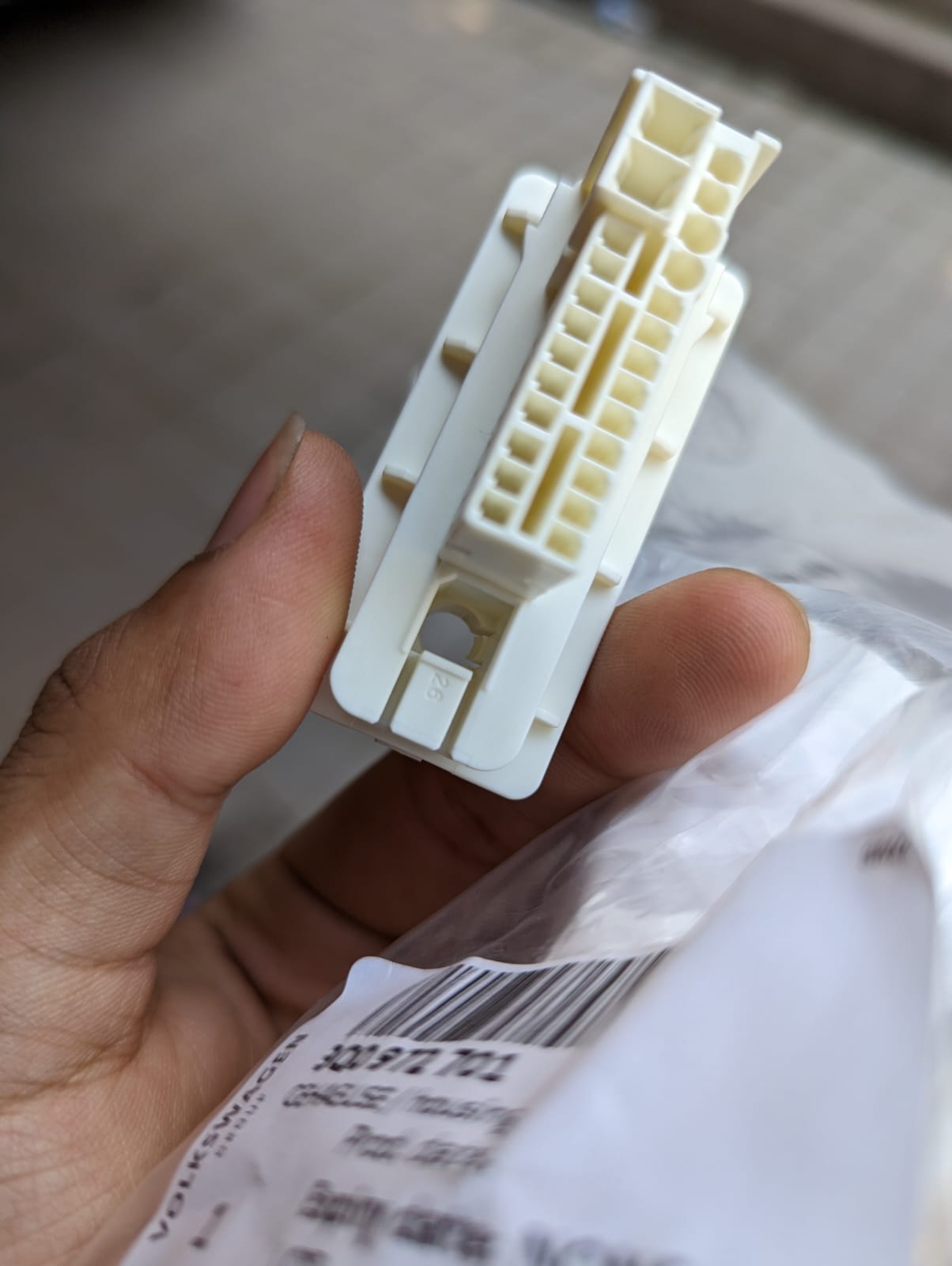

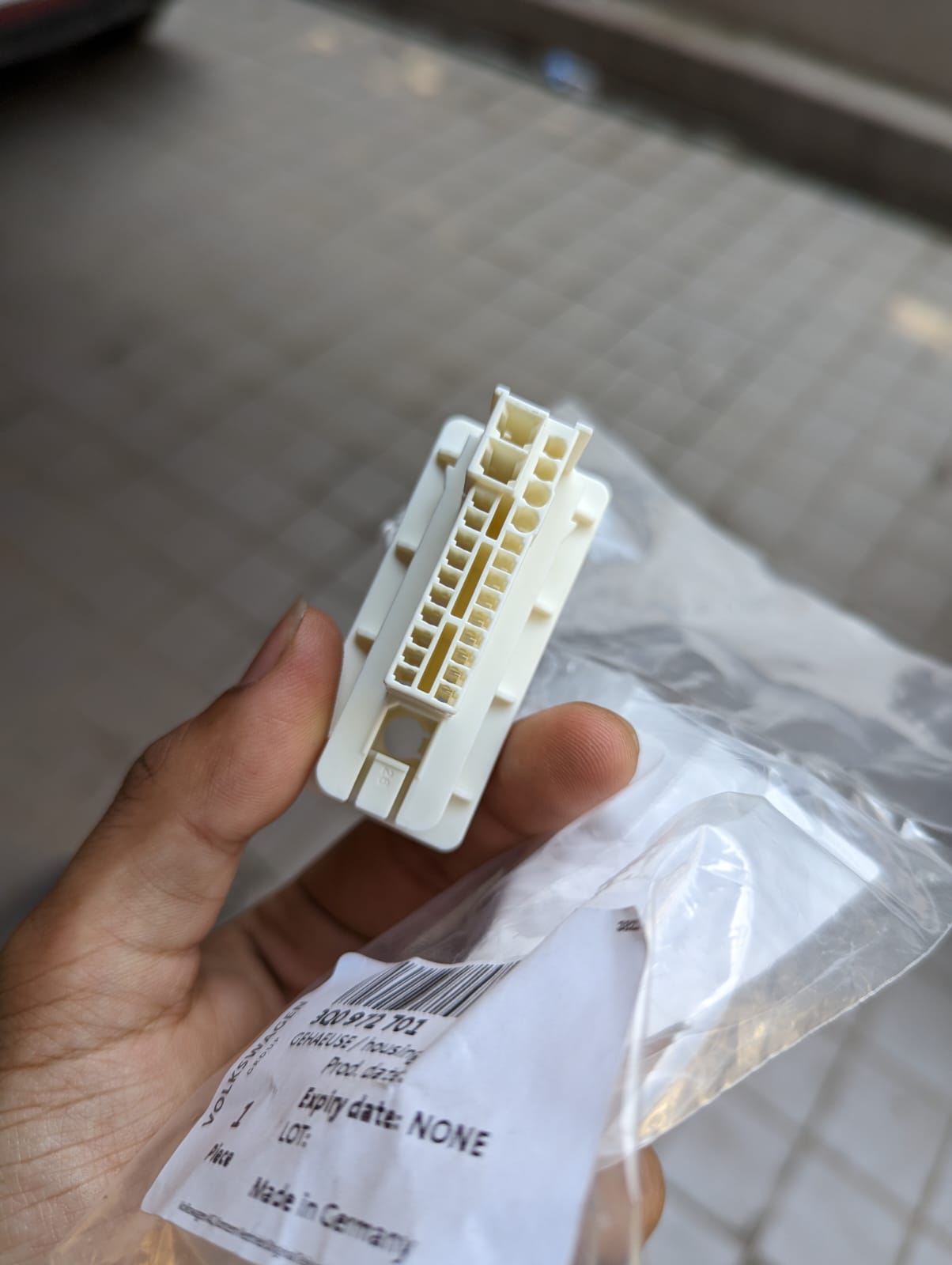

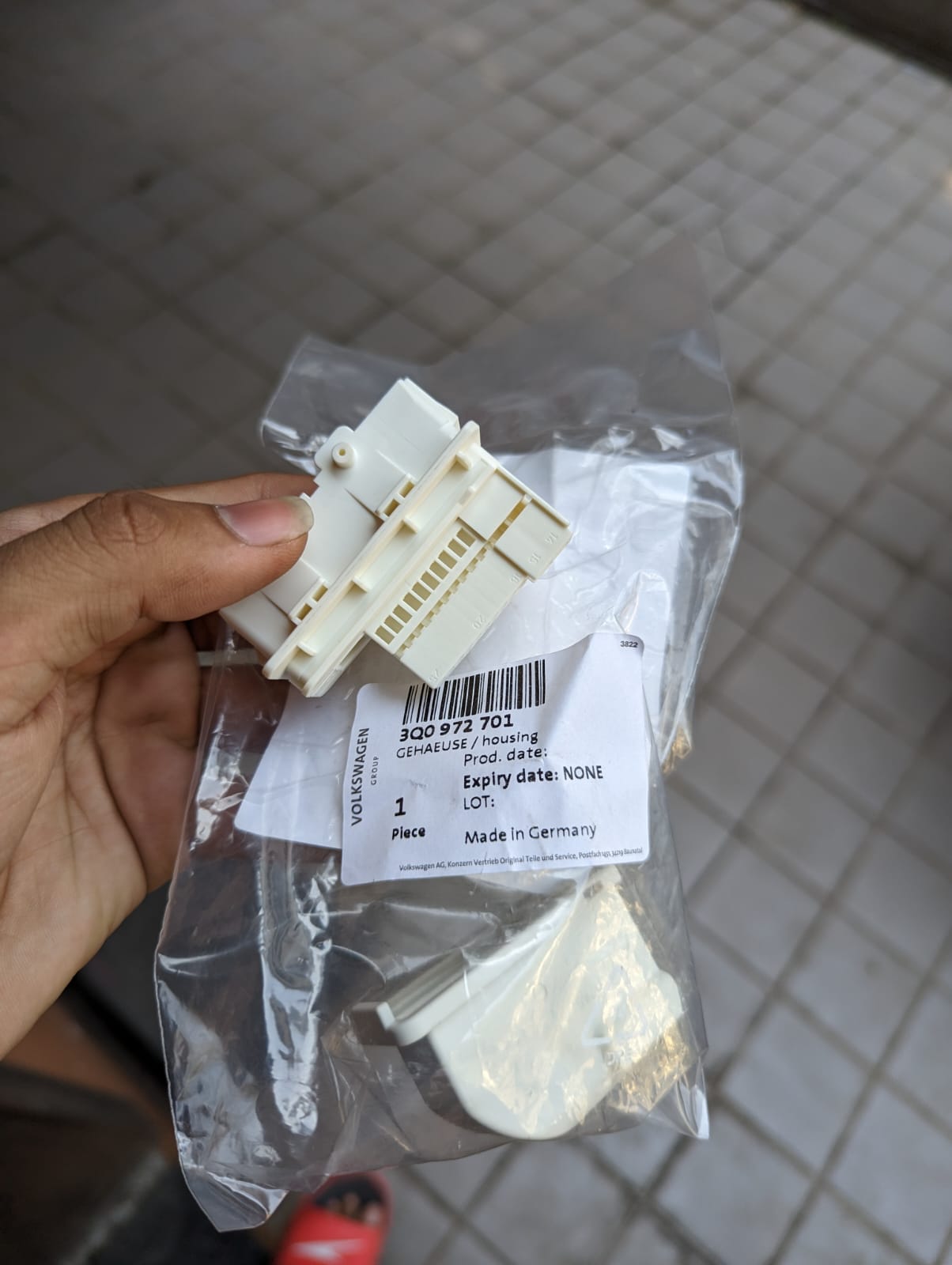

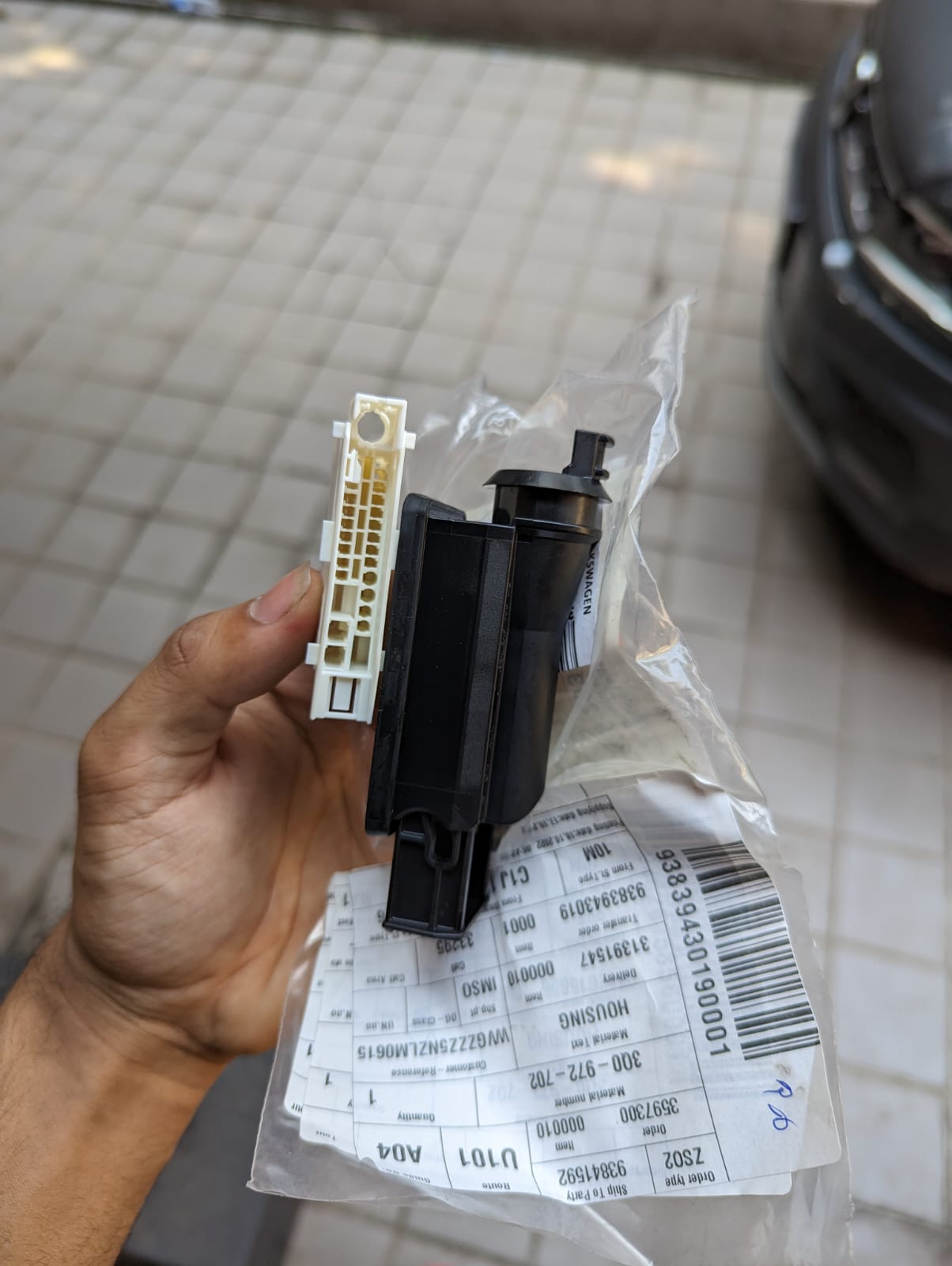

- Wiring looms for module and video feed cables to all four camera's
- 2x 8R0972702 and 2x 8R0972701 connectors for door wiring loom in A pillar
- Remove the door panel and lead the cable to the A pillar connector. I opted not to change the 27-pin connectors to 8R0972702/701 but use MCON in the four available holes
- To connect the module to the car, I took the original +30 cable in the right hand side sill and spliced into it. There, the wire to the RVC compact is already present.

Yeah, I mostly couldn't be bothered with re-pinning all these pins on the door connector and it was a real pain to source the exact correct wires and cables. So I took the easy way.
