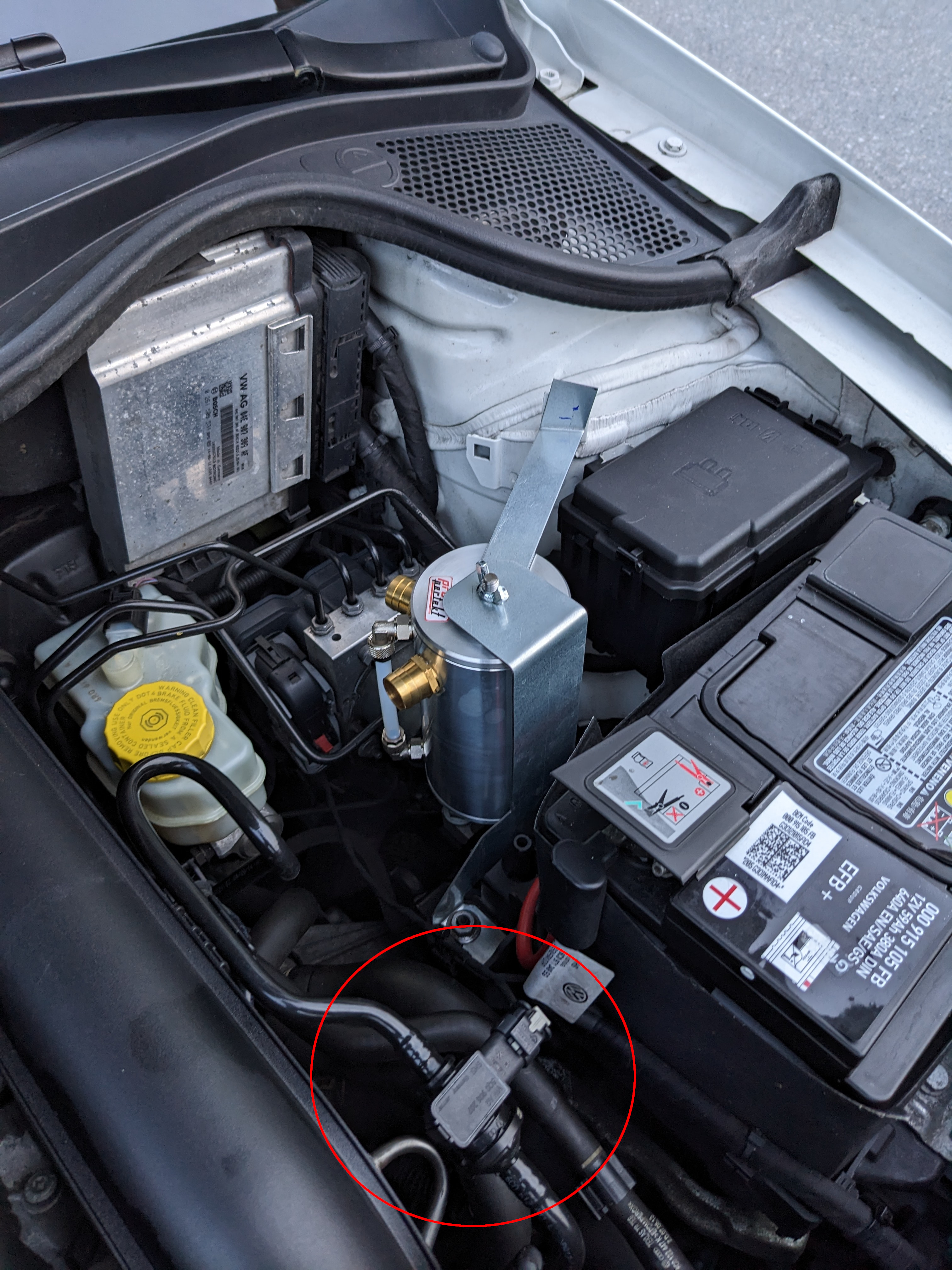

2226
- Posts: 543
Re: EA211 Oil Catch can
Off-topic...
Just looking over pics again.
What is the purpose of this sensor:
It is brake vacuum or booster pressure sensor. Just curious as to what it connects to and what it is used to control.

- Le_Combattant
- Posts: 511
- Location: France
You are right, It is brake vacuum line
2226
- Posts: 543
lol well yes, it's a vacuum line. But what's the pressure sensor for?
Can't quite tell from the option codes applicable to CJZD equipped vehicles.
- Le_Combattant
- Posts: 511
- Location: France
Brake Vacuum Pipe Tube sensor.
Why ?
I don't know
