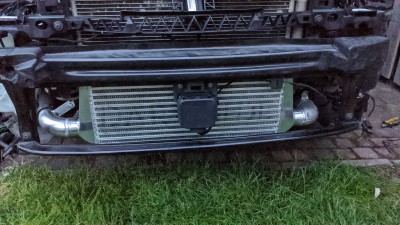

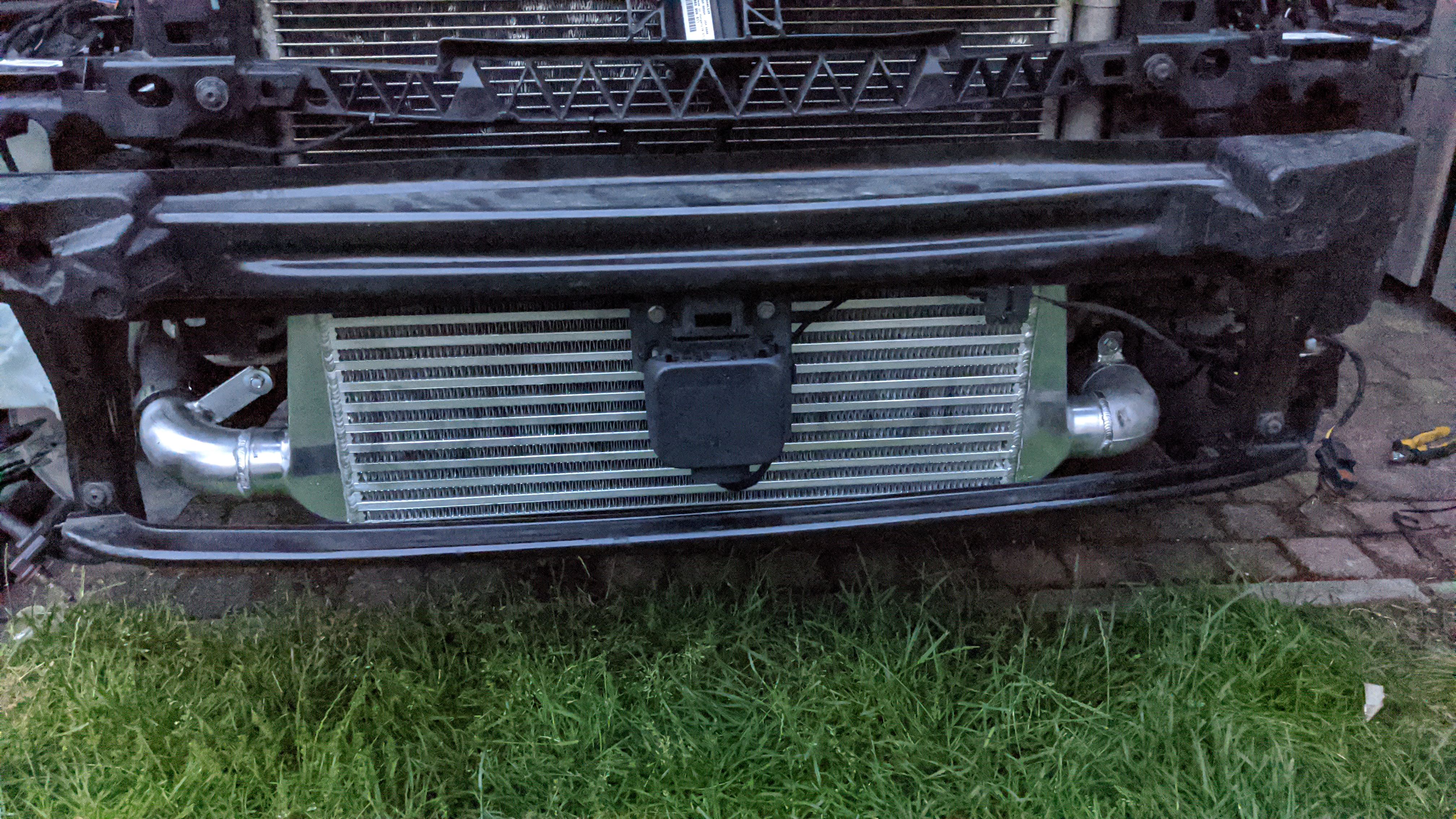

The preparation for the mod can already be seen. No hardware in this picture is to be changed.

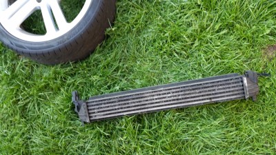

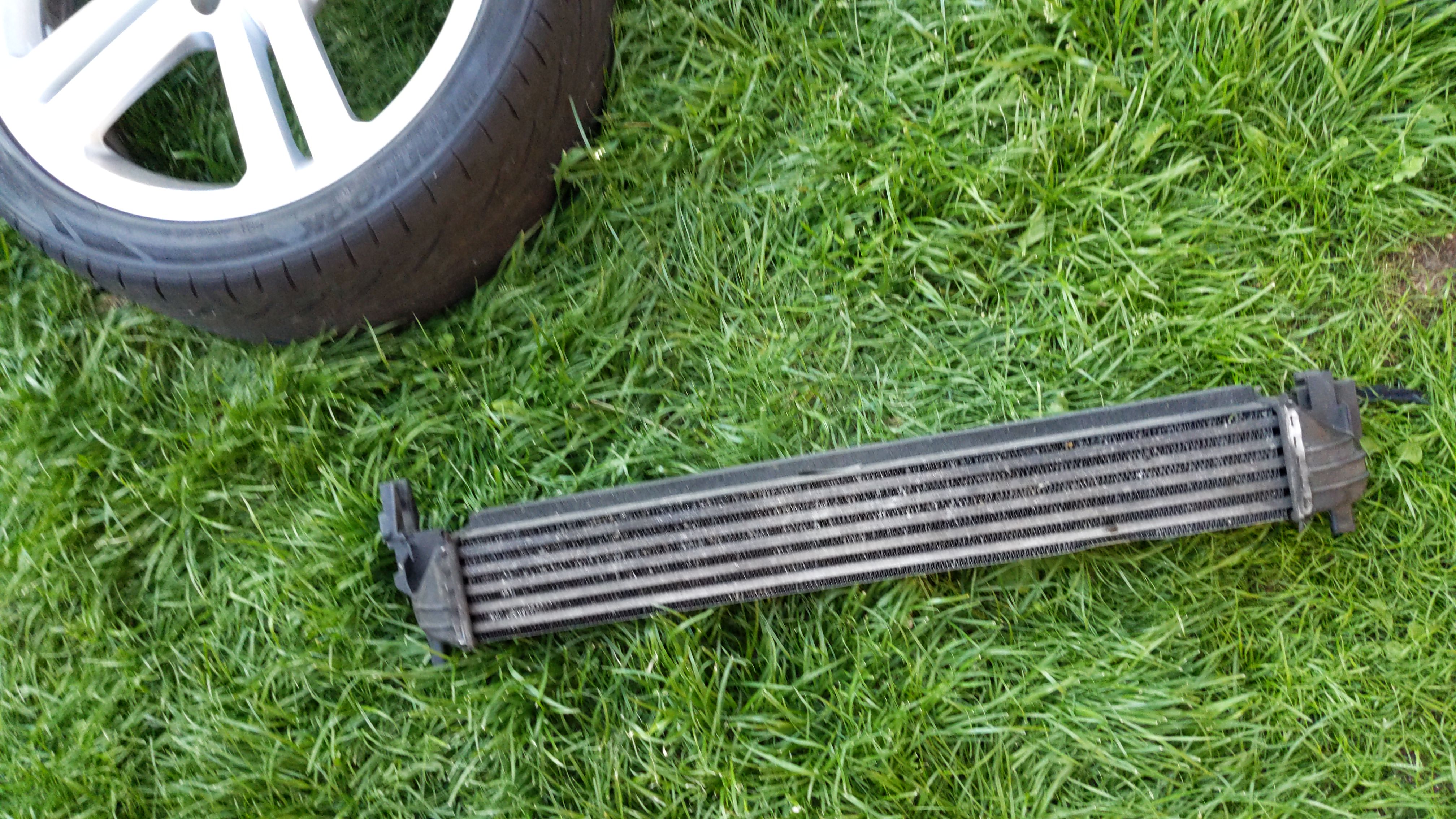

Factory intercooler
Of course you don't want to be seen with this...
Darkside intercooler

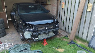

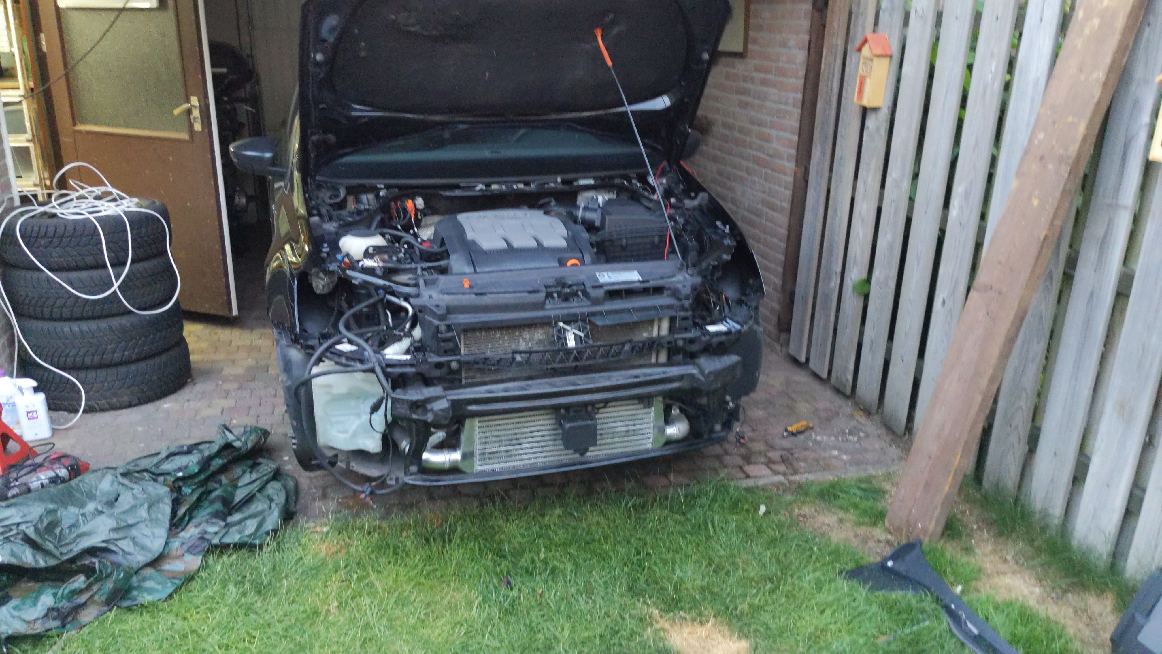

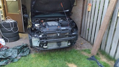

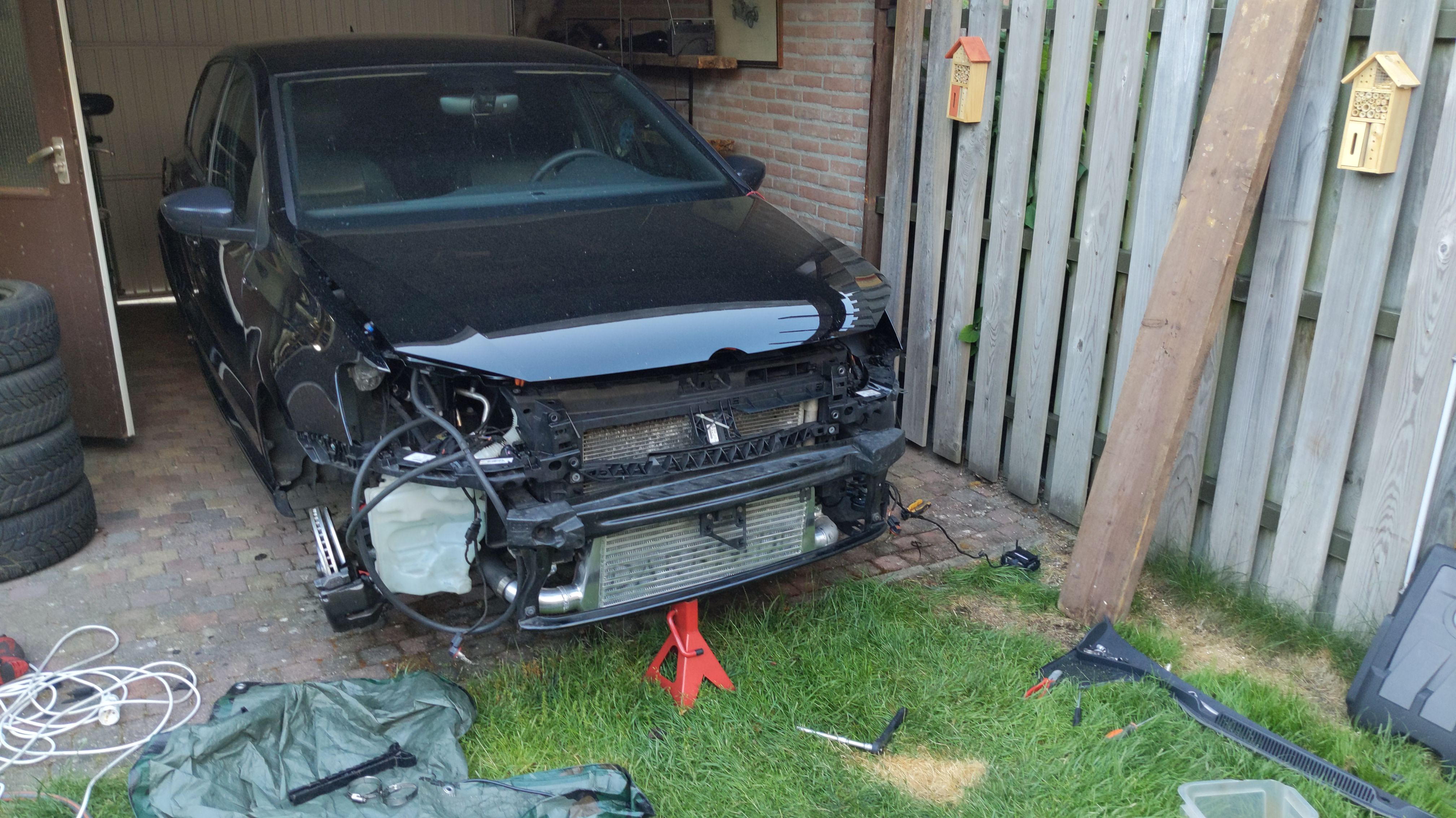

Secretly my car wants to be a pirate
- Posts: 8983
Re: iichels Polo 6R 1.2TDI Bluemotion --> OEM++ R-Line conversion
Ok, without right headlight. ...or do you mean something else?
However, I think our 6Rs are authentic pirates a long time ago (not just shock absorbers, big wheels, painted flames...
Clearly, you really enjoy your 6R.
- Posts: 6695
Yes haha. I removed the entire front of the car, including supporting frames. It was needed to place back the headlight for alignment of the bumper and headlights.ciclo wrote: Wed Jun 03, 2020 4:16 am Ok, without right headlight. ...or do you mean something else?
Afterwards I remove the left headlight (right on the picture) to continue work on the DSG wiring (DSG connector and starter inhibitor relay).
I am absolutely still enjoying my 6R(s), in two weeks the Rosa-Line will have its 9th birthday.However, I think our 6Rs are authentic pirates a long time ago (not just shock absorbers, big wheels, painted flames...).
Clearly, you really enjoy your 6R.![]()
It's funny we still call it the Rosa-Line, even though we broke up almost two years ago.
There is always more potential to unlock in a car and there is always more things to learn.
