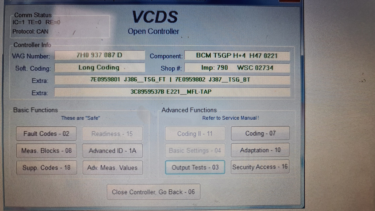

I took a picture of the original BCM encoding before starting work.
A0A0303A0E612433802848102C2B8C550090430F60040000300000000000
https://drive.google.com/file/d/12fYUeo ... sp=sharing
I don't have any LED lighting, only original VW head lamps.
Later, I will check all the lighting and let you know how it works.

Address 01: Engine (J623-CAAB) Labels:. 03L-906-022-CAA.clb
Part No SW: 03L 906 022 CD HW: 03L 907 309 K
Component: R4 2,0L EDC X41 8732
Revision: 26X41--- Serial number: 00000000000000 CVN: F783C549
Coding: 0111401A232400080000
Shop #: WSC 00000 790 00000
ASAM Dataset: EV_ECM20TDI01103L906022CD 002012
ROD: EV_ECM20TDI01103L906019AM_002.rod
VCID: 69D908A38879EBC1F5-803C
VINID: 9E606AAAA1D8A9260020114114D4563869

Address 09: Cent. Elect. (J519) Labels:. 7H0-937-08x-09.clb
Part No SW: 7H0 937 087 D HW: 7H0 937 087
Component: BCM T5GP H+4 H47 0221
Revision: BO047001 Serial number: 0347 176100917
Coding: A0A0303A2E212033002808102C2B8CD40080430F60060000300000000000
Shop #: WSC 02734 790 12345
VCID: 356194D39C417F21A1-8060

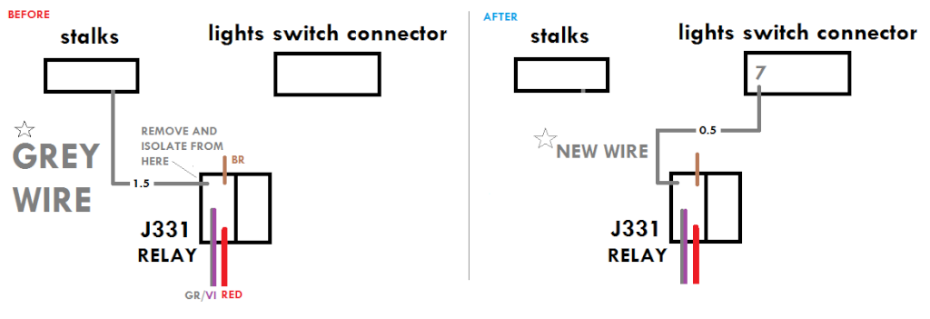

- Posts: 6695
You probably have a low beam relay that operates the low beam. It is not controlled by your BCM.
This is an image that ciclo made for the Polo 6R with J331 low beam relay.
I suspect it works the same on your Transporter T5.1, perhaps the colours are different. I think this installation will solve (part of) your problem.
If you flash your high beam, will it illuminate a separate high beam light or will it 'click' the bixenon lens?
When i flash with hibeam, lowbeam stops working
