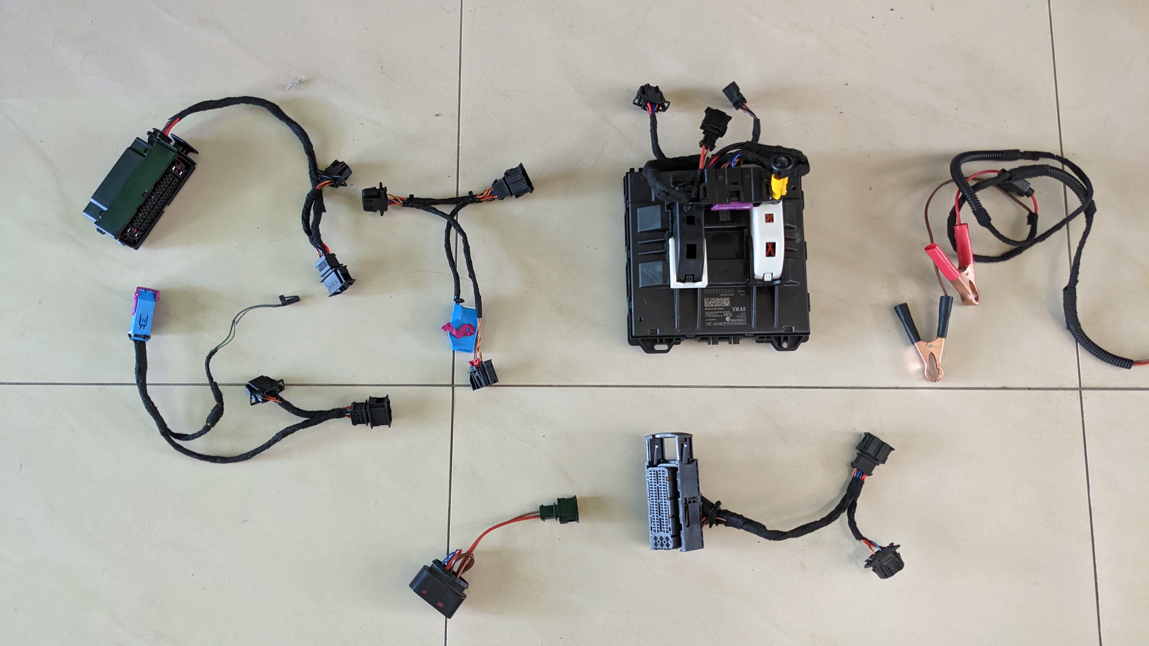

My new modular canbus bench :-)
Re: iichels Polo 6R 1.2TDI Bluemotion --> OEM++ R-Line conversion
Does anyone know anything about a 7E0 BCM not being able to read the 02 address of the gearbox?

I have a suggestion. It is because of T73b/37 pin. On 7E0 it become LIN bus but gearbox is still could use K-line. I think you shoud try to pull out this wire from BCM socket.

Thank you for your suggestion. However, T73b/37 is not connected on my car at all.
In 'early' PQ25 cars, it was indeed K-Line. But are you sure about /37 being linbus? Wasn't that /36 for the MFSW?

If I am not mistaken T73b/37 on 7E0 BCM is LIN bus for smart battery terminal.
Would you suggest to connect the smart battery terminal to T73b/49 like on bcm 7H0?
