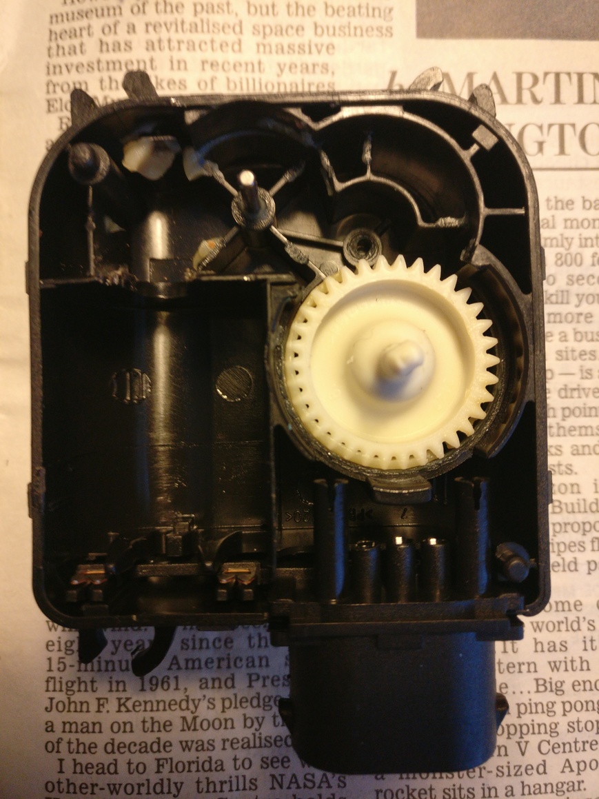

Surgery complete.
One thing to note is the connector assembly and pot can be lifted out together (see photos). I only discovered this after leveraging out the pot on the old motor. I used a marker pen to indicate the position of the gear on the original casing and ensured it was realigned on assembly with the new parts.
Reconnected the plug before reinstalling and checked operation. It appears the motor only goes from cold to open and nothing in between (at least I cannot hear it move in between those extremes). Is any kind of calibration needed?
Replaced the original large bracket without too much difficulty (the new one was not suitable at all).
