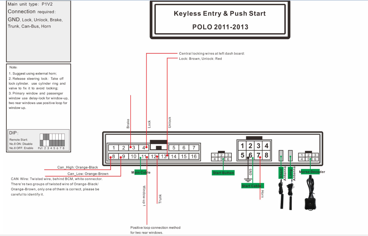

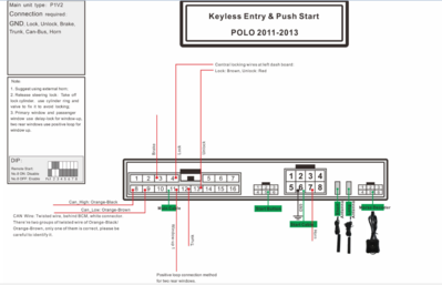

can you please check this diagram and guide me? is this safe?
but now after reading your topic. again KESSY madness bite me. :D will really consider this.
Posts: 6687
Re: retrofitting kessy to the Polo 6R
it's a bit difficult to say whether it works. what happens to the immobiliser? what happens to the original keys? what signal does it use for authorization?

iichel wrote: Thu Mar 29, 2018 2:55 pm it's a bit difficult to say whether it works. what happens to the immobiliser? what happens to the original keys? what signal does it use for authorization?
org key stay in car with coil
this is typical solution you can buy in china
Posts: 6687
yeah i figured so. not a good solution then.

If I ever plan for KESSY I will go your way. Source all OE parts n do. Not the PKE system. This kit I bought in temptation and hurry.
In above kit One original key should be kept in car always. We have to remove immo reader from key cylinder insert original key in it and hide inside the car near steering column because immo reader wires.
This kit comes with 2 seperate remote keys. We have to use that. This key will send authorisation codes to module inside car. If we go near car 2-3 meters car unlocks, same way if we go away from car it locks.

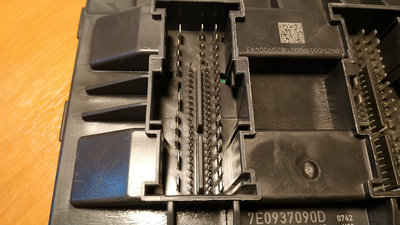

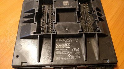

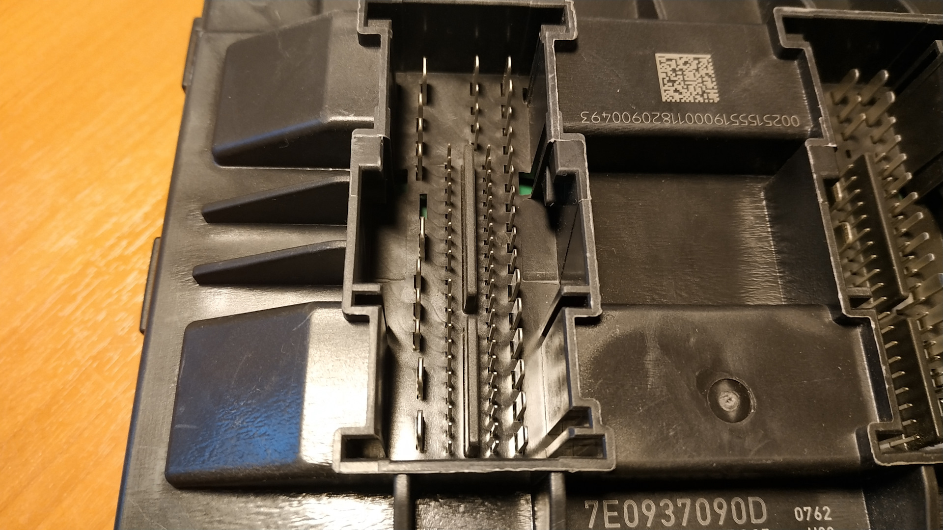

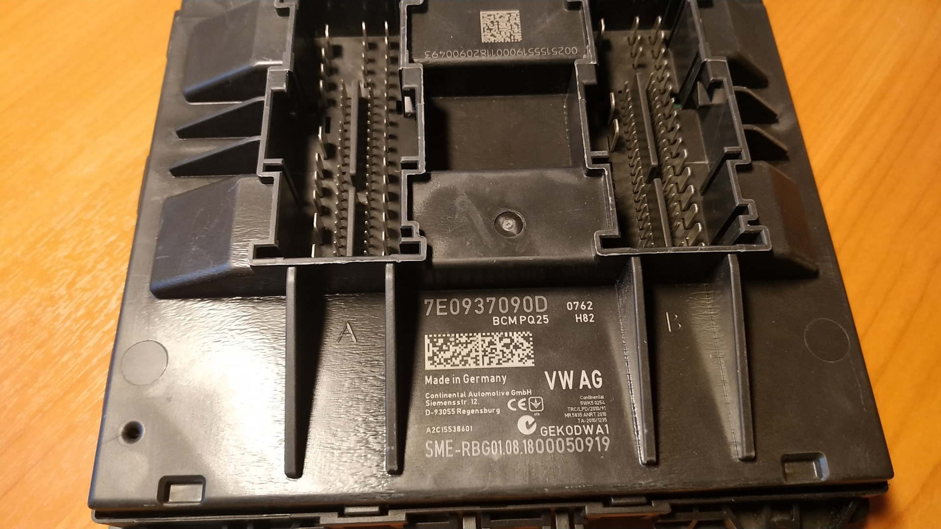

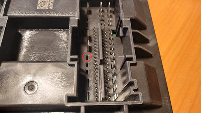

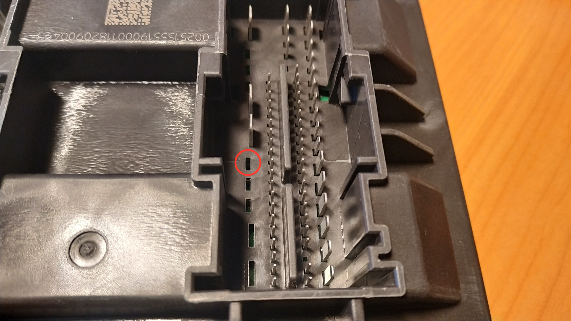

Hi Iichel,
Thanks for this input. Couple of questions.
1) Did you happen to make a wiring diagram for this?
2) I am getting a 90D BCM (pics attached) and there are some differences from your BCM pins ( viewtopic.php?f=56&t=69547&hilit=KESSY#p518793). I wanted to check if they would affect KESSY functionality. More so would you happen to know what would the highlighted pins which are different affect.
3) I have made a sheet to source the components. I have PMed the link to you. Let me know if any of the components need to bought new/used from existing car for compatibility. Or if they need to be older (manufacturing year issues).
4)Do the door handles need to be from a donor vehicle for fitment or electrical/ radio compatibility issues?
5) Now, the immo components (5K0905861C, 5K0959434E, 6RU920860D) I am still yet to find someone to do it. Could you tell me what tools you used for this? I am open to other options if there is someone you can put me in touch with.
Any other inputs are welcome and appreciated.
Pranay

Any inputs are appreciated. I am primarily wary of the parts requiring immobilizer coding. Before beginning to source parts for this, if anyone can add thoughts/suggestions on immo coding and challenges, it would be great.
