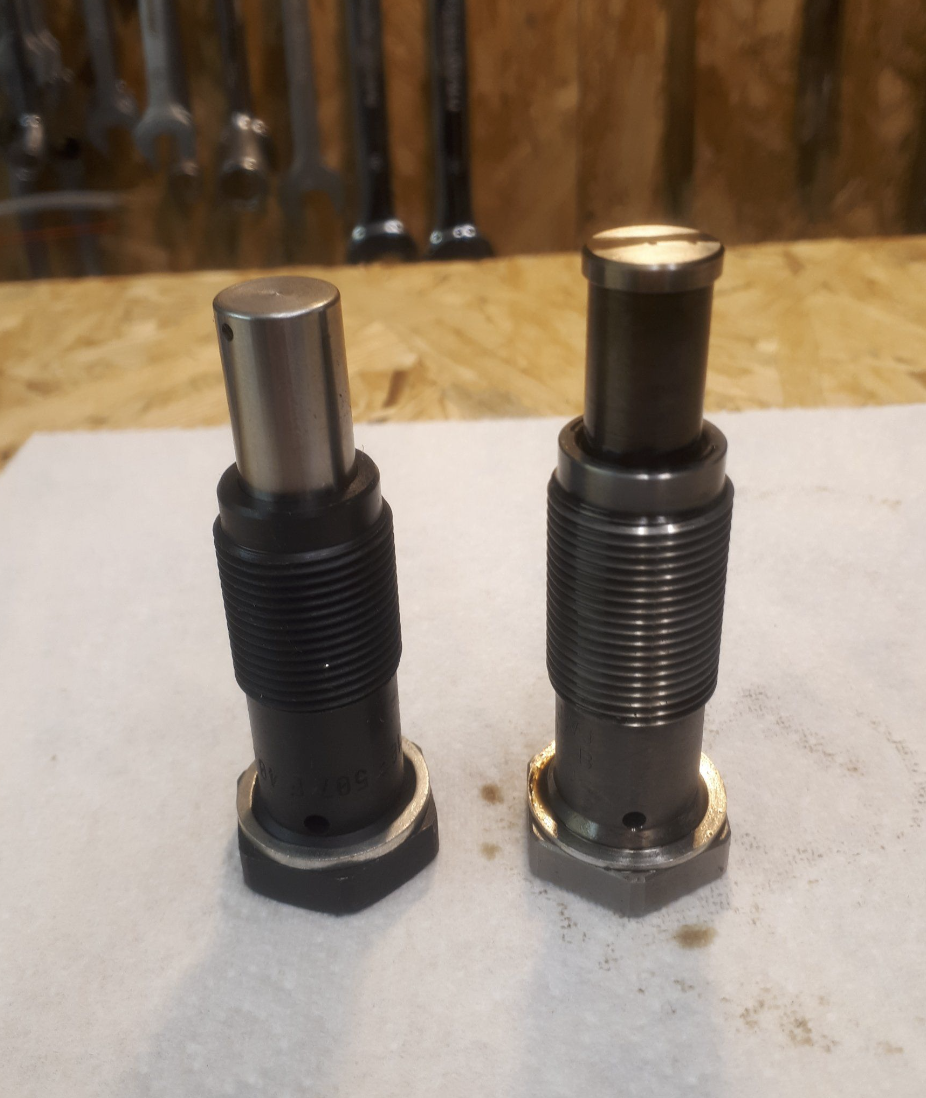

Has anyone tested this - using the older timing chain tensioner on the newest chain set after 150.000km? Jay-jay what's you opinion?
The older chain tensioner is a bit longer than the newer one. As chains wear, they get elongated. I was thinking that after 150.000 km on the new chain set, if you put the older, longer tensioner it will compensate the slack, would this be a viable option?
I hope you all understood what i'm trying to say here.. :D

I don't know if somebody ever tried this, but I'd personally would be afraid of doing it.
I'm not an expert, but something makes me think that the spring inside the piston of the old tensioner version would be too much compressed and it could not work properly or (in the worst case) it could brake, with the consequence that the tensioner could not be able to tension the chain at all.
I remember of a friend who worked in a spring factory and he once told me that springs have a specific load index and a precise compression resistance. Once you surpass the compression threshold, the spring loses almost all of its resistance.
Plus to that, I'd consider also if the new position of the tensioner chain guide could interfere with other moving parts...
It's something that would need engineering knowledge (that I don't have) and the balls to try it on the engine.
If someone has ever done this mod, I'd be more than happy to read their experience. :)

Good to hear your opinion also :D Yeah I believe there would be a risk. I'm planning on doing the CBZB chain set replacement during summer, bought the newest kit with the oil pump chain, i'll replace the serpentine belt also.

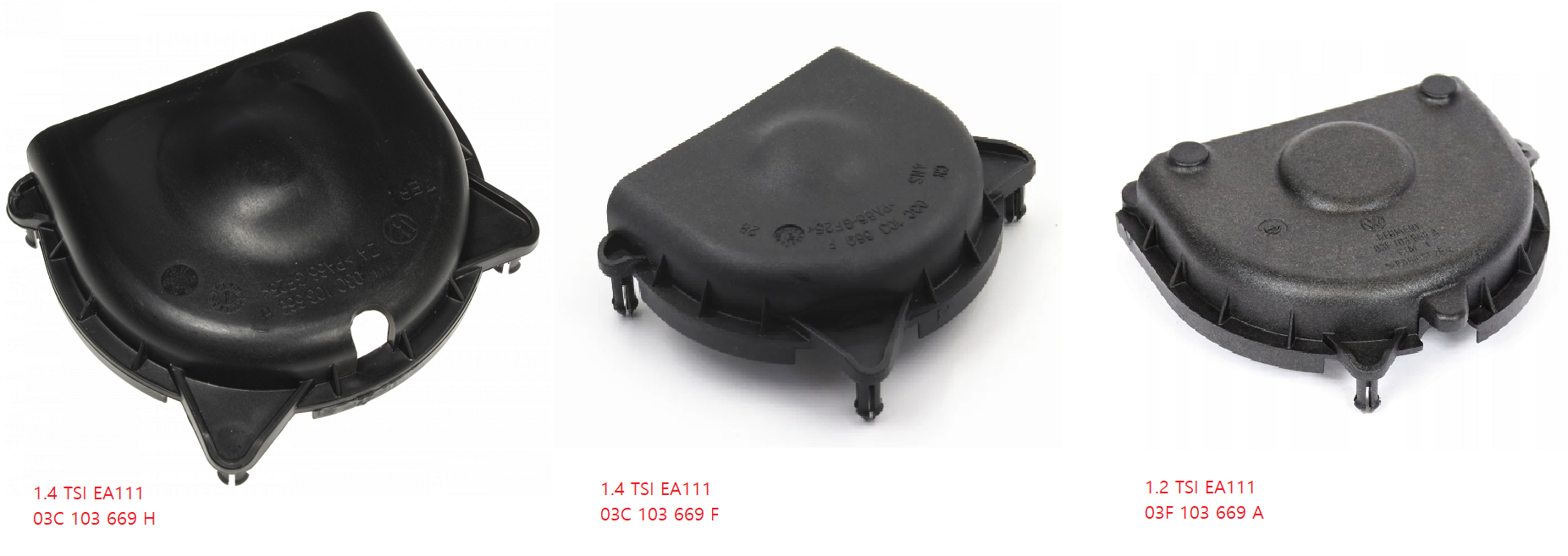

Here's also another interesting thing i've come across during researching - there is the plastic oil pump chain cover, where one user drilled a hole into it (he says it helps with lubricating the oil pump chain during startup, the oil also gets guided towards the timing chain)
The 1.4 TSI EA111 engine has a similar oil pump chain setup, but there has been already two revisions on the cover. The 1.2 TSI has only one revision. The newest 1.4 TSI revision has a hole on the bottom, and I think there is some reason behind this? Lubricating properties I guess? I'll put a picture here, what's your opinion on this Jay-Jay :)

Judging by the photos you uploaded, it looks like the 1.2 TSI oil pump chain cover already has sort of a hole at the bottom. To me it looks like it's there for allowing the oil to easily go down in the sump when you shut off the engine and avoiding oil emulsion.
But I'd honestly let the experts speak.
