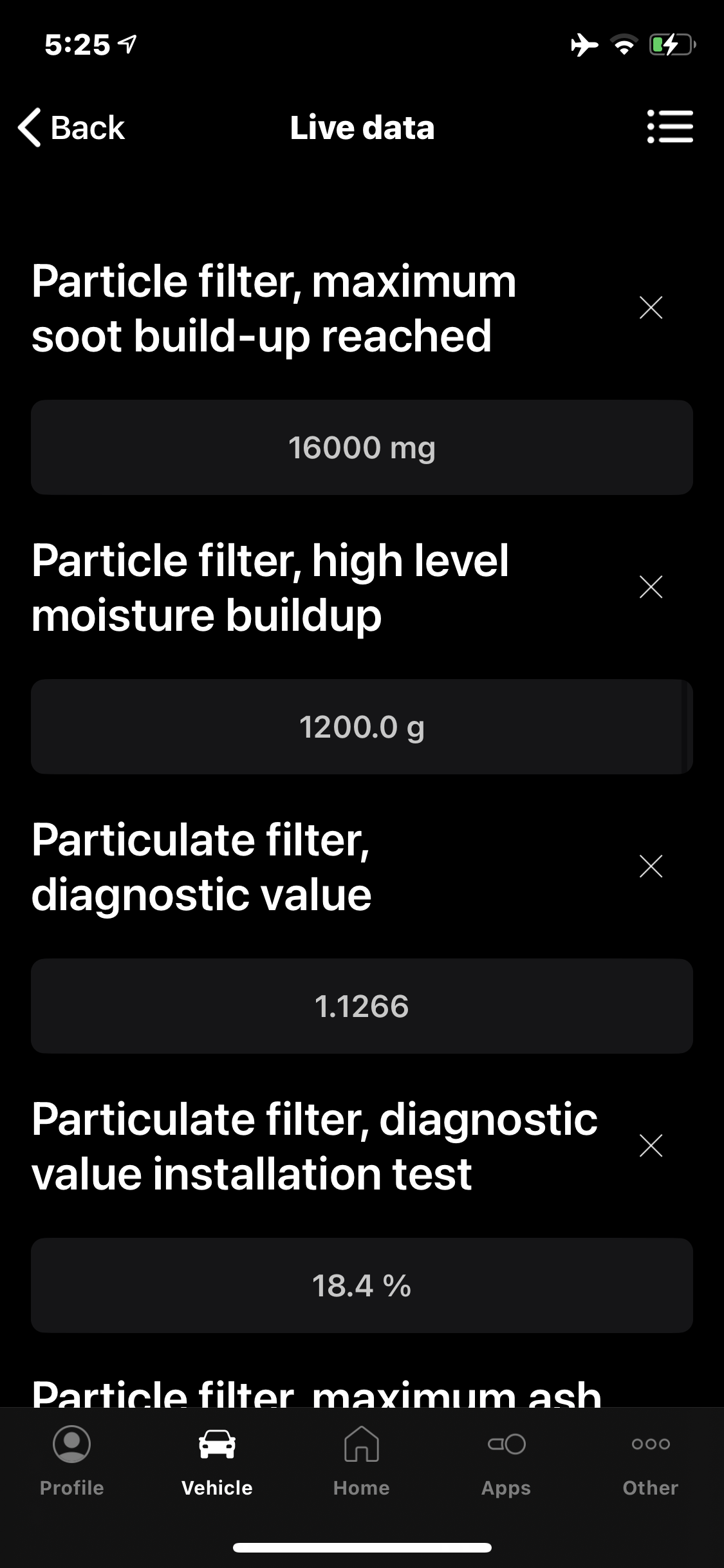

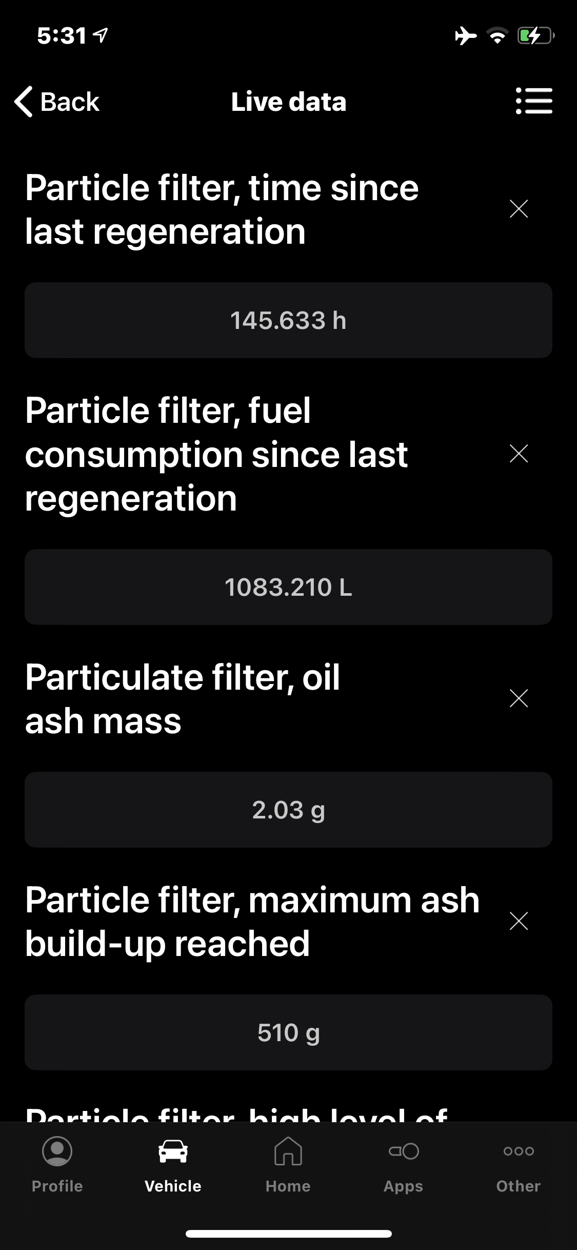

After 40miles since I last checked it’s dropped to 18.4% it was 19.2% driving style was mixed, apparently the last forced regeneration was 145.63 hours. Are these the correct readouts?
- 9FE05B64-38C1-471C-9A90-54047734C94D.png (404.35 KiB) Viewed 12208 times
- F033759C-2FFA-458C-8262-266C596E888F.png (411.2 KiB) Viewed 12208 times

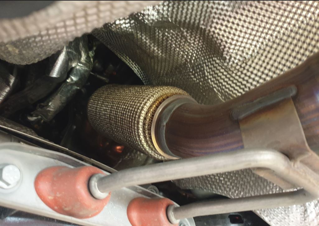

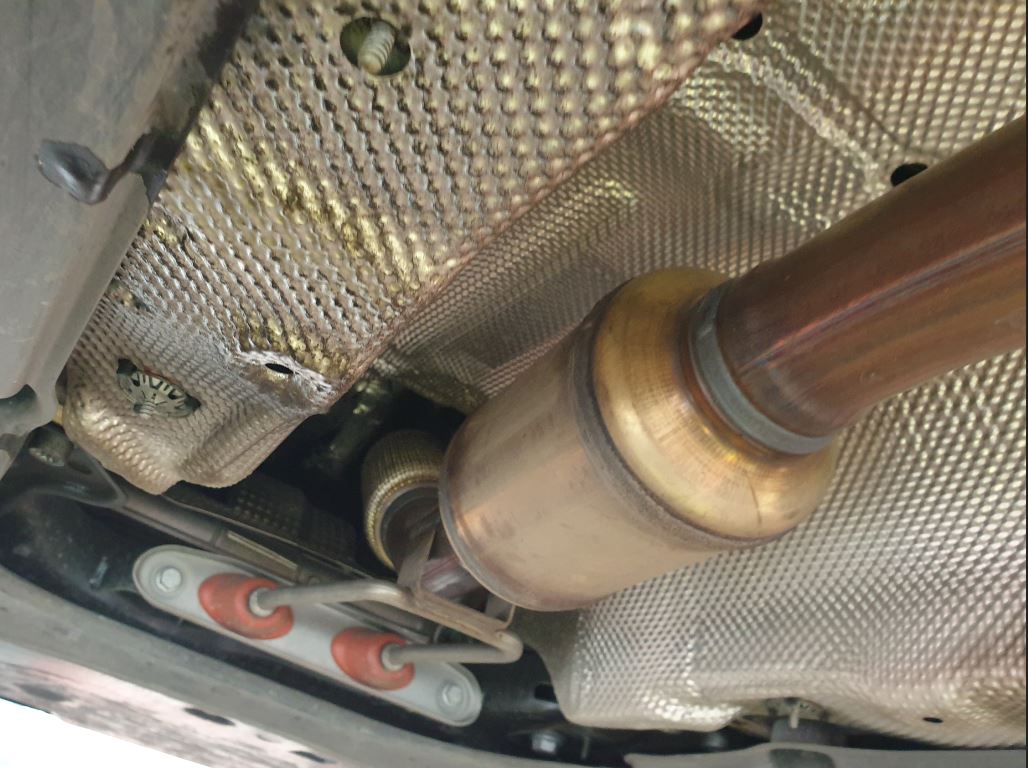

I have yet to experience what you fellows are all talking about which made me wonder if this vehicle of mine has a GPF or not, its a 2019 (May) model. Today I had the opportunity to look under the car since it was in to rotate tyres. Please take a look at these images and let me know if the GPF is equipped:
Thank you.

Yes, the bulky part in the second image is your opf/gpf.OomStu_ZA wrote: Tue Dec 01, 2020 2:36 pm I have yet to experience what you fellows are all talking about which made me wonder if this vehicle of mine has a GPF or not, its a 2019 (May) model. Today I had the opportunity to look under the car since it was in to rotate tyres. Please take a look at these images and let me know if the GPF is equipped:
Thank you.

That bulk thing in the second photo could be a GPF or a 2nd catalytic converter.OomStu_ZA wrote: Tue Dec 01, 2020 2:36 pm I have yet to experience what you fellows are all talking about which made me wonder if this vehicle of mine has a GPF or not, its a 2019 (May) model. Today I had the opportunity to look under the car since it was in to rotate tyres. Please take a look at these images and let me know if the GPF is equipped:
Thank you.
If you see a "Temperature Sender / Sensor" fixed on the exhaust pipe after the "Bulk thing", then that "Bulk thing" is a GPF, otherwise it is just a 2nd catalytic converter.
On the other hand, check your car's PR Code and look up the exhaust parts on ETKA, then you can be 100% sure if your car is equipped with GPF or not.
But if I remember correctly, all VW sold by VWSA in South Africa are not equipped with GPF up to at least MY20.

As far as I am aware there are no UK polos with 2 cats. Only the 1 so it is most definitely a GPF/OPFho8882000 wrote: Tue Dec 01, 2020 8:39 pmThat bulk thing in the second photo could be a GPF or a 2nd catalytic converter.OomStu_ZA wrote: Tue Dec 01, 2020 2:36 pm I have yet to experience what you fellows are all talking about which made me wonder if this vehicle of mine has a GPF or not, its a 2019 (May) model. Today I had the opportunity to look under the car since it was in to rotate tyres. Please take a look at these images and let me know if the GPF is equipped:

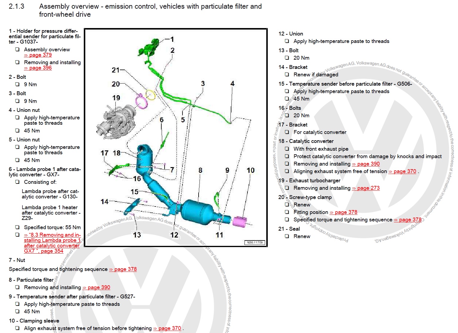

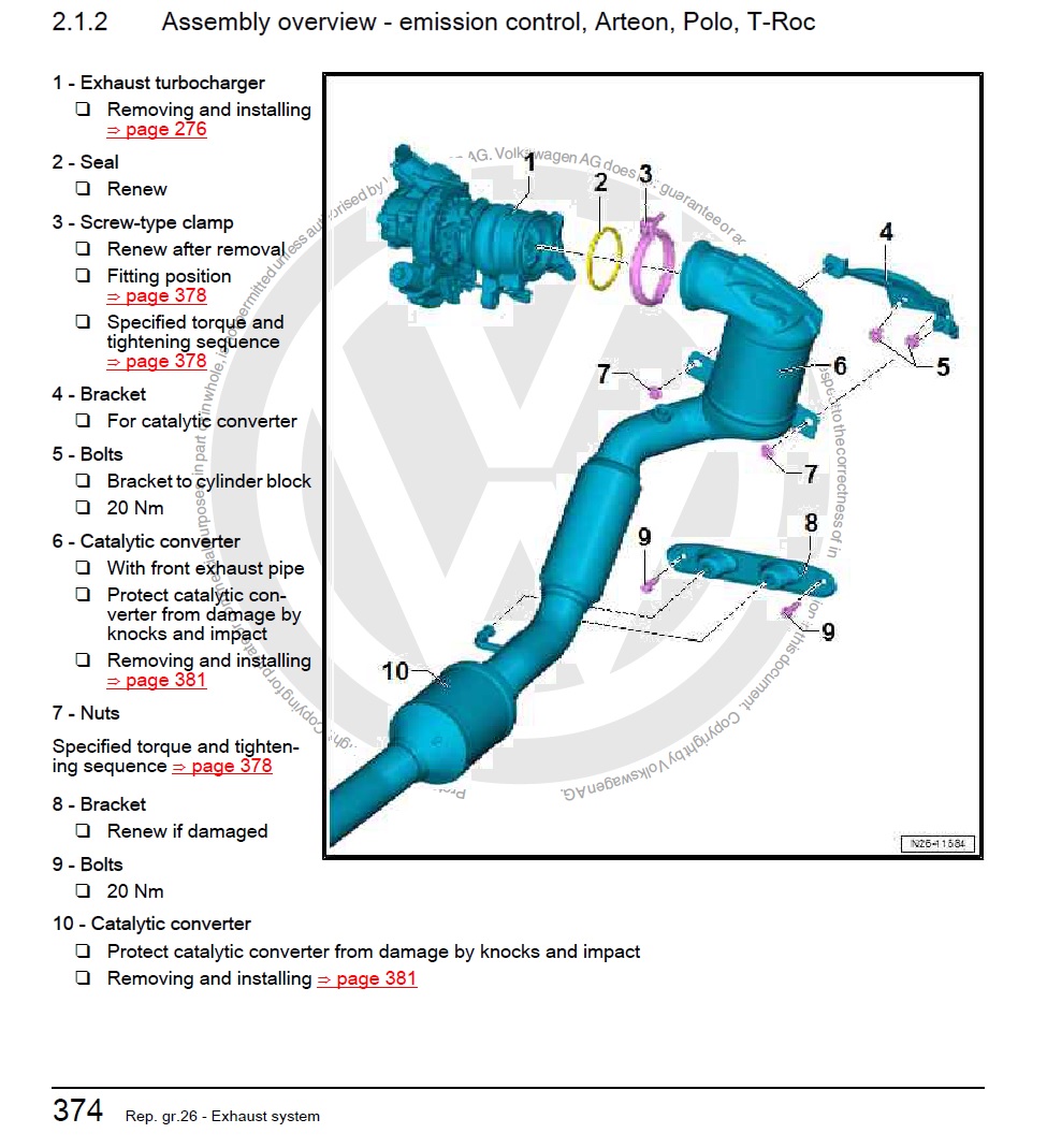

Both me and you are just some guys behind the keyboard on internet, why don't we look at VW's technical drawings and let the official VW repair manual talks.
I captured the following 2 picture from the VW repair manual of the "2.0 l, 4 V, EA 888 gen III" engine, with engine code: CZPA / CZPB / CZPC / DKZA / DKZC.
The following is a picture of the exhaust system without GPF, look at item 10 which is the "Bulk thing" and it is a 2nd catalytic converter, and item 6 is the 1st catalytic converter of the exhaust system:
The following is a picture of the exhaust system with GPF, look at item 8 which is the "Bulk thing" and it is a GPF, and item 18 is the catalytic converter of the exhaust system: So, according to the official VW technical drawings that "Bulk thing" could be a GPF or a 2nd catalytic converter.
Another easy way to tell if you have a GPF or not:
If that "Bulk thing" is a GPF, it should have temperature senders fixed on the exhaust pipe both before and after that "Bulk thing".
But the easiest and accurate way to check if a Polo has GPF or not, is to look at its PR codes and check out the parts drawing on ETKA.

Ja I have a few more images and no where can I see any probes or sensors after the "bulk" thing
I wonder if they didnt leave out the GPF in SA models to keep the cost down locally... since out air pollution isnt a problem for Government.

Your car definitely has the GPF/OPF! The big bulky thing in your pictures is the GPF/OPF.OomStu_ZA wrote: Wed Dec 02, 2020 8:30 am Ja I have a few more images and no where can I see any probes or sensors after the "bulk" thing
