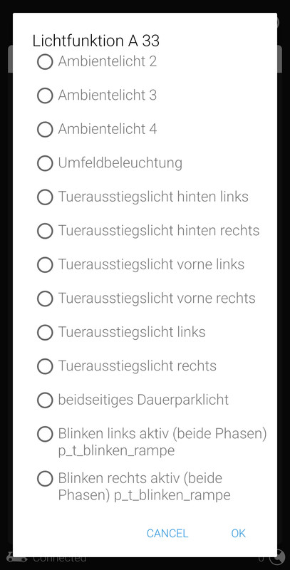

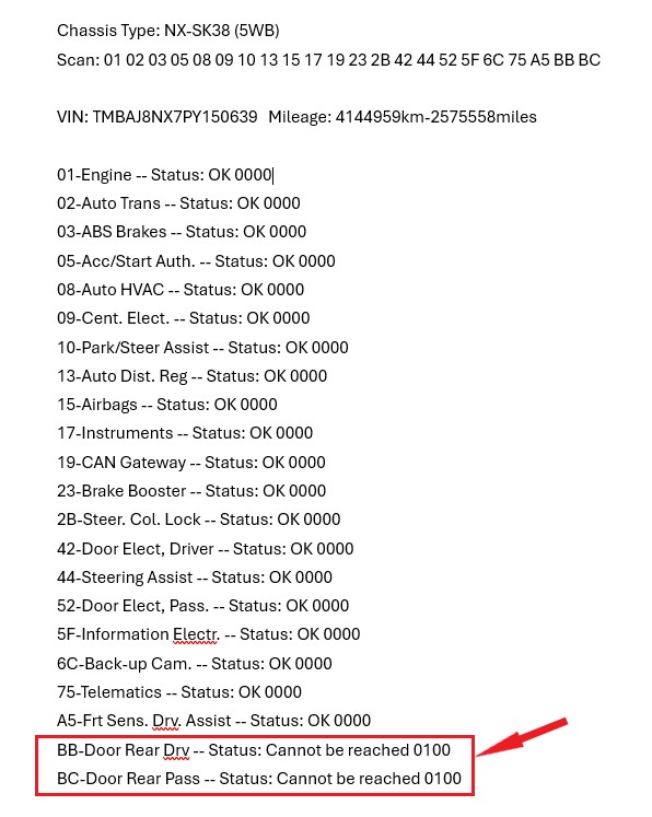

Ok, yesterday i did tests for the doors exit lights.
It works for the front doors, but unfortunately, not for the rear doors. I did all the combinations, nothing worked for the rear doors.
https://www.youtube.com/shorts/ciRCQ0gxeBc
This is a printscreen of my scan log for this car.

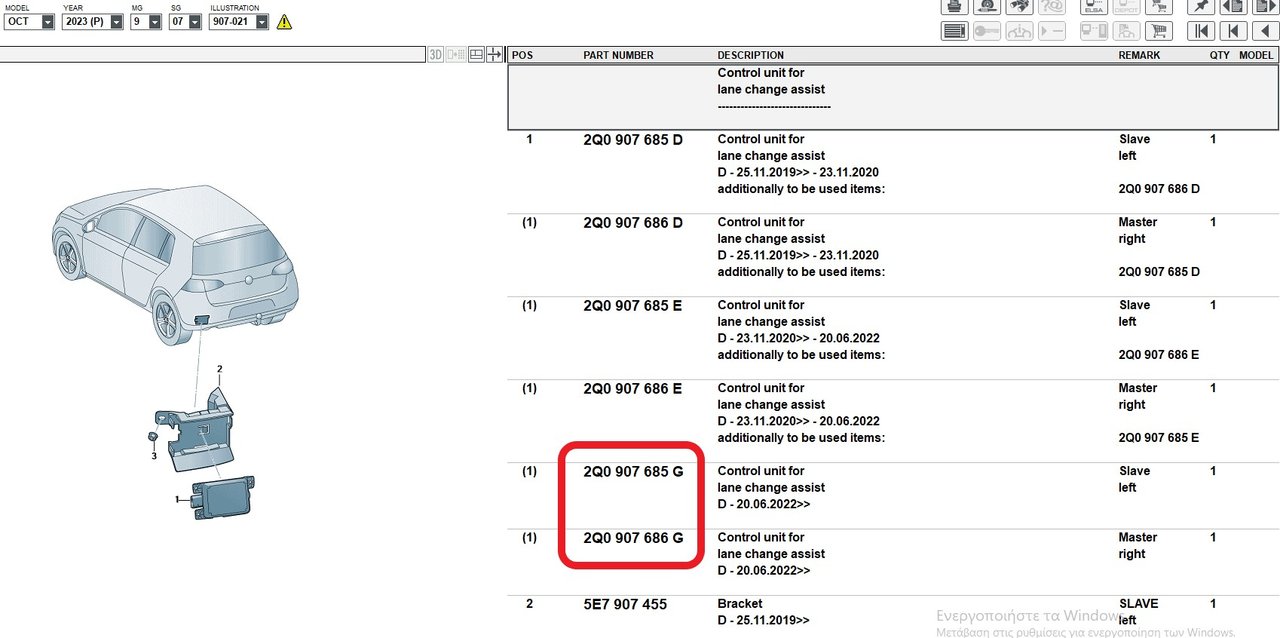

According to ETKA the control units are 2Q0907685G and 2Q0907686G

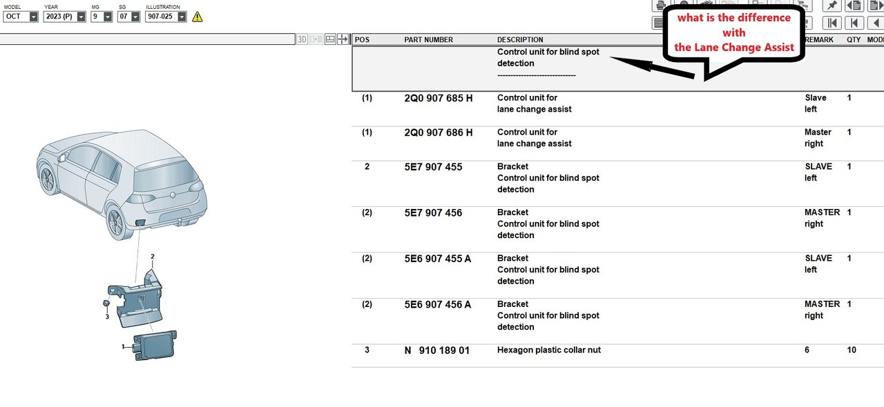

The is also another page
Is there a real difference between Lane Change Assist and Blind Spot Detection ?

Lane change assist and Blindspot monitoring both mean the same.

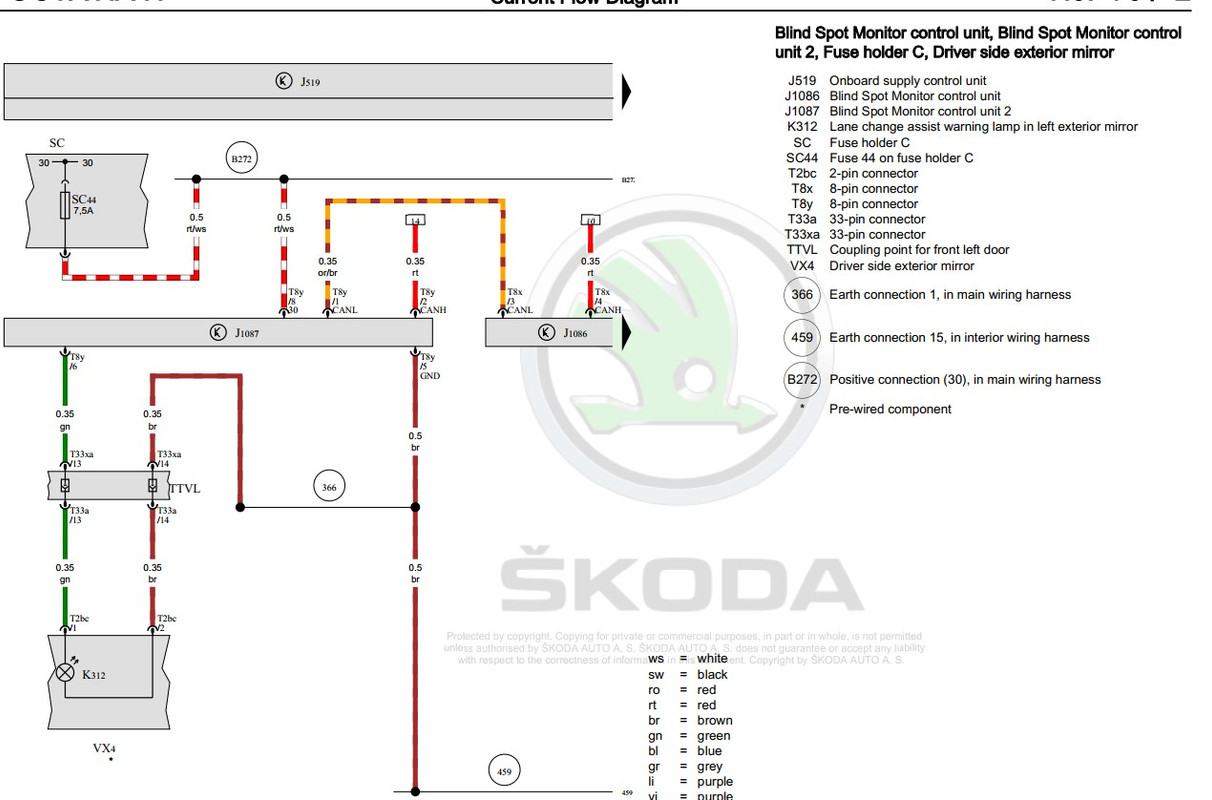

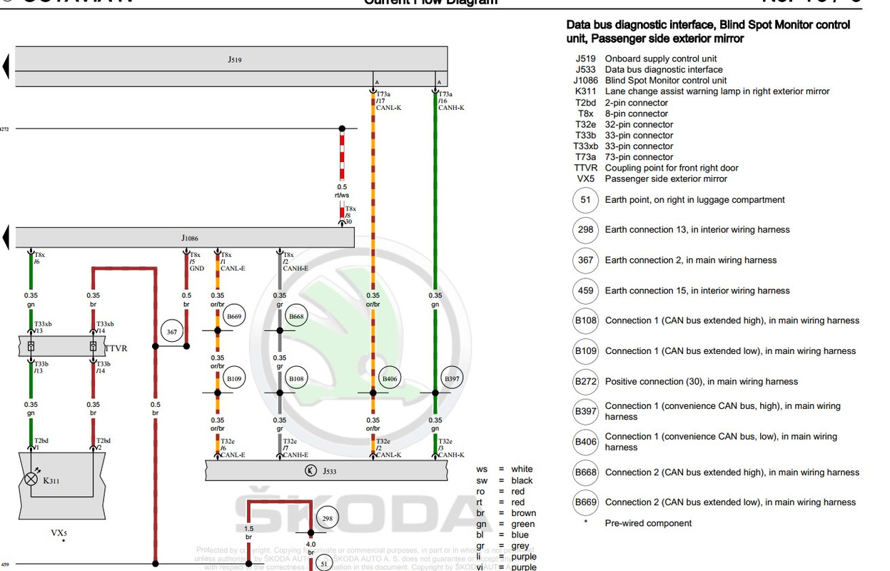

Well this is the schematic from my car.
If the images are not as clear as you want, I can send you the PDF.
As I wrote, the radars for my car should be 2Q0907686G, so should the wiring schematic. I don't know anything about the 3rd wire (Lin) you mentioned.

Thanks for showing us the diagrams.👍
According to ETKA dates, the radars indicated for your HepTavia should be 2Q0 G or H.
2Q0 H radars are the latest version used for VW, SK, SE, etc. Golf, T-Roc, Polo, Octavia, Arona, Ibiza...etc.

BSD warning lights connection by LIN (3 wires):
For now, with LIN will allow the BSD warning lights LEDs to make magic stupid patterns when they turn on/off instead of a primitive/normal but very effective on/off, sounds for blind drivers 🍻💊😁, or info from driving assistants on those giant screens on dashboards that will in no way distract you while driving.📺😁
