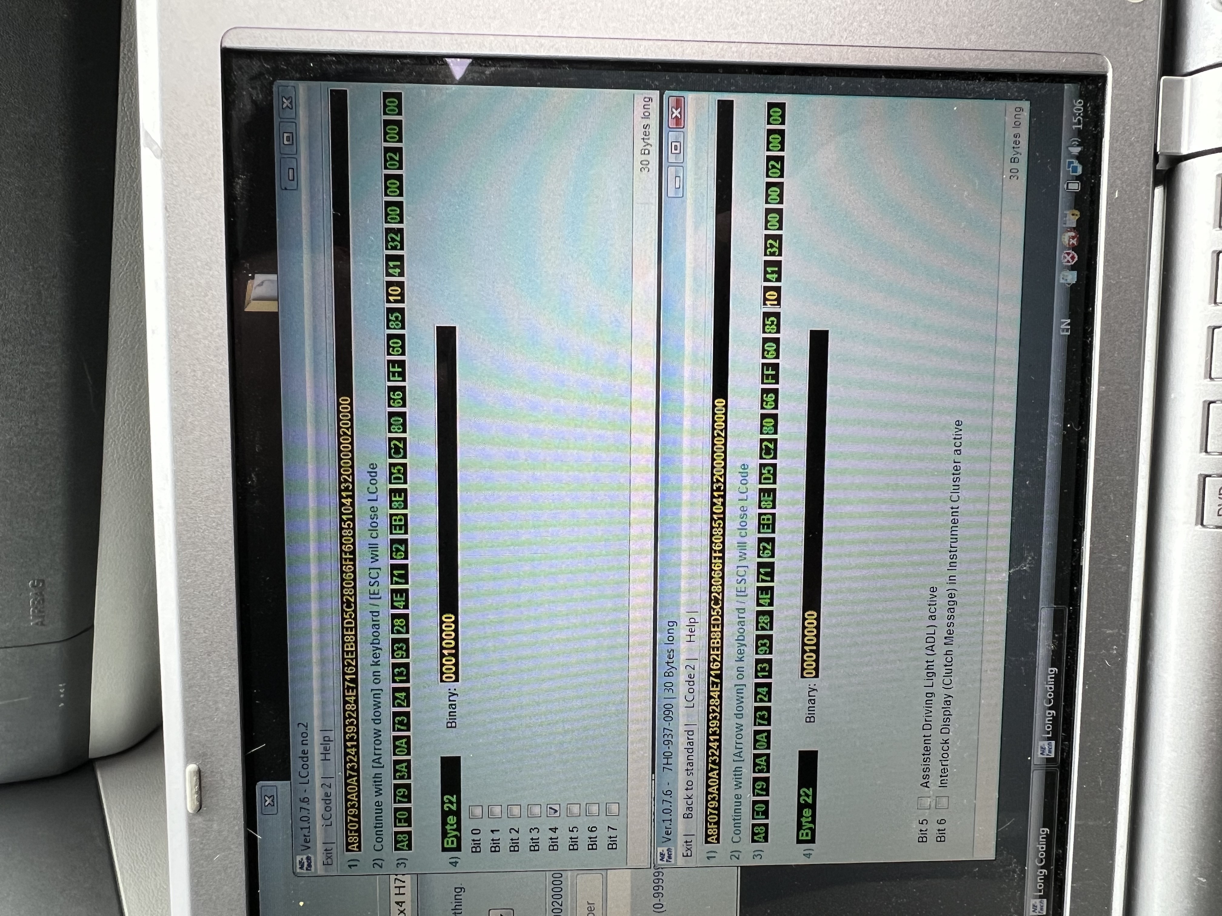

Hello everyone. I have a 2013 t5.1 and i have retrofitted bixenon led headlights vw genuine. I have done coding and it works. Only priblem i have is when i changed bit on byte 12 and 22 i accidentally unticked all figures and didn’t save them at the beginning. At the moment low beam doesn’t switch on auto mode only on manual switch and blower is on full time.

Please post the current BCM coding so I can tell you what to do.Pavlo wrote: Wed Mar 22, 2023 11:16 am Hello everyone. I have a 2013 t5.1 and i have retrofitted bixenon led headlights vw genuine. I have done coding and it works. Only priblem i have is when i changed bit on byte 12 and 22 i accidentally unticked all figures and didn’t save them at the beginning. At the moment low beam doesn’t switch on auto mode only on manual switch and blower is on full time.
Ciclo please find a picture attached. The is a Long code and Long code No2
- Posts: 8982
Ideally, post the long code as a text string (hexadecimal) and not through images, it's as easy as copying it from Autoscan and pasting here, so that I can more easily study it with my powerful tools.
Using images I would have to enter the hexadecimal values of each Byte one by one in the boxes of my tools to be able to study it, which is a tedious task and with the possibility of making a mistake when doing it.
I ask you please to post a Full Autoscan.
In the Logs folder of the Ross-tech program you have all the autoscans that you have done to your T5.1, maybe you will find everything you need there.
However, for now:
- Enable Byte22 Bit5.
- Byte12 is fine as it is, although it depends on personal taste when it comes to Bit2, it's your decision. (usually enabled)
However, for now:
