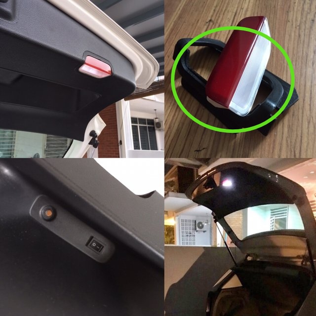

Hello, plese can you tell me part number of the boot light frame?
From which car is it?
- The light frame
- IMG_20210507_212655.jpg (104.78 KiB) Viewed 5151 times

Hi. I'm really sorry for the delay reply. Been out of the "internet world" due to some reasons. btw. It's custom made part. 3Dprint. so there's no part number and not from any car.gsrsilver wrote: Fri May 07, 2021 7:29 pm Hello, plese can you tell me part number of the boot light frame?
