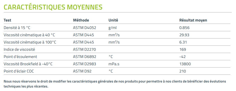

For info: Wolf Ecotech Premium 75W
Wolf is also one of the official oil supplier to VW (engine oil).
BUT ! Fuchs is API GL4 and Wolf is API GL4+.

Lower you are, better it should be.
Wolf seems to be the most appropriate but, it's API GL4+, but I found nothing about this oil standard.
