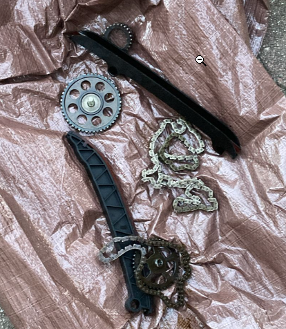

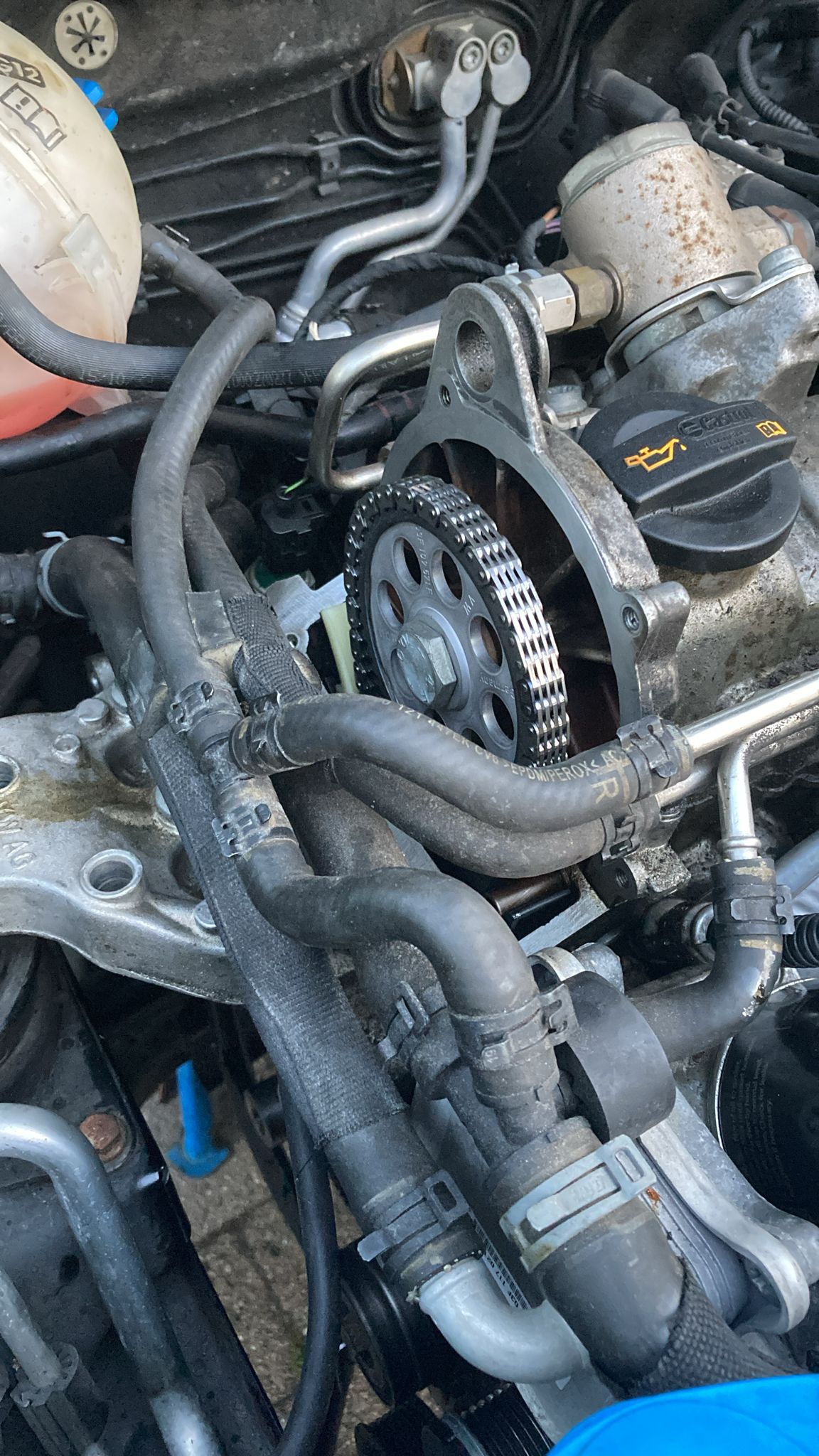

I did the repair this weekend. Installation was pretty straight forward. I downloaded the manual that goes with the SKT timing kit. Ordered the set+oil chain and sprocket from our local VW dealer. Then, after looking it over, ordered the bolt for the oil pump sprocket...
For the rest, stick to the manual and with some basic wrenching skills, and the appropriate tools (Torquewrenches 5nm to 150nm, Multilock sockets, timing kit (bolt+camshaft lock), seal installation kit (way overpriced aluminium bush and cap), a good pulley puller and a lever with pins for holding the sprockets), the installation went smoothly.
Unfortunately, while pulling the spark plugs (for easy rotation of the crackshaft), I tore a spark plug cable in half. New set is to arrive today. So it hasn't been started yet. However, the difference in play in both chains is immense.
