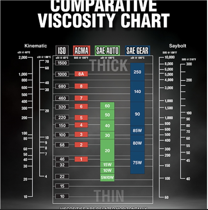

I have been following this thread with some interest, and something which seems clear is that the full VW specification for their gear oil is not available. This being the case it is hard to see how the various alternative suppliers can truly claim to have products which match the VW spec. They may be able to match some basic metrics such as SAE viscosity rating, but not aspects such as the exact kinematic viscosity or the "secret" additive package.
I have done some internet research, and to my surprise I find that individual SAE gear oil ratings cover a surprisingly span of kinematic viscosities. For example, as the chart below shows, the SAE 75W rating covers kinematic viscosities (40 degree C) ranging from around 25 cS/m2 to 50 cS/m2. This might explain why the various alternative gear oil suppliers can claim to match the VW spec when in fact they are only matching the SAE rating.
Just some food for thought
Mike

Mikeso51 wrote: Wed Dec 20, 2023 4:17 pm I have been following this thread with some interest, and something which seems clear is that the full VW specification for their gear oil is not available. This being the case it is hard to see how the various alternative suppliers can truly claim to have products which match the VW spec. They may be able to match some basic metrics such as SAE viscosity rating, but not aspects such as the exact kinematic viscosity or the "secret" additive package.
The latest specification is the one I posted recently, but it's in polish and still doesn't include everything but might be a good start point if we can figure out which bits are the additives etc.
I'm thinking of trying out the Millers oil - however whatever I put in now needs to last me another 2 years before I get rid of the car, don't want to keep changing it:/
