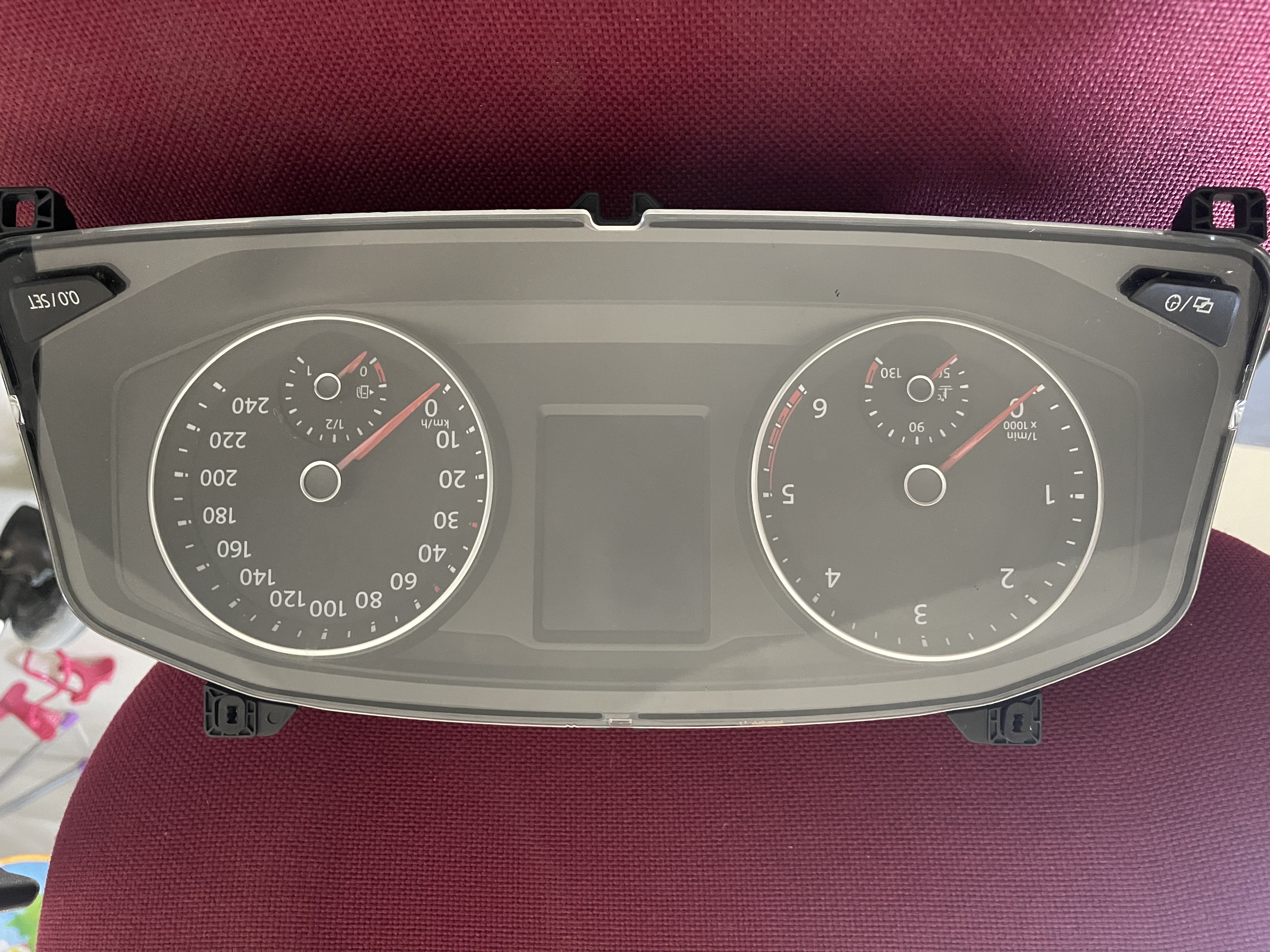

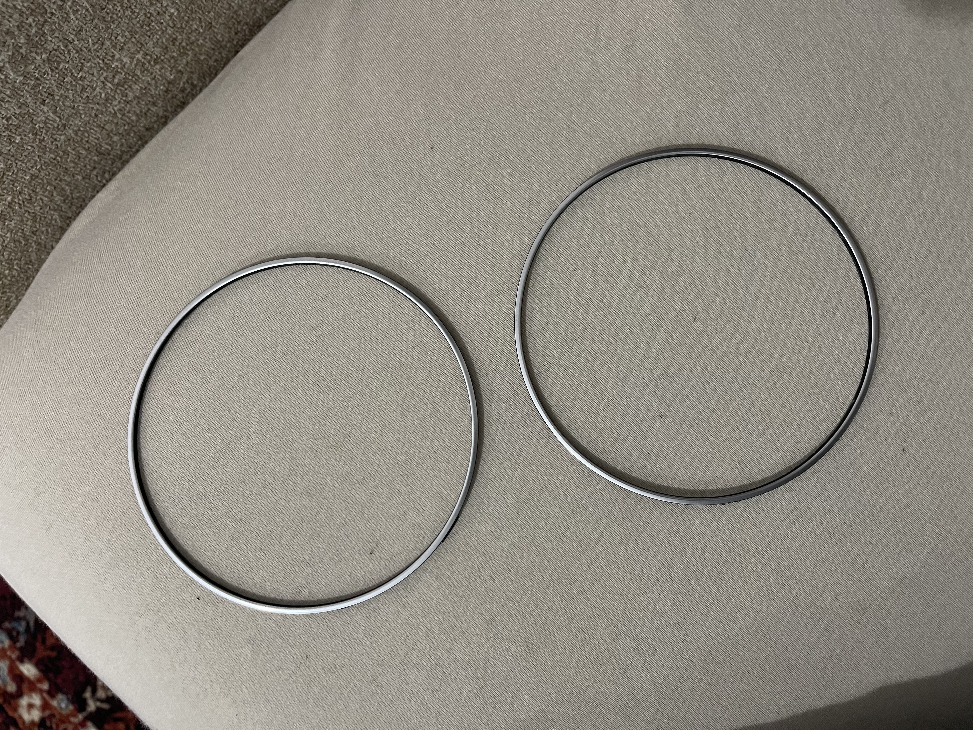

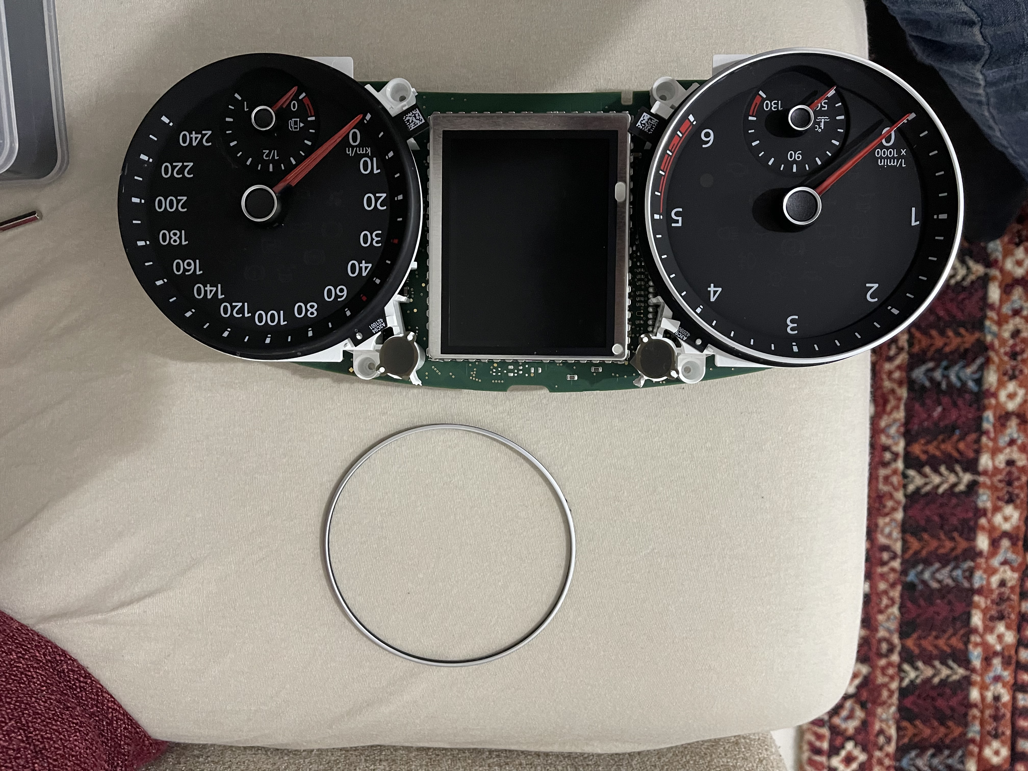

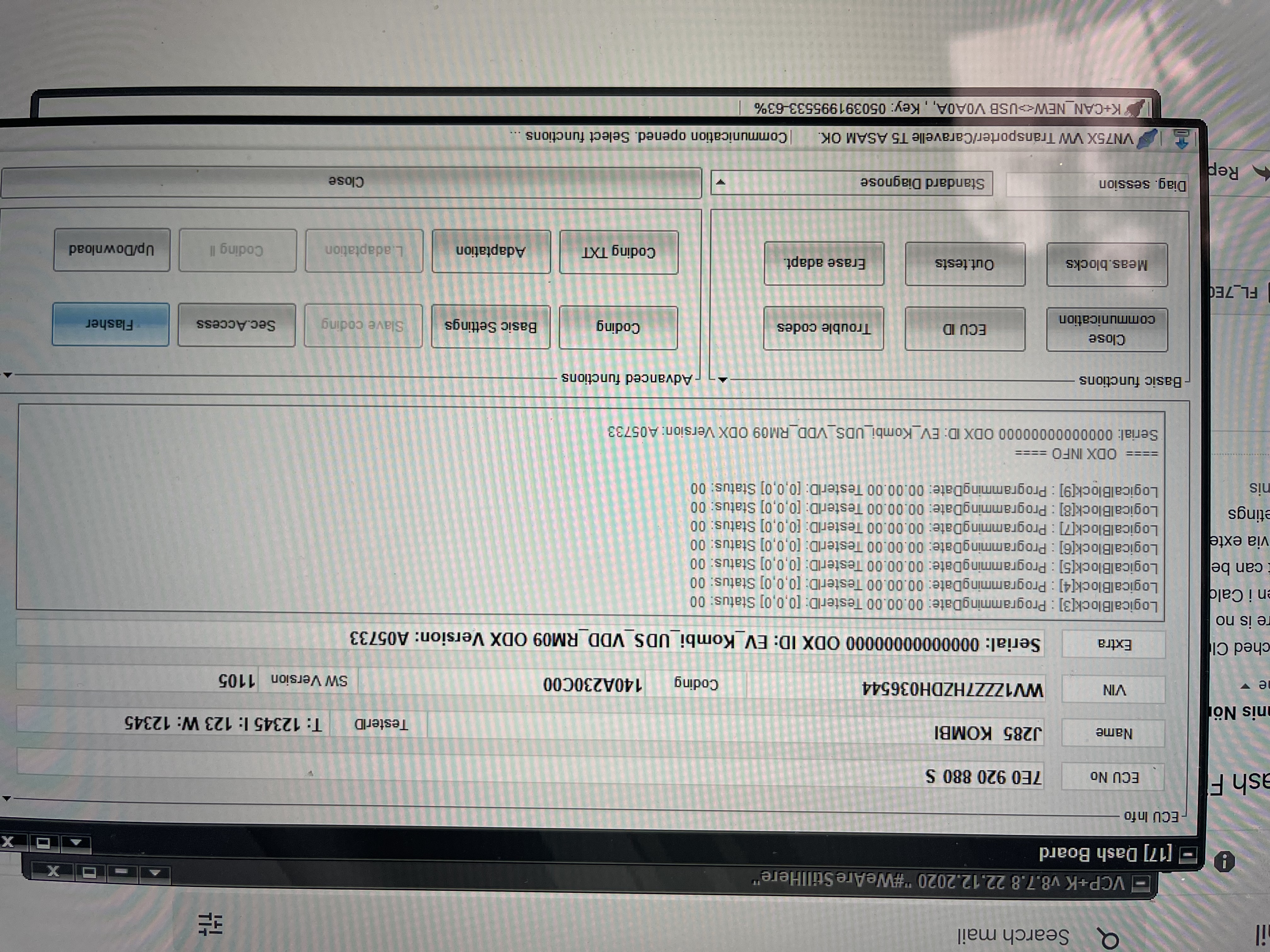

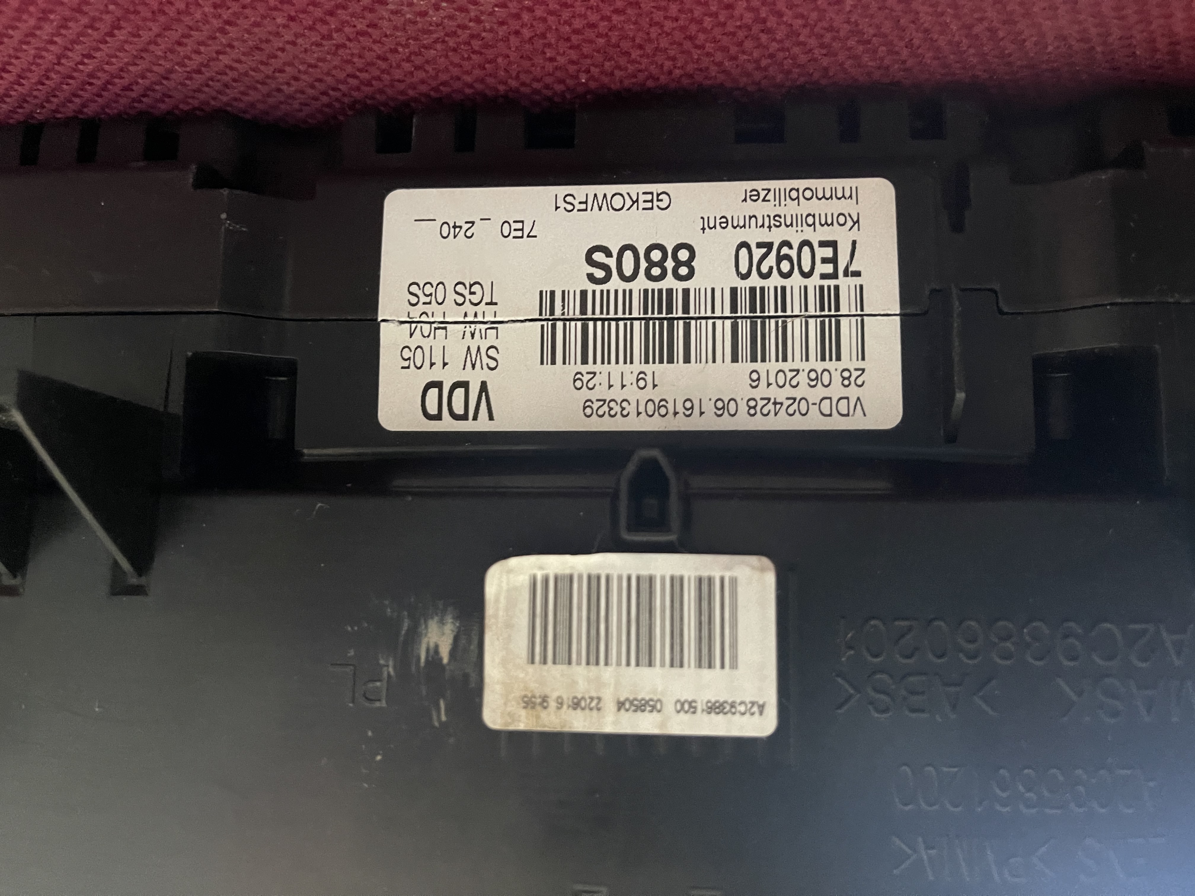

New Cluster :D
Transferring rings From the T6 housing
Updating SW :-
https://www.youtube.com/watch?v=Cn-u5m ... e=youtu.be
Posts: 8982
Re: BCM Max Transporter 2013
Shadow109 wrote: Wed Dec 01, 2021 8:08 pm New Cluster :D
8)
It looks great the T6 IC, thanks for sharing your improvements/jobs, a VW T5 with a lot of equipment.👍👌

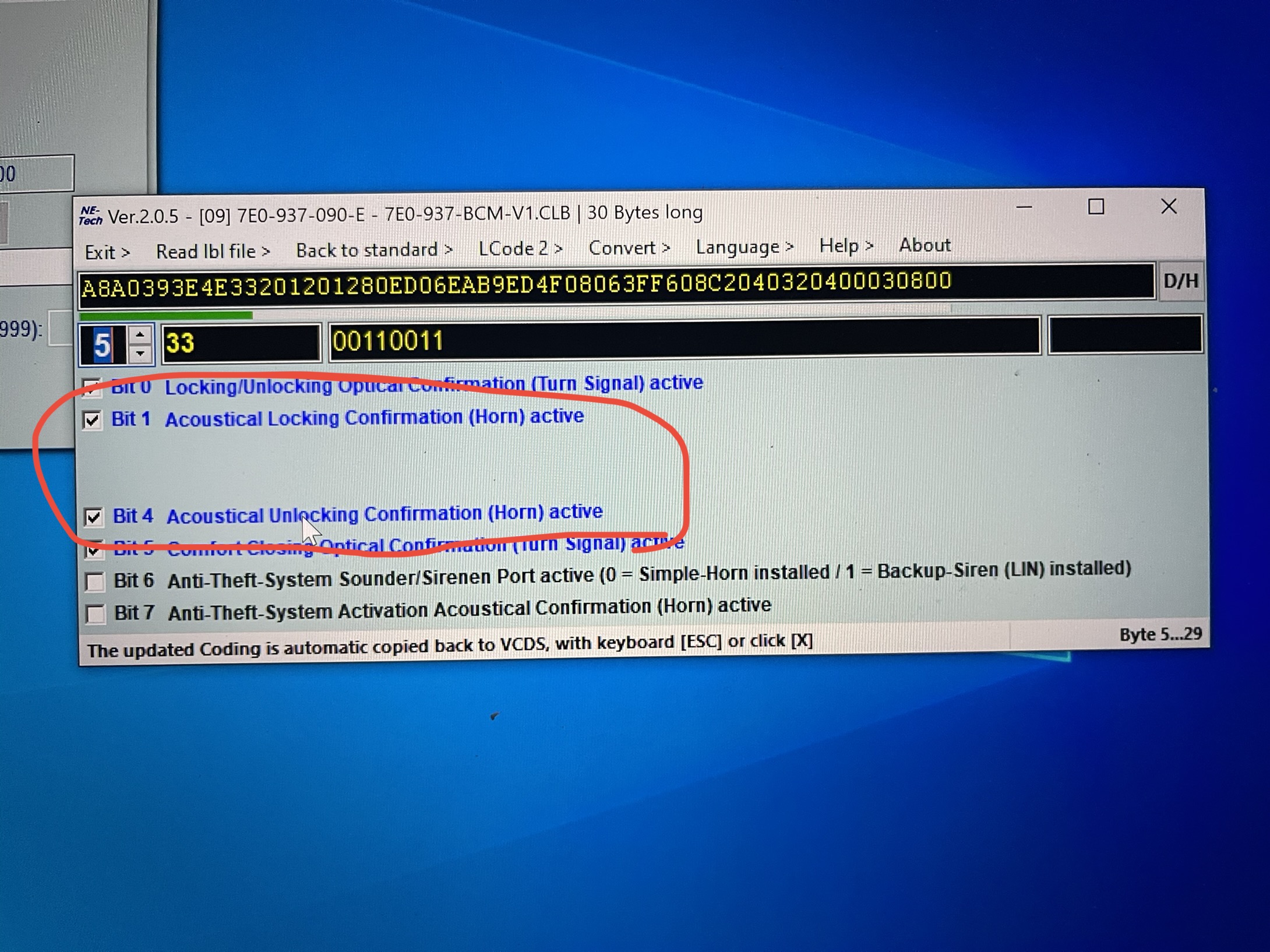

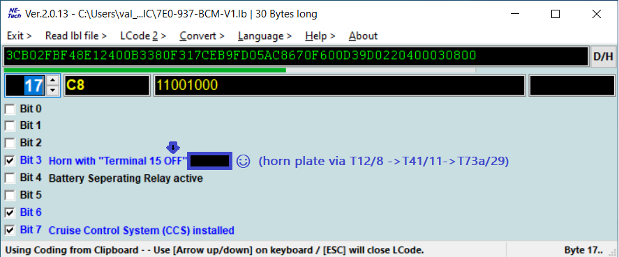

I have all wiring done before, I was hoping After activating that the horn will work locking and unlocking

I do not understand if you are asking a question ...
However,
BCM
Byte5 Bit7 ... must also be enabled ... ✅
Unfortunately for me, I don't understand anything from your second screenshot, sorry ...

I was wondering if I can activate horn confirmation when locking and unlocking the car, after searching around I think it’s possible only on MQB
Posts: 8982
In our PQ25 it is also possible (checked in my 6R), although from your comments I suppose that only for those who have an anti-theft alarm.
I'm just telling you that this is not related to the installation of the multifunction steering wheel and the ways to send the signal from the horn-plate to the BCM.
