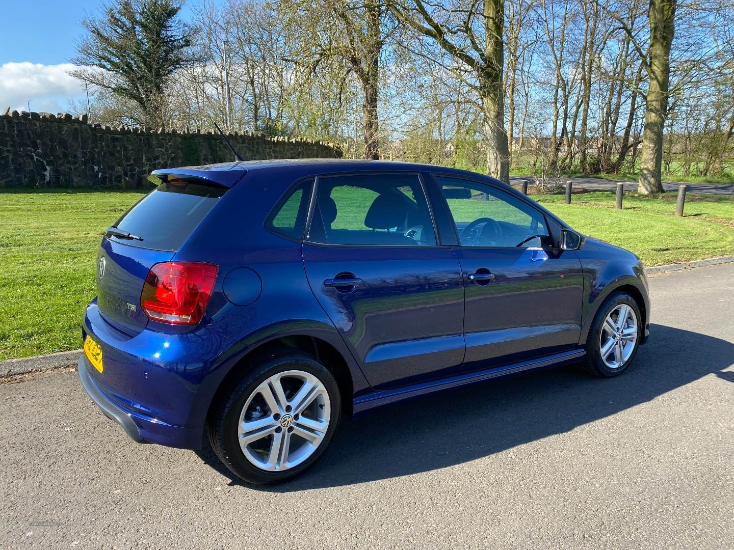

by iichel
2014 could be both 6R and 6C. Perhaps a picture of the car in question could help.
Re: How do I disable DRL
Posted: Tue Apr 13, 2021 6:17 pm
by Bobupndown
6R?
Posted: Tue Apr 13, 2021 6:22 pm
by iichel
Yes this is a 6R
