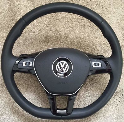

Hi guys! I'm new here; I need your help please.
I tried to mount a new multifunction steering wheel with my polo 6c year 2015 (original without) but after installation; no button is functional or lit

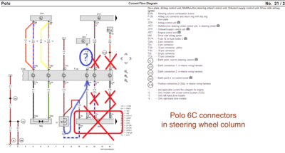

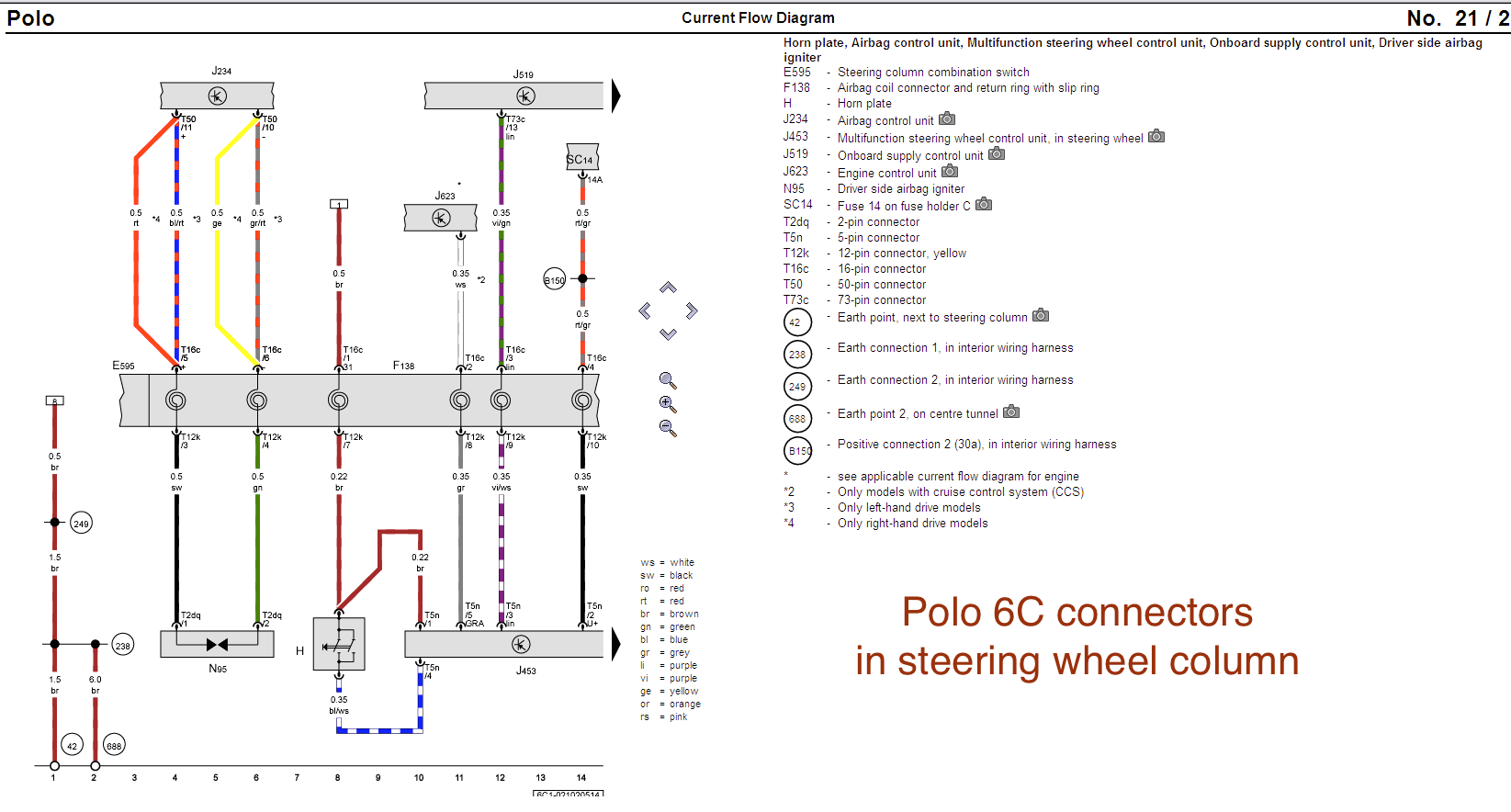

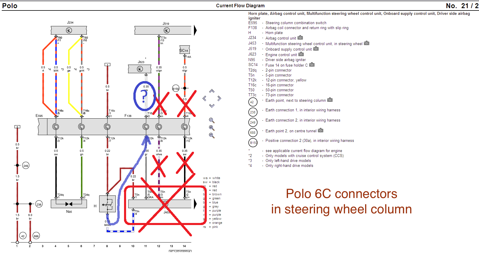

I already found a diagram here in the forum for "polo 6c connectors in steering wheel column"
the model I chose does not contain cruise control can my BCM support multifunction keys even without cruise control?

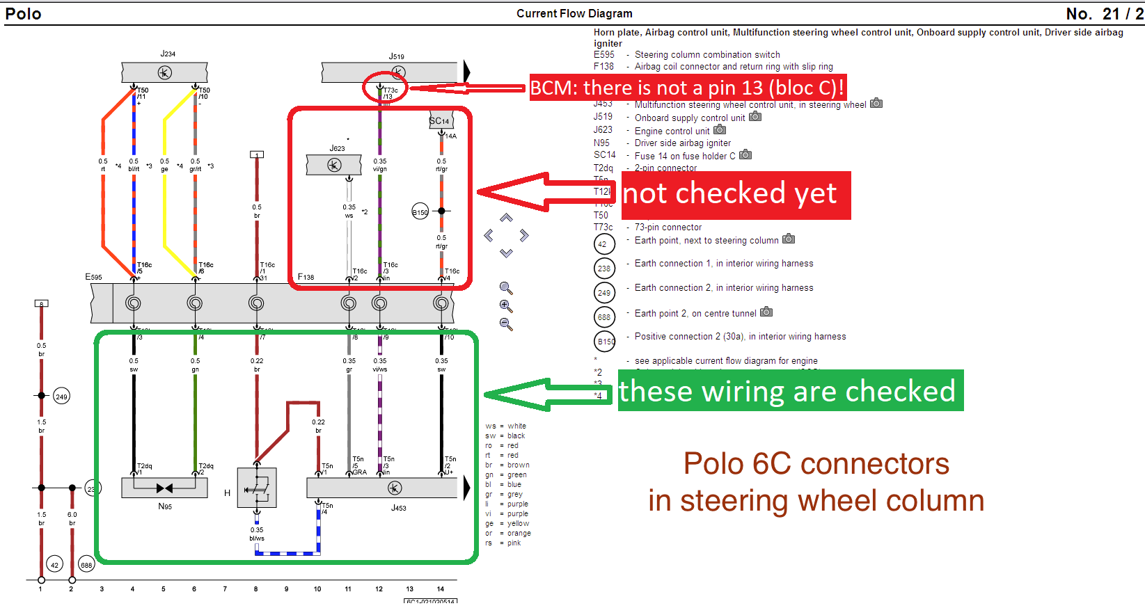

-precisely; I'm looking for what wiring I need to add to T16 connector to operate only the existing buttons. have you more of related wiring schemes?

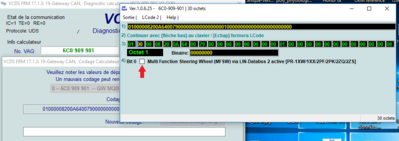

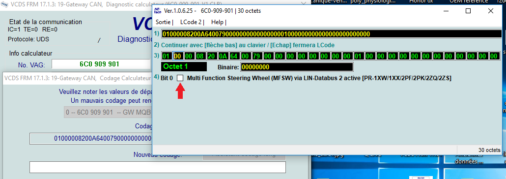

-about coding with VCDS; when I check this box in 19-Gateway CAN: scan will take several minutes looking for "slave module" without having found it.
- 09 Central Electrics module and the 17 Instruments module ; I don't know what to do!

I suppose you could start wiring running a wire from pin 3 of the 16-pin connector on the steering wheel to T73c/13 (LIN) and a power wire form pin 4 to fuse SC14 (or another permanent 12V fused slot in the fuse box)

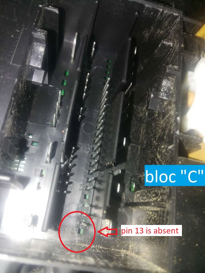

I think, als long as your BCM doesn't have the T73c/13 pin, there's hardly any chance for this mod to work.

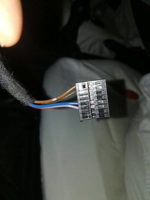

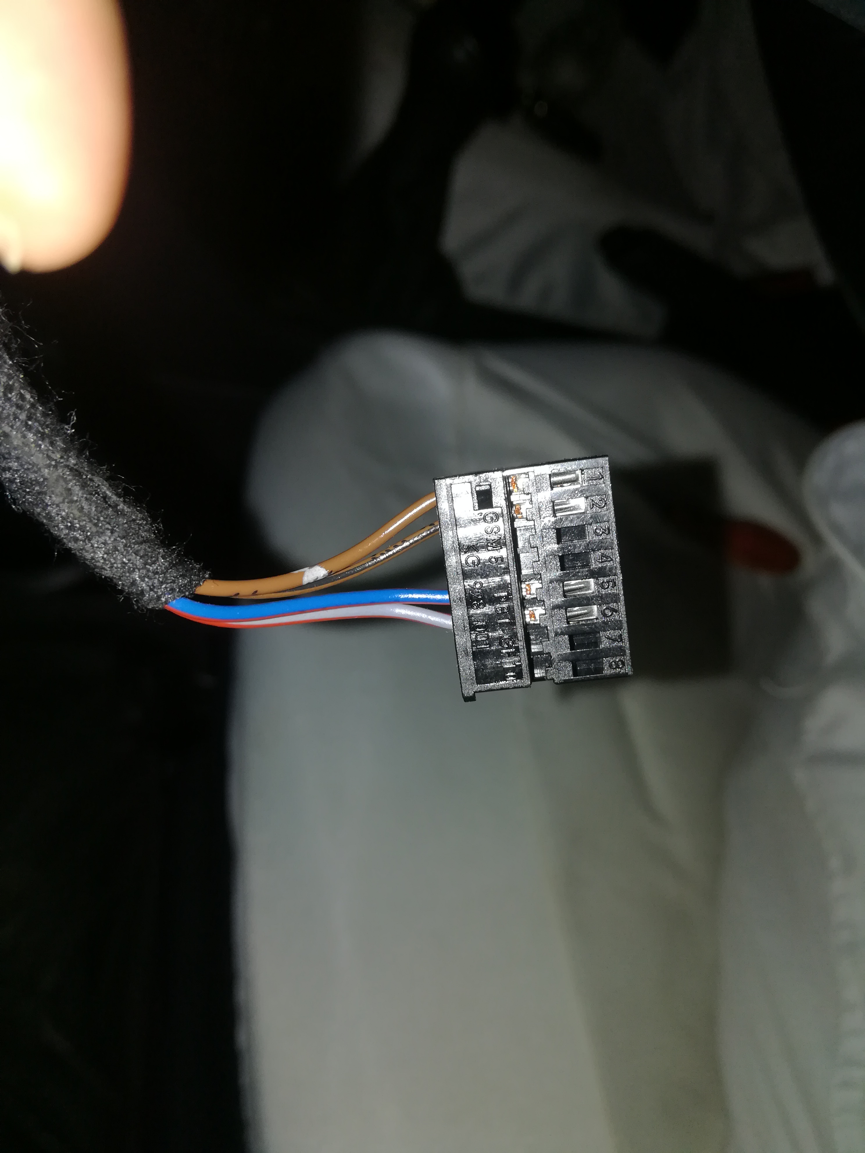

After verifying the connector of slip ring I have found four wires (photo) Pin number 02 is not white like scheme, is there another one for my car (trend) or is it a common scheme for all finishes?
Can I add juste the pin n°4 (12v)?
- Posts: 6693
Re: Retrofit "MFSW" for POLO 6C, 2015 [help]

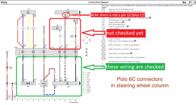

no, you need to check if pin 13 of block C is present.
if not, choose to stop the mod or replace the BCM (I don't know how to do this).
after changing BCM:
add pin 4 (12V), pin 3 (LIN to BCM) and do the coding for MFSW.
after changing BCM:

What about pin n°2 (white) / the mine is brown with black?
- Posts: 6693
it's for cruise control (GRA), but your steering wheel doesn't have it so you can ignore it.

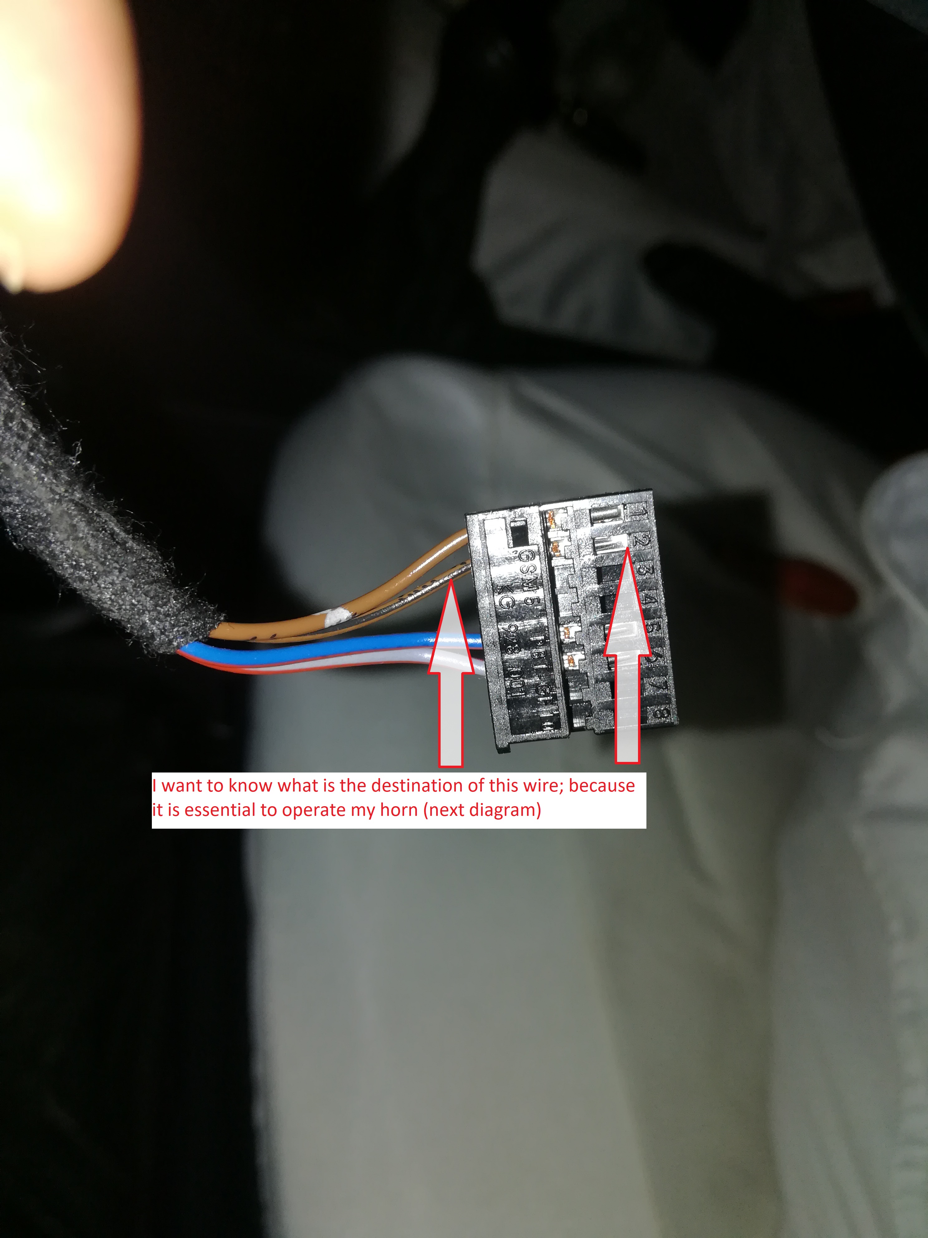

but this wire on my car is needed to operate the horn?!iichel wrote: Sat Aug 11, 2018 10:34 pm it's for cruise control (GRA), but your steering wheel doesn't have it so you can ignore it.

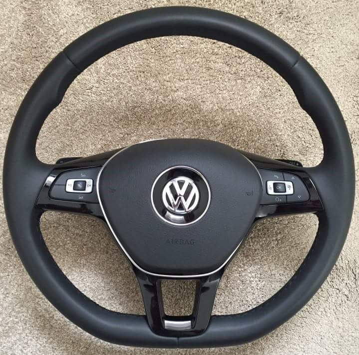

I'm doing the same retrofit now on my Polo 6C.
I have the same steering wheel as you pictured.
