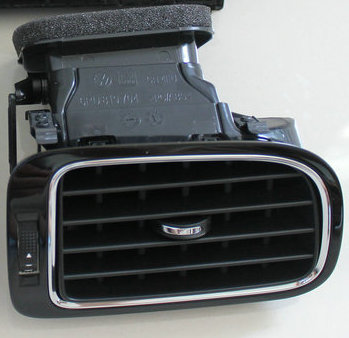

Air vents are not the same for Golf and Polo (though the mk6 Golf have a similar design to the Polo 6R 6C).
There are not many model-specific options for the Polo. I have not seen any digital ones. You can however get holders for the driver's side air vent for a 52mm gauge for the Polo:
LHD: https://www.ebay.com/itm/VW-Polo-6R-52m ... SwPK1ZQuXe
RHD: https://www.ebay.com/itm/VW-Polo-6R-UK- ... Sw-ldZX9rR
I bought one of those holders for mine, together with a NewSouth Performance boost gauge. However pulling a boost line through the firewall on the 6R is a pain, at least on the LHD (unless you feel comfortable with drilling a new hole through the firewall). That's why I still haven't managed to install it.

Keep in mind though that the holders I linked aren't perfect. You'll probably want to do some finishing work yourself (I did sandpaper mine to smooth it out in some spots), and in order to make it match the factory vents you will have to spray paint it semi-matt black. Also the profile of the grate is flat, not slightly convex like the frame around the vent (not a big issue really). Also the circular part holding the gauge is angled so that you will probably keep the vent angled in the lowest possible position in order for the gauge to be aligned with your face. It does its job, but aesthetically it is far from a perfect design.
If using a mechanical boost gauge with a boost line running all the way to the gauge, you may have to drill/cut a hole in the duct behind the gauge in order to feed the boost line through.
