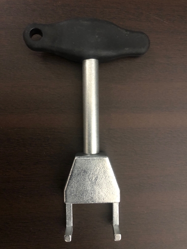

I want to remove my spark plugs to do a visual inspection and see if they need replacement. I don't have the service history of my car so I'm afraid my plugs are due for replacement. Pulling them with my bare hands don't work so I bought an ignition coil puller (T10094A).

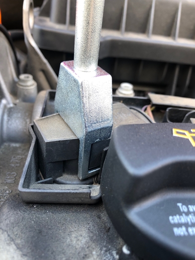

I thought I could easily get them out but they are still very difficult to remove. I tried hammering up the puller handle but I stopped because it doesn't seem to be a good idea. I tried twisting left and right. It moves a little from side to side but not upwards. I can't pry it up with a flat screwdriver because of the plastic wiring guide around the ignition coils.
I'm thinking of devising a screw type puller that can sit on the camshaft housing. If anyone has any tips on removing an ignition coil, please let me know. Thank you.

That puller should give you your best chance of pulling these coils up, I had removed all the coils on my wife's old Polo 1.4 16V before I bought a coil puller kit, and the method I used was to lever them up using 2 suitable screwdrivers, taking care not to damage the plastic cable management part. Only ever lever in close to the centre line of the spark plug to avoid snapping them off.
I'd think that if you try using 2 screwdrivers - one opposite the other to avoid damaging the coil, then applying steady pressure, these coils will come up enough for you to fit the puller back on and lift them out.

Thank you for tip. I tried it but the screwdrivers have nothing to pry against except the plastic wiring guide.
I will make something that can sit on the camshaft housing and attach the coil puller. Will share it here later.

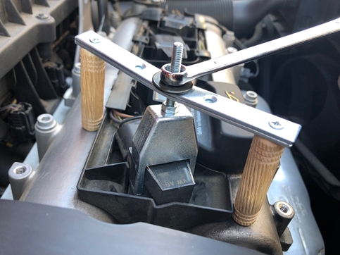

I have finally removed the ignition coils by making this little hoist using metal bars and wood.
It sits on the camshaft housing and pulls the puller up as you tighten the nut. Works well.

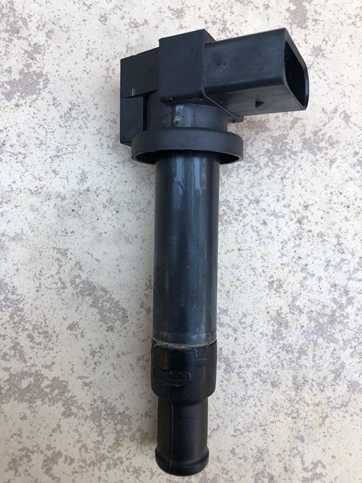

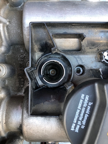

Ignition coils 2, 3 and 4 came out without issues but I had an issue with coil 1.
The metal part of the coil did not come out. It got stuck in the hole so the coil came out without it.
- coil metal stuck in hole
- coil without metal
Coil 1 still works when I reinserted it but my plan is to replace it after I receive the replacement coil I ordered. I will forcefully pull out that metal part with pliers.

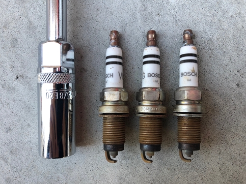

I could only get 3 spark plugs. The spark plug wrench won't fit when the metal thing is there. Plugs are rusty so I think they have never been replaced since the car was bought in 2008.
I will replace all the spark plugs.
- rusty spark plugs

Oh, that is a bit annoying, it must be the sealing ribs of the rubber gasket that is gripping the sides of the counterbore in the aluminium alloy cylinder head - and the metal shield will just be gripping the inner bore of that rubber gasket.
I'd not think that that happens very often, in fact I've never ever read about that happening on any VW Group similar engines - replacing the plugs at the 4 or 6 year point in its life would probably have avoided that, also to make things worse, any engine oil spilt during servicing/maintaining would end up on top of that rubber gasket adding to its troubles.

I agree with you that it was the rubber gasket. The metal shield from the coil and metal from the spark plug well shouldn't be gripping that tight.
I never realized that spilt oil could make it difficult for the coils to come out but yes, it looks like some oil was spilt when refilling at one point. I'll have to clean that up.

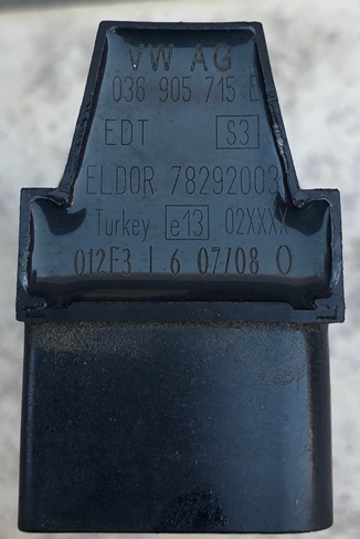

Here's a photo of the Eldor coil taken from my 9N3.
- Eldor ignition coil
