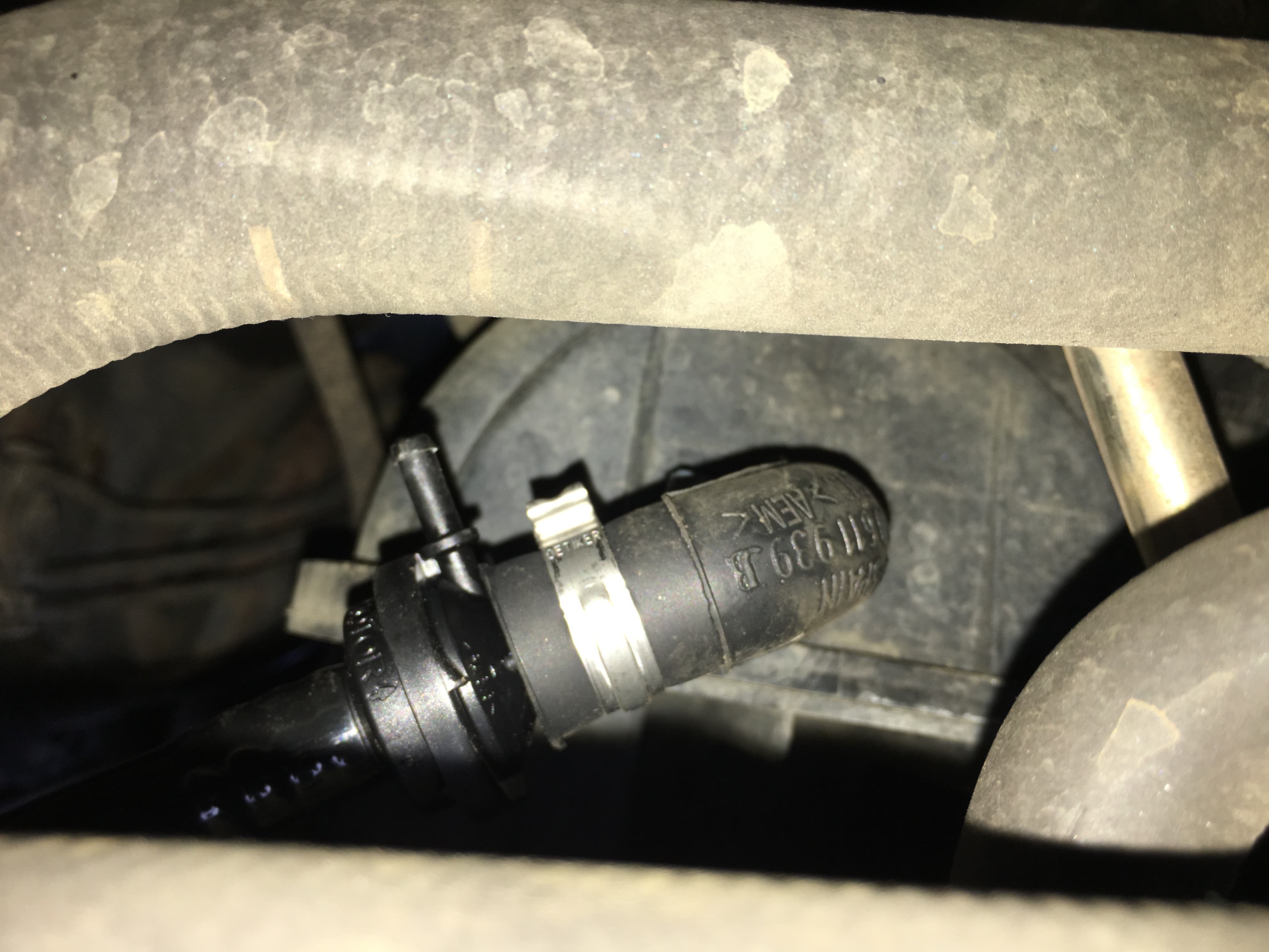

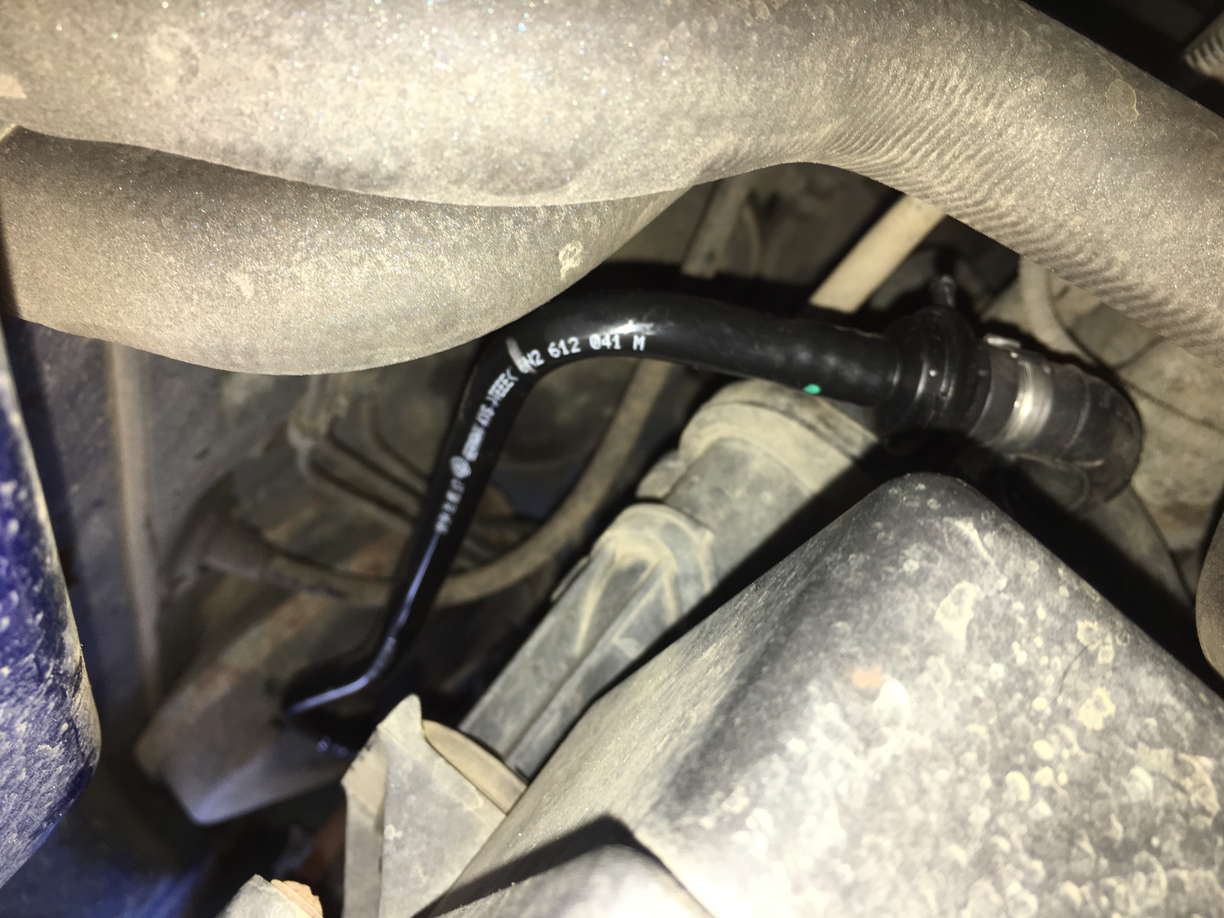

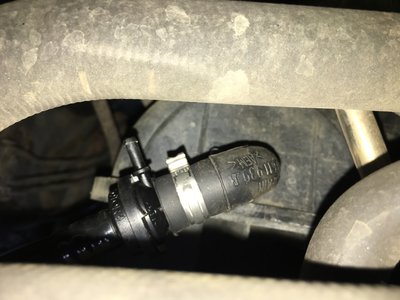

I should add as well that after I replaced the ignition coil and new cam sensor, the revs would spike from 600-900 every 30 seconds or so. Thought that was odd, maybe just calibrating now there’s no vacuum leak? There’s a tiny tube coming off the new vacuum hose which is sucking in air. Should that have a bung on it? Covered it with my finger and engine revs dropped substantially

That vacuum hose should be connected to something - have you got a pic?

Ok here’s a couple pics, including close up of that little valve thing. Made a bit of progress, cleared the codes and light is now gone. Still had c0300 and the code for cam sensor came back, showing p0343. Looked this up and it gave me this:

That should have a bung on it. Should’ve been one on the old hose

Ah ok, looks like I’ll have to find something to go on there then. Thought the brake pedal didn’t seem to feel any better
