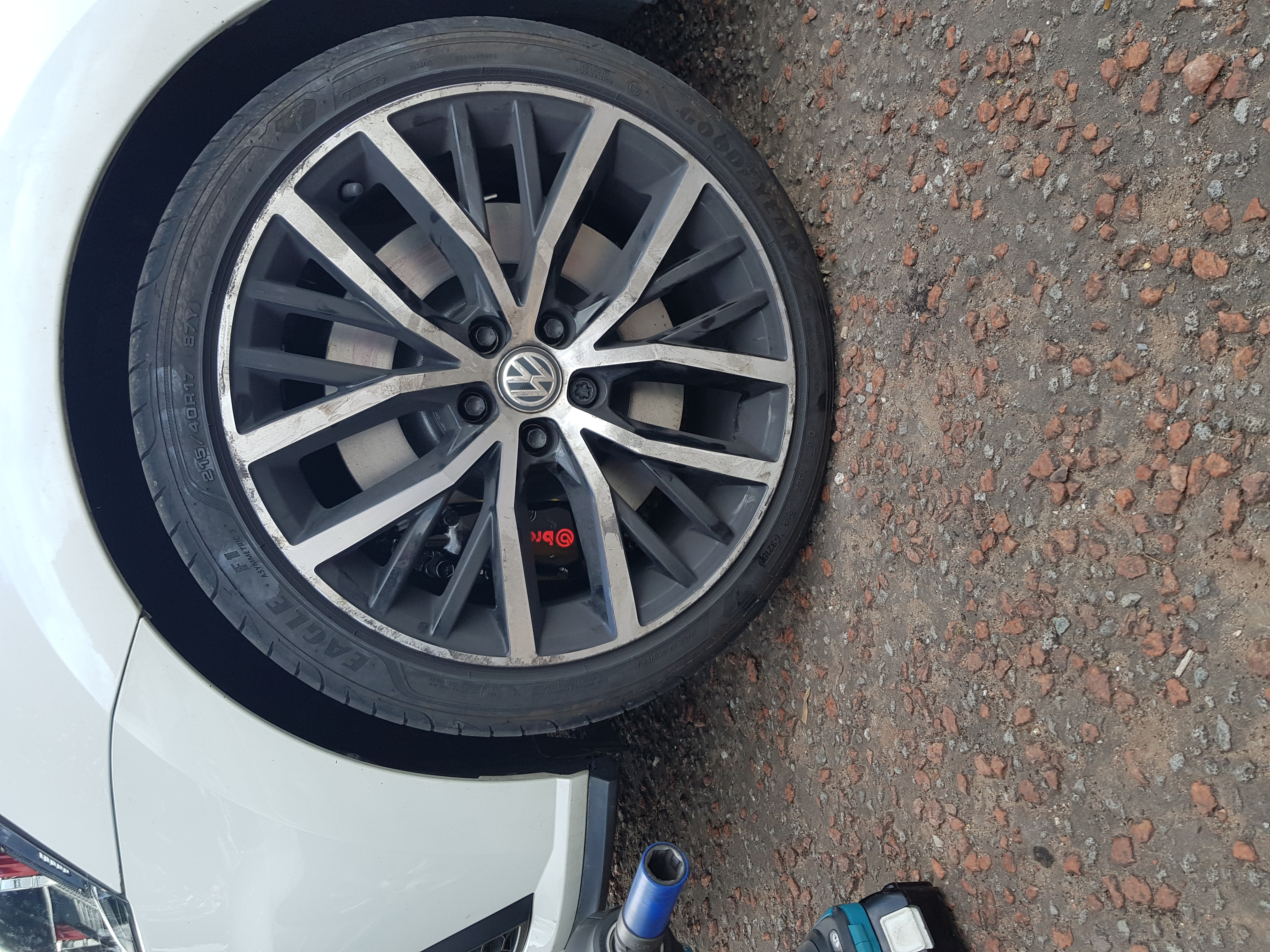

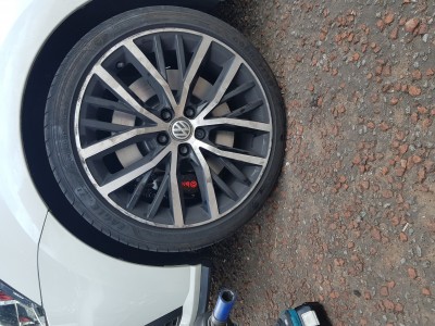

Are these the same as the mk1 leon cupra R brakes?
If so then yeah I've fitted some on to my 6c gti.

quite a simple upgrade. just need to find a mk1 seat leon cupra R that's being scrapped for parts.
then i had them all refurbished (front and rear) in black and they just bolt on.
the only extra i needed was brake lines on the front to convert from the polo to brembos
i used ebc yellow stuff pads all round and just plain discs
