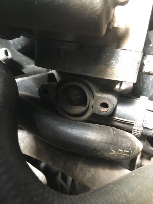

I have recently completed a project to bring a much neglected 2006 1.4 16v Polo 3 door SE back to its former glory. So much that the wife and I have just completed over 1100 miles over 10 days in a UK road trip. Car ran like a dream, never missed a beat! Upon return I noticed that the oil level had dropped considerably. Following much research on this excellent forum and others it would appear to be a common issue with these BKY tappy engines. Upon looking for the Oil Breather Separator I noticed that there appeared to be a component/ hose missing in close proximity to where I plan to remove the part and associated hoses for closer inspection

I should not be posting without knowing all the facts, but, I just wonder if that point in that plastic assembly if only there for some other models, and that it is not being used on that car, ie the "hole" looks like it is closed, so if used that hole would get cut open then some thing bolted on to it - just a thought, that is all.
Using too much oil with these engines tended to be caused by a failing oil separator - I replaced that on a 2002 Polo and it cut back its oil consumption dramatically.

Thanks for your reply. I had considered that option but just wanted confirmation really. That was the corner of the car that took the most damage so my thoughts were around losing a fitting and hose and I wasn't aware. I have a work colleague with a similar model Polo so can confirm your point by having a look over that.
Planning to check out the oil breather in the next few days.
