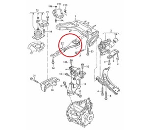

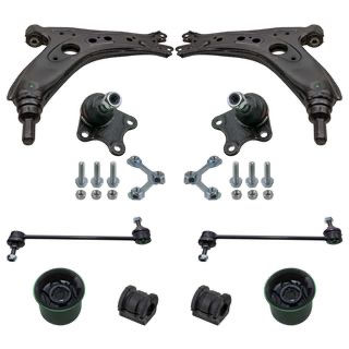

Re: POLO GTI 2006 Lower Arm Bushings
You say you were recommended to replace the front lower arm bushes, buy this I expect they meant’ console ’ bushes.
You have listed rear axle bushes in your post? Why ?
This is typically what I would expect to find under a 9n3 polo at the front
- 0C4E158F-8FA4-4870-8AB8-41DDDF3C9F39.jpeg (26.08 KiB) Viewed 2119 times
- 290595F6-2572-4F59-A0A0-04DC085A9CB7.jpeg (20.13 KiB) Viewed 2119 times
