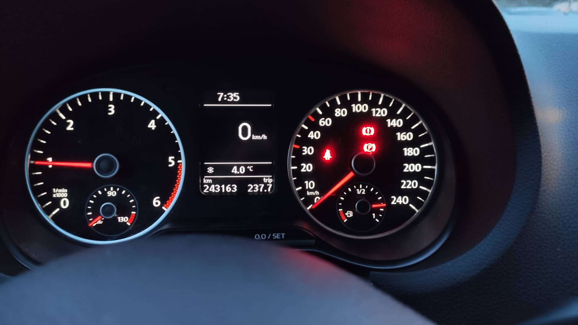

I have VW Polo 6r 1.6TDI 2009 years. I bought VW Amarok cluster (2H0920871A). but the problem is with speed, shows bad speeds and VAGCOM ABS block 1 fault Tire Diameter implausible.
IMMO - DONE
ICON - DONE
FUEL GAUGE - DONE
BRAKE FLUID - DONE
SPEED - not done
maybe someone could help ?
Thanks!

everything is done in eeprom. rows are copied from old and placed in amarok
looks like the size of the tires copied, but still it shows poorly

have you returned the correct wheel circumference? on the amarok it is different from the polo
Re: Amarok Cluster
I did
