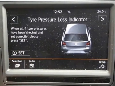

I upgraded to full discovery media screen, it now has this option but it just says starting and doesn’t seem to be able to load tire information.
Example image of screen I now have
Car has tire reset button in glove box which I think means it’s indirect monitoring?
Anyone got any info guidance if it’s possible to get working?
Cheers Rob

It looks like it's working fine right now, isn't it?

I'm guessing what the OP is meaning is yes it looks okay, but he can not get "set" to work using the touch screen - and also has the physical "set" button in the glove box (which should work okay but he would rather be able to use the "set" in the touch screen.

No my one just in blue text says starting but does not get to the example picture shown of what it should look like?

Ouch, even worse than I assumed - help/guidance definitely required!

FeC not enabled/allowed is my guess.
I had the same with a lot of functions when i got CP removed when i changed my unit in my polo.

Which module is the activation in for switching media screen info on?
