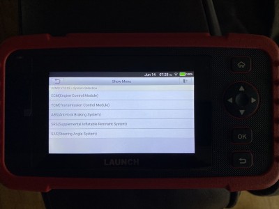

I believe so its the LAUNCH CRP129X code reader, it didn't come up with any ABS fault and that was the warning light that came up
Re: ESP light
Posted: Sun Jun 14, 2020 5:54 pm
by RUM4MO
Or it can not read the ABS controller?
Edit:- the reason that I said that was because so far it looks like it has only checked the engine controller, which is what most basic code reader will do.
Re: ESP light
Posted: Sun Jun 14, 2020 7:33 pm
by dafty123
The code reader screen
download/file.php?mode=view&id=4959
I am sure it will read ABS.
