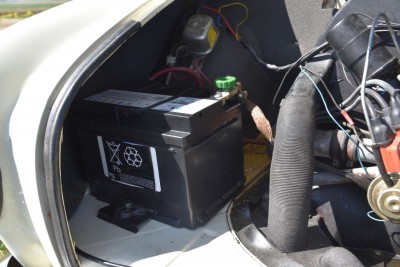

Thank you Fernando. The car is over 50 years old and it shows. Have a look at the engine bay, all the way on the left. There is one of these:
I think there is plenty of room for improvement but mostly enjoyment.
There is no high-tech electronics on this car. There shouldn't be. So this is OK.
