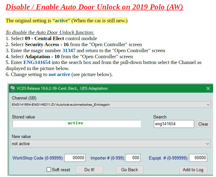

Hello Simonz,
You can disable the "Auto Door Lock at Speed" using VCDS:
1. Select "09 - Central Elect" control module
2. Select "Security Access - 16" from the "Open Controller" screen
3. Enter the magic number 31347 and return to the "Open Controller" screen
4. Select "Adaptation - 10" from the "Open Controller" screen
5. Go to this Channel: "ENG141654-ENG149210-ZV Autolock-Automatisches_Verriegeln_bei_Geschwindigkeit"
6. Change setting to "not active".
This works on my MY20 Polo 1.6 Conceptline.

On the other hand, if you want to disable "Auto Door Unlock when Remove Key", follow the instruction below using VCDS:

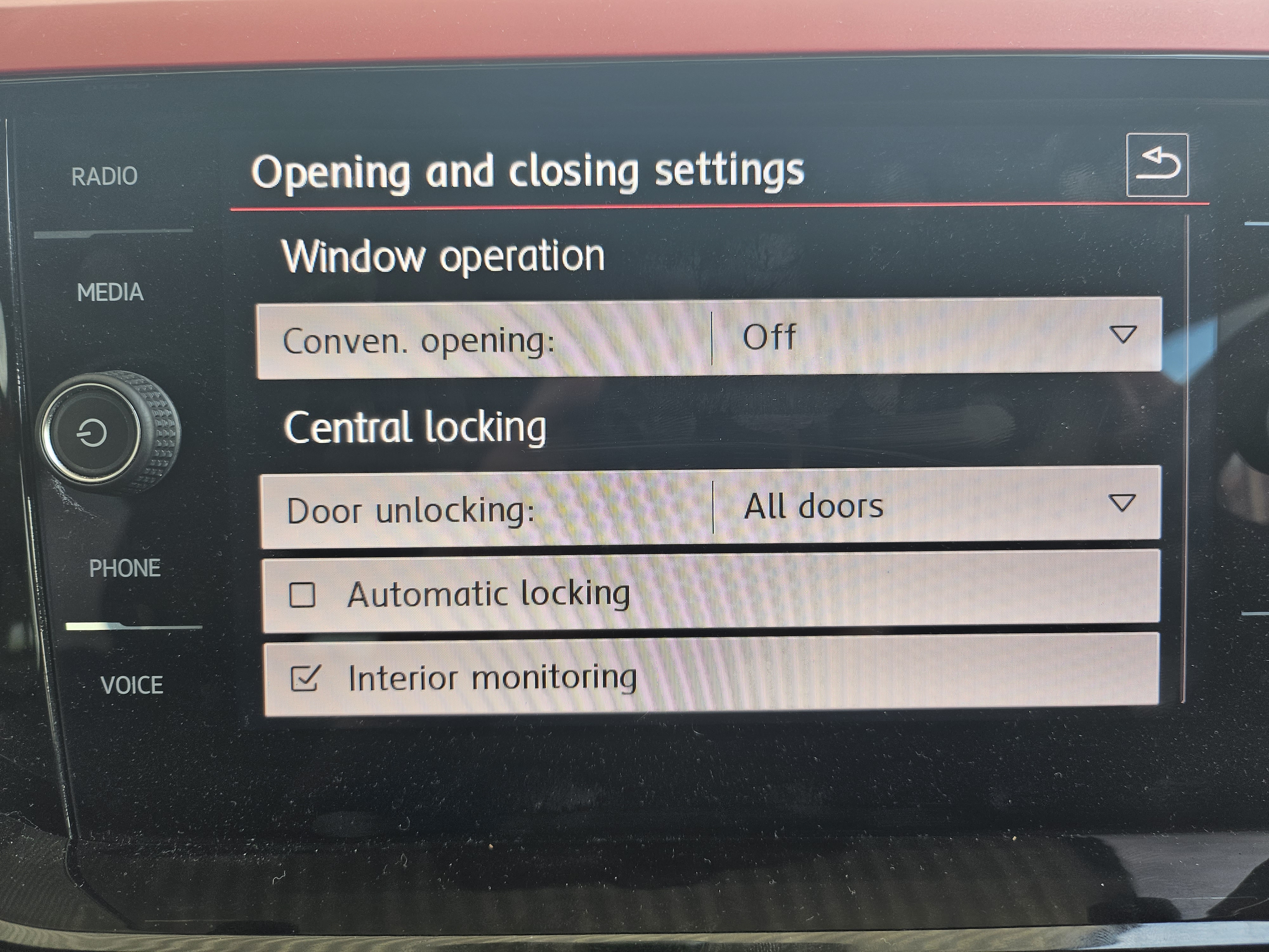

I can adjust this in the radio menu in my car, it's under locking and opening

Probably only the MIB3 models then?
Not sure, both my Polo and my T-Cross (2021) have this option.

Found the solution!
Changed
ENG141654-ENG149214-ZV Autolock-Menuesteuerung ZV Autolock-Unlock
I can't remember what the option was called, something like optional or similar. It's obvious anyway.
That puts the item in the menu, where it should have been in the first place, IMO.
This is on a 2020 GTI+ keyless. I love VCDS!
