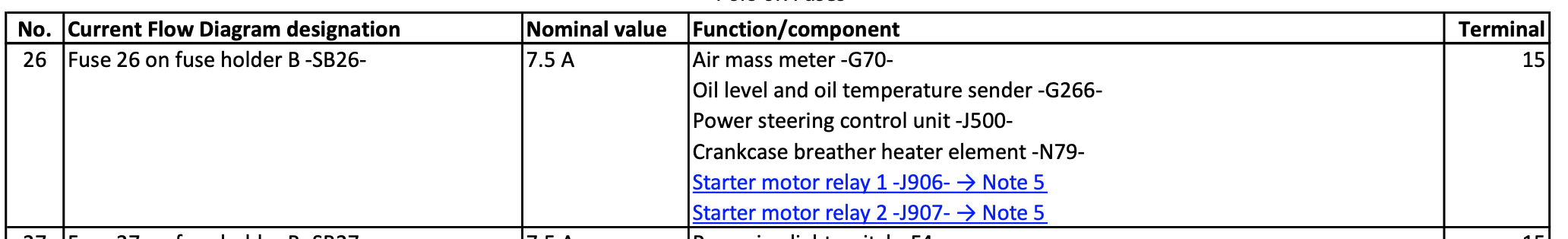

So this are the relays powered by fuse 26.
Screenshot 2020-11-10 at 11.03.47.png (87.13 KiB) Viewed 3423 times
The starter relays are placed in the bottom row of the relay carrier, second and third one from the left.

That is quite helpful iichel,thank you, I will pull them tonight and see what I can diagnose, I have some spare relays kicking about somewhere so I might get lucky.

I removed both starter relays 1 at a time and put a new fuse in, turned the car on and the fuse still went, it can't be them, although the small of the 2 fuses had something rattling about inside...can't be good.
Re: Fuse 26 Blowing, Need help!
Posted: Tue Nov 10, 2020 4:16 pm
by iichel
So... now you remove all other devices in that list to see what's going on.
Air mass meter is the easiest, that's located right next to the air filter. Next the power steering unit which is a lot harder to reach and next up are the other two (even though I think your TDI doesn't have the crankcase heater element)
